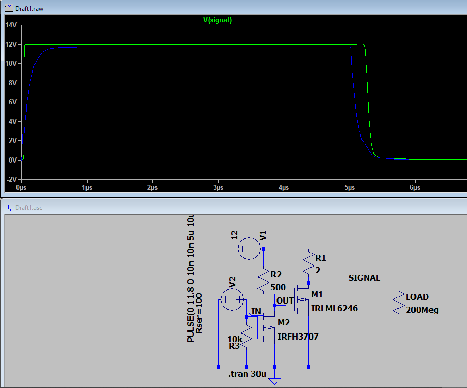

Hi sir, I attached my schematic below. Am i connecting it properly? In this case, I am using V2 lower than V1 because when I tested V2 greater than V1, the transistors becomes hot. :)Inked271828047_1221179888414519_6140697363846638897_n_LI.jpg
DC_Kid
Joined Feb 25, 2008
1,242
What's the goal of the ckt? What's the source (device, or output stage type) for PWM?
Why use bi-polar as driver, just stick a nFet in front of the power nFet. Makes the whole ckt just three parts.
The other Q I have is, does the power fet on/off need to follow PWM on/off times closely, or is some delay ok? There will always be delay, question is, how much is too much, or perhaps it doesn't matter?

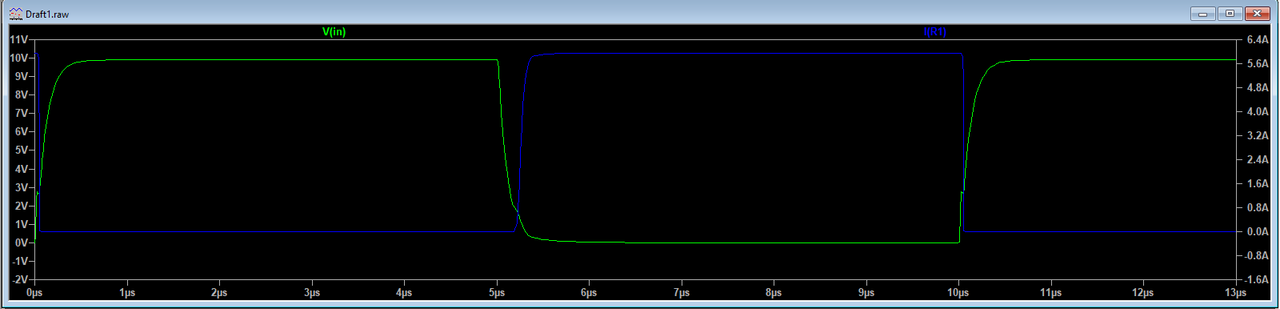

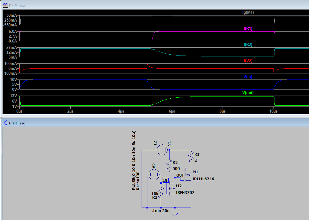

Something like this? Fast, crisp, four discrete parts, not much gate current. An interesting thing to look at, Right-clik a Voltage waveform in the simulation window, then View --> FFT. If FFT is of concern, that's a place to look.
DC_Kid
Joined Feb 25, 2008
1,242
Also notice the actual power side PWM changes just a smidge. I changed Vin from 10 to 11.8 so this issue can be more easily seen in the sim window. Signal "on" time is about 1/4us longer.
