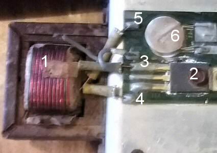

Berzerker
Joined Jul 29, 2018
623
Now I'm not trying to argue or say your wrong AG but...….
1. Is the transformer in question.
2. The NPN transistor
3. Speaker input plus (+) on collector
4. Speaker input minus (-) on second transistor collector
5. chassis ground for 12VDC.
6. One of the capacitors your schematic does not show.
Edit: If you look at the top of the number (3) and the little wire that connects to nothing is the 12VDC (+). It connects to both transistor bases.
Edit 2: This is the one I dismantled to test the parts. The other still has the wires connected to it, So I know which one is what and I did have 5 pairs or so. And (5) has GRN stamped right beside it on the PCB.
Edit 3: Now I think about it more and you all know I'm no electronics expert but this might be the isolation transformer to pull the VDC off the transistors from it being applied to the bases of the transistors and the other is the power transformer. I might have it backwards.
Audioguru
Joined Dec 20, 2007
11,248
No.
I showed before the datasheet of an old Darlington transistor that showed the middle pin is the collector that connects to +12V.
Like on the patent schematic your number 3 is the base (input of the Darlington transistor) connected to the input transformer.
Your number 4 goes to the base of the second Darlington transistor.
The schematic in the patent shows no Ground on any pin of the input transformer.
The transformer with a center-tap boosts the AC signal voltage, isolates DC voltages of the car radio from the bases of the darlingtons and produces the opposite polarity AC signals to feed the Darlington transistors.

Now that makes sense AG. If you look at a NPN transistor you get a different pin layout. I'll go back and look at the difference in a Darlington and a regular NPN. It had me confused. and I thought the base was the one you put volts to.
Pic shows different. I have changed nothing on the pic I posted. Just removed wires to disassemble.
There are two sides to it and it has to be grounded somewhere, somehow. you can not just put volts "anything" to something without a ground.
Now does the speaker input (+) and (-) go to the base or the collector? If it goes to the base then it's the middle pin???/ I got one I'm looking at. From all my reading the collector, collects what the emitter is going to put out. Base is for voltage.

I think you are forgetting there are two different voltages AG. The DC has to hook up somewhere and the AC has to hook up somewhere. 12VDC on the base to activate the transistor. and speaker input to go through the collectors and out the emitters on the transistors.
Audioguru
Joined Dec 20, 2007
11,248
You are still looking at the pins of a little low power transistor. The collector on a larger power transistor gets hot so the collector is the metal tab and is also the middle pin.
Your circuit is completely wrong and will do nothing. It has no center tap on the transformers so that the Darlington transistors can swing oppositely.
The base is supposed to be biased at about +1.4V because the two base-emitter voltage drops in a Darlington are also about +1.4V then the emitter output is 0V with no AC signal.
The center-tap on the transformers allow the AC signals on the Darlington transistor bases and emitters to work oppositely so that when one transistor goes positive then the other transistor goes negative.
Alec_t
Joined Sep 17, 2013
15,171
You have the two ends of the top transformer winding shorted together.
The collector of the right-hand transistor is shown grounded.

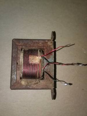

Berzerker
Joined Jul 29, 2018
623
Thanks Alec_t, AG and MrChips . OK the pin configuration in my head is wrong but it still doesn't negate the fact that one of those pins on the transistor is going to ground. Even with the pin input points moved around (post #198 by AG) it only shows that the base is now attached to ground. I have a pair (two) of these and I only disassembled one. I might should have noted that I'm not good in Diptrace yet and have things turned or hooked up wrong. Pic in post #192 does show those middle two wires on the transformer going to ground cos it is marked on the PCB board and there is a black wire coming off the one I still have intact that you hook to GRN (chassis). There is a red wire coming off the PCB with PWR stamped right beside it and using AG's pin layout is now connected to both collectors on the transistors ONLY. There are a light blue and white wire attached to one of each of the bases "using AG's pin layout" for speaker input. At the other end "the second transformer bottom" that hooks to the speaker itself are a blue and white wire to correspond with the top to show (+) and (-) and which wire goes to which.
I have updated my schematic using AG's pin layout:
But still something is wrong with what y'all tell me. Pic in post #192 noting that (5) is GRN and is on the Amplifier board (the top transformer). "assuming" that the dots on pins #1 and #7 are the same wire and pins #5 and #9 are also, just ins and outs of each. Then the schematic above is wrong?
Pic of transformer off:
Notice that there are a red and black wire twisted together in the middle they go to GRN. The other two again red and black hook to each base of the transistors. The only thing missing is the capacitor across both emitters as in post #196.
Note to AG: Just assume "pretend" the top transformer is center tapped and is 4 wire. I'm not good in Diptrace and don't know which transformers are what yet. If I knew I would place one in the schematic.
