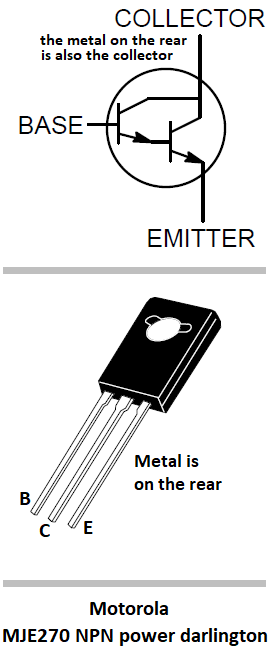

"IF" this is a correct pin layout of a Darlington NPN transistor:
Image #1
And this is a schematic of a Darlington NPN transistor:
Image #2
And now I'm just assuming that (C) stands for collector (B) stands for base and (E) stands for emitter. According to image # 1: (B) is an outer pin "meaning not the center one". (C) is the center pin (E) is the other outer pin (yes)?.
Correct me if any of this is wrong. Now if all above is correct then the 12VDC connects to the "collector" or center pins and only to the center pins on BOTH transistors. Again correct me if I'm wrong but there are "two" different voltages coming into it VAC for speaker inputs and VDC to power the transistors (YES)?. I know you can't just hook them together. Now if image #1 is correct and (B) stand for base then the speaker input (+) goes to one base of one of the transistors and the speaker (-) goes on the base to the other transistor. I can't change what they are connected too. I posted a pic of the actual transformer showing it only has four (4) wires. And I know this is how a center tapped transformer looks now:

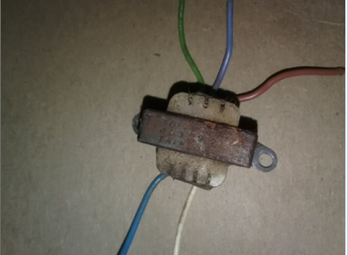

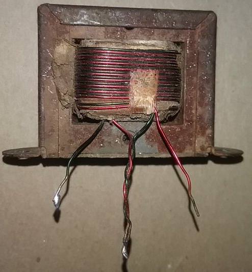

There are "not" five wires no matter what the Tenna schematic says. There are "no" input wires on it at all. they connect as I said in post # 192. Pic of actual Transformer again;
Please tell me where the center tap is on it, or the input wires? Unless the schematic you got is from the very first ones and that is not what I have. I have updated my Diptrace schematics again and here's how it looks:
The "if" will get you every time. Never go by a generic or other brand data sheet when working with transistors, Darlington or not. The to my knowledge is no convention to how the pins are numbered, it is kind of up to who makes them. So ALWAYS get the data sheet for the brand you are using. I'm sure I'll be told what was just said is wrong, but not in my experience.
And I know this is how a center tapped transformer looks now: There are "not" five wires no matter what the Tenna schematic says.
I'm wondering if this is a 'transformer' at all. It could be a mutually coupled inductor.

Thanks shortbus. I'm still not sure what it is either. I know it's not a center tapped transformer. I found a place in Birmingham, Al. that will test them both "Input and output transformers or not" for me but I will have ship it there and wait for the results. There is another transformer on it but it goes to the speaker out and it does have five wires.
The top wires all come from the board. The brown goes to ground as in my schematic above. the bottom two go to the speaker itself.

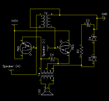

Here is the patent of the MindBlower speaker with the schematic I have been using:
https://patents.google.com/patent/US4130725A/en
The schematic you posted yesterday has many errors that I describe on my attachment:
AG, I have found in my looking at patents and trying to match them to circuits and even machines they don't often match what is actually done. The patents are often misleading to keep others from directly copying, they are only meant as a reference to get a patent.

your C3 and C4 are in the wrong place and aren't on the patent
from post #209.
This is C3 in my schematic.

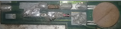

again "no their not". This is what your patent is missing. I had removed a diode and thought to take some pics before I went any further.
the other you mentioned C4 here's the answer to it.

Berzerker, You are correct on your pin numbering on the Darlintons.
I'm not so sure on that shortbus (?) I'm still learning.
The photo does not show where it is on the schematic.
http://www.pcbheaven.com/wikipages/Transistor_theory/?p=6
Your link shows coupling capacitors. You show C4 shorting the high frequencies between the emitters.

The green and blue wires you see (left) go into the output transformer and the capacitor "IS" across the emitters. The top connection is coming from the other transistor and it is also the emitter side. Did you read the article I posted? Now I'm not sure but it said something about it pulling the DC off the emitters. Again I'm new at it so I'm still "researching" Oops I mean reading about it. You might want to start giving me a little credit instead of doubting me all the time.
Edit: I don't think this is a push-pull type configuration because the emitters are not connected together as in most articles I've read, Unless it is done in the output transformer "now there's a thought".

C4 looks like a low value ceramic capacitor that might be used to smooth a high frequency peak from the transformer so it shorts the peak frequency.

I already know AG your going to say "Wrong". But I'm only asking about current flow. I been testing the components with a meter (again) and I know we've figured out they are NPN transistors. Also been looking at pin configuration on both NPN and PNP most of the morning again. Reading about the difference in how they work and the current flow through them. Read below before you tell me how bad my schematic is "OK".
Start with 12VDC it energizes the bases and activates the transistor right? Speaker input (+) comes from the radio and is positive current right?
It also goes into the collector (PH4) through the transistor and out the emitter right? Goes in the output transformer, comes out and goes to
speaker (+), through the speaker itself and out speaker (-) right? Back into the transformer and into the collector on PH3 and out the emitter to radio speaker negative right? Don't you have to have more current going in the collector on the transistor than the base? With two different currents on it wouldn't their be VDC going into your speaker also? I'm trying to figure out how the DC was remove or rather not allow to go through the speaker. I guess you could call it bleed through. Transistors are DC current based (normally) right?
Audioguru
Joined Dec 20, 2007
11,248
Absolutely NOT! Your new schematic and text are absolutely wrong and mixed up. Since your circuit shows nothing connected to 0V then the transistors do nothing and no current will flow.
The "speaker" inputs from the radio are not positive and negative DC. Since the radio outputs might be 0V, +12V or any voltage in between then the input transformer blocks their DC but passes their AC signal. The center-tapped secondary of the input transformer does not have a positive current and a negative current, Instead it has inputs with a positive phase and a negative phase. The phases are AC with opposite phase. One has + AC phase and the other has - AC phase.The bases are for the AC signal inputs and a low DC bias voltage. The collectors of these NPN emitter followers are +12V and the emitters feed the ends of the center-tapped speaker or center-tapped output transformer. The center-tap is connected to 0V so that positive-going AC to a transistor base causes the transistor to conduct and feed some of the +12V current into the center-tapped special speaker or center-tapped output transformer.
A Darlington transistor has a minimum current gain of 1000 which means that 1mA into the base results in at least 1000mA at the collector or emitter.
No DC current flows in the center-tapped 3-wire custom speaker because both emitter outputs have the same DC voltage of about 0V. When there is an AC signal then when one base and emitter drive positively then center-tapped transformer action drives the other base and emitter negatively (opposite phases).
The schematic in the patent is correct, why don't you use it?
