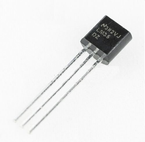

Hello,
You have drawn the rounded face of the transistor.
Most datasheets show the pin-out seen from the flat face.
As @MrChips asked, what is the partnumber of the transistor you are using?
Bertus

What is the part number of the transistor?
It is LM35 DZ. I figured out why it wasn't working. I was using a temperature sensor! because look at this from amazon.
It is the same part number LM35 DZ and it is a temperature sensor. I tried using real transistors and my circuit worked!. thanks for all your guys help! Have a nice day!

Thanks for stepping up and telling what happened. Most people who do stuff like that simply disappear and the thread goes dead. I got a good laugh and remember doing stupid things too - like putting a single op amp I to the socket if s double op amp.

Good grief! What were you drinking for Christmas?:eek::rolleyes:

What I am trying to fathom is how the OP mixed up a LM35 general purpose transistor with a temperature sensor. When as far as I know there is no such a thing as a LM35 transistor.
My guess is that, like lots of beginners (probably including most of us here, at least about some things) who have only interacted with a handful of parts, they associated the package style with the device type. So anything in a TO-92 case is a transistor. More to the point, it is a transistor with the pins in a fixed and never changing order. Anything in a package that looks like an axial resistor must be a resistor -- similarly packaged fuses and inductors and such simply aren't yet in their world.
