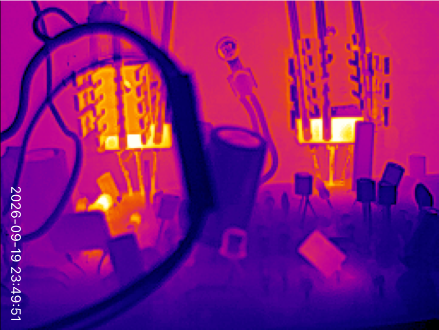

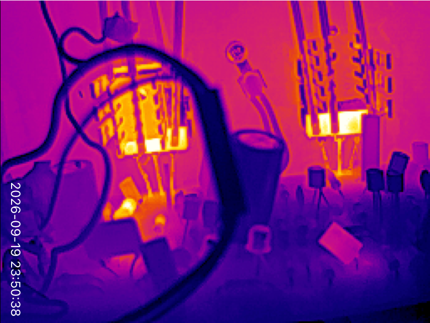

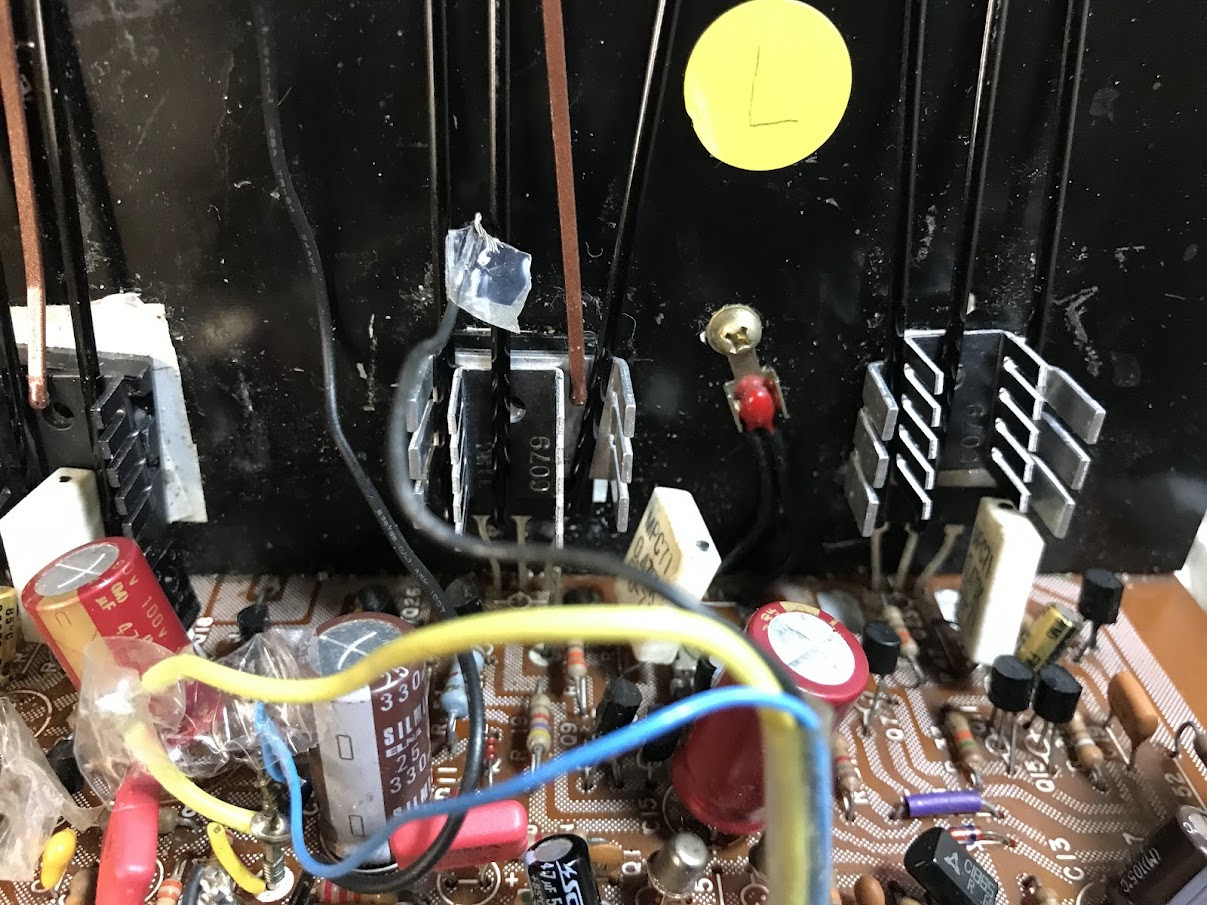

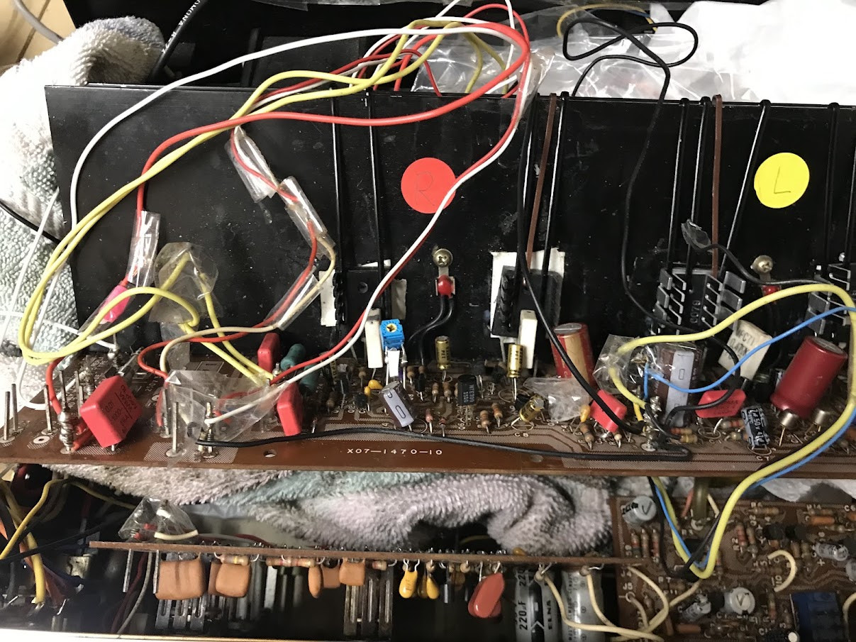

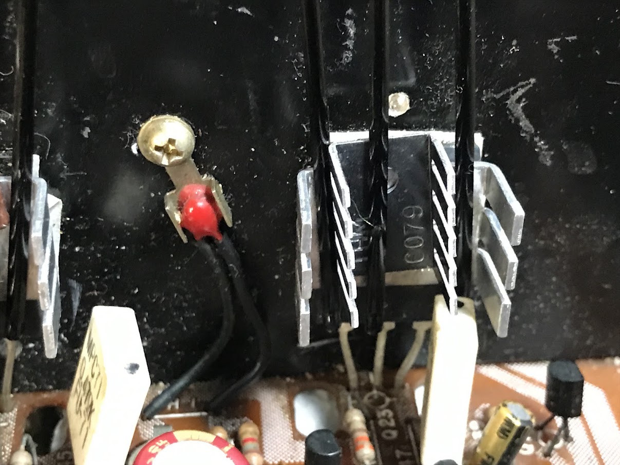

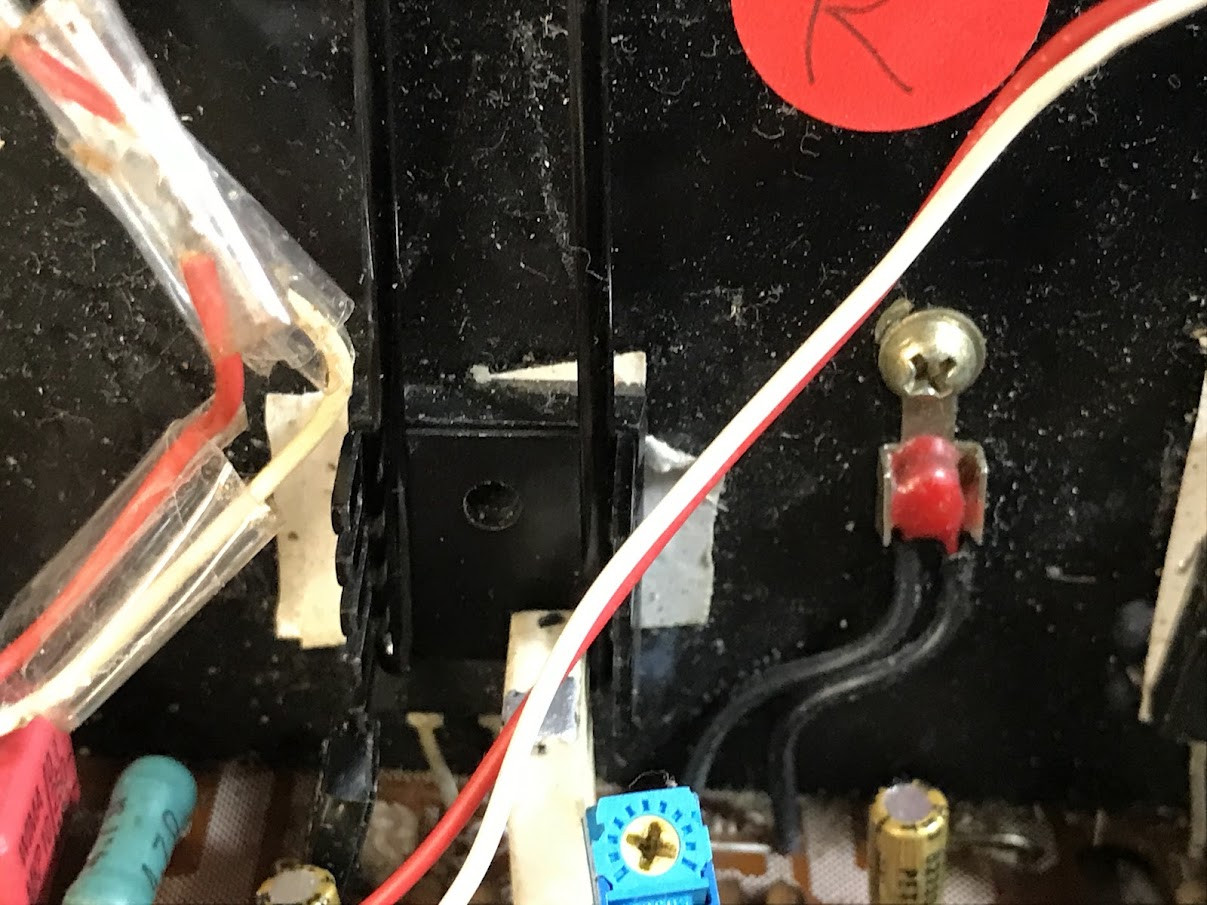

Experimenting with a 1976 Kenwood KA-3500 (40 watts per channel into 8Ω (stereo)) integrated amplifier.

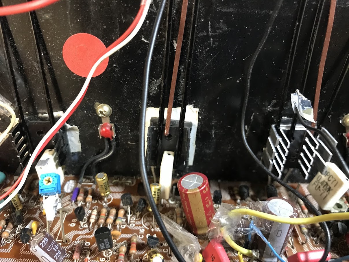

I replaced all 4 original NEC 2SB618+ 2SD588 "batwing" [TB33] pwr trans with new Toshiba 2SC5200 / 2SA1943 which are TO3PL (TO-264) pkg. So they cannot be screwed into orig heatsink w/o modification.
I don't want to go that route just yet.
It may be more educational to experiment with coupling the TO3 to the heatsink w/o extensive mods.
And then, test it out with FLIR thermal camera, finger test, wattmeter (Killawatt), o'scope waveform analysis. The thermal camera is a very useful device, and can give a lot of insight.

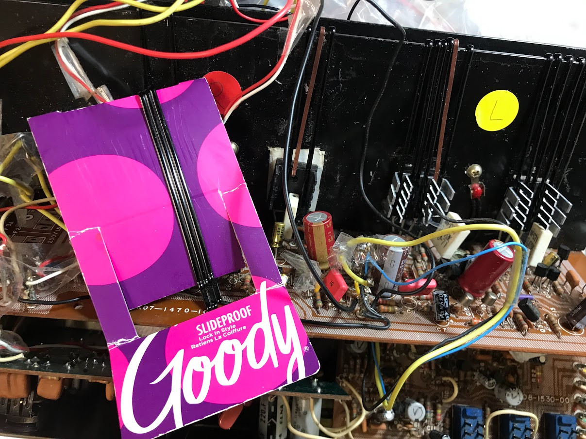

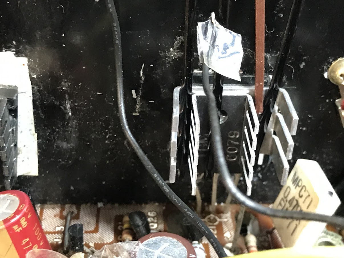

What I've done is use double-sided (insulated) thermal tape to adhere TO3 (TO-264) devices to heatsink. Then I am using several women's long hair pins to compress the TO3 (TO-264) to heatsink (emulating the compression of the single screw that's not being used) . The amount of tensile compressing of each hair pin increases as it spread further apart. So this gives me an opportunity to add smaller heatsink units to the FRONT of the TO3 (TO-264) devices. I'm still playing around. I have not used any thermal compound or thermal tape for the smaller, front heatsinks. I have maximized the number of hairpins I can fit on the width of the TO3.
This approach to dissipating heat seems to be doing okay, but I have not done the usual 10-min full pwr test (just below clipping).
The specs for KA-3500 are 280w from wall at full 40W into 8 ohms.
Idle pwr draw of the KA-3500 is about 13W (120 VAC). I have taken the volume up, with 1k sine wave (into 6-ohm) dummy load , with the Killawatt reading about 38W at 120AC mains. The thermal camera can see parts of the TO3 (TO-264) that the front heat sink does not touch. And that is about 160F at the 38W draw.
Perhaps the most interesting thing I've learned from this experiment is how warm the FRONT heat sinks become. (Yes, the the large rear OEM heat sinks get warm, but they are very large.
Questions:
Is the thermal coupling of these pwr transistors meant for ONLY rear heat transfer? Meaning internal die couples ONLY to rear for heat conduction? If so, why does the FRONT of device still get hot (to finger touch or probe/FLIR measurement)?
How tight is the usual screw/bolt (only one is needed to TO3) supposed to be? I assume: It can't be too tight to avoid mechanical damage to stress to silicon wafer.

When you use a thermal camera, just remember that different materials have different thermal emissivity. From the top of my head, brushed natural aluminum is a poor thermal emitter. The thermal readings will be inconsistent. If you can, substitute those with black anodized heat sinks.

You can use large binder clips such as this:
As long as you don't use too much force. Excess force can cause thermal grease to be squeezed out and reduce the amount of heat transfer.
Not true.
You want a minimum layer of thermal grease for maximum heat transfer, since the grease has a much higher thermal resistance than the metal (but lower than air).
The grease is just to fill in any small air gaps between the transistor and the heatsink.
Any grease more than the minimum to fill those gaps, will reduce the heat transfer.

The large binder clip would be good, but that large and tall orig heatsink does not allow for much clearance for anything other than the hair clips.

So what about the FRONT of the device, be it a transistor, regulator, etc? As I asked in the OP:

Devices intended to have a heatsink certainly have a PRIMARY heat-transfer surface, but all of the other surfaces can also provide heat transfer out.

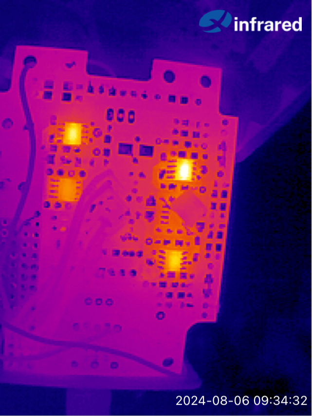

I ran into this issue with SOIC 8-pin LMH6321 current buffers for a portable DIY headphone amp I built many years ago. If the environment got too warm (outside in a heat wave), I would get loud distortion.
Measured buffer temps at 130F (idle) when room temp at 75F.
I did use same thermal tape and some flat copper to heat sink. And this fixed the issue.
(Below is a before-fix thermal image)

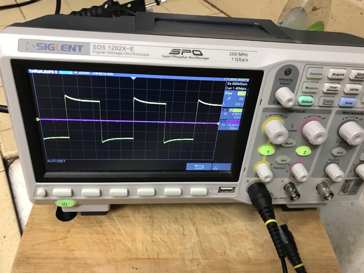

No one mentioned, so I'll mention: your scrope probe needs adjustment. There's a screw on the BNC connector that you can rotate to better adjust for a critically dampened transition between the low and high levels of your square wave. The 5 V 50% duty on every scope is to calibrate for that. The screw tighten on the cable creating less distance between the center and the outer side, so it can change the capacitance, thus changing the behavior. I never took the time to understand it, I just calibrated it.
Here is why and how
Edit: fixed typo

There's a screw on the BNC connector that you can rotate to better adjust for a critically dampened transistion between the low and high levels of your square wave.
All the 10X scope probes I've used have the adjustment screw on the probe, but apparently some have it on the BNC connector.
My attempt to answer (I think it's correct):
Yes, the rear is where the chip have low thermal resistance to the package.
Why does the front still get hot? Because it conducts heat and can't dissipate well through the front. You can crush a transistor like that and see for yourself that the front is pure epoxy. Epoxy doesn't conduct well thermally. All your effort with frontal heatsink is probably minimal advantage to the system.
Also, you never put a scale next to the images, so they are almost meaningless in terms of value of temperature. If the hot spot is 100 °C and the coolest spot is 0 °C would be the same image (almost, hard to distinguish) as 50° C hot spot and 25 °C coldest spot.
Yes, the die is connected to the metal tab, so the heat goes from the tab to the heat-sink.
As would be expected, the epoxy package gets about as hot as the tab on the heat-sink due to heat conduction from the tab to the package, even though the epoxy has relatively poor heat conduction.
