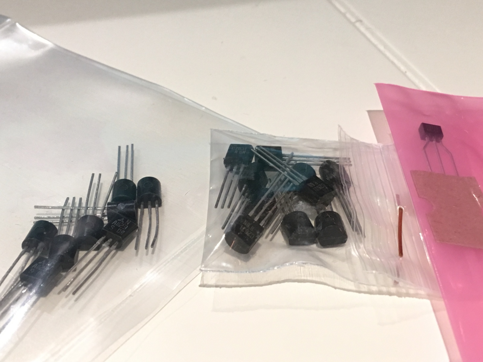

Finally my transistors arrived.
I got only one of Q420, C3311..
But ten pcs. of C2631 and eight of A1123
What is our next move, Mr.Chips? :)

Ok.
Install new Q406 - 2SC2631
Install Q408
Power ON and check for smoke, especially at R414.

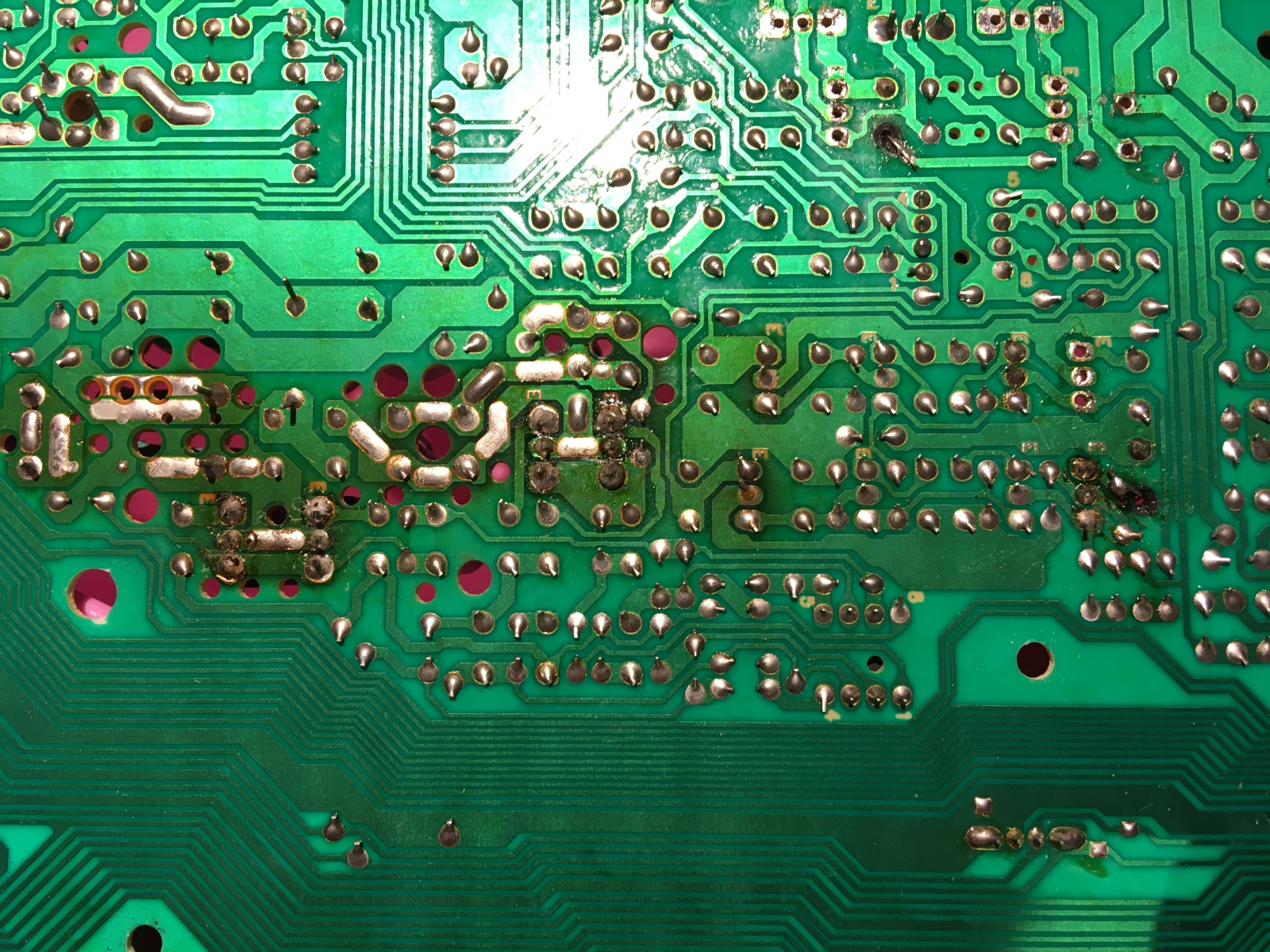

Marius83
Joined Dec 28, 2017
423
I understand, i have now inspected the board on the underside and overside carefully at these components you have mentioned, i cannot find any shorts or bad solder bridges.
I took a picture of the area you wanted to look closer on, it is not a very good picture as i didn't have the best light available.
Notice the PCB beginning to get a little worn at R414.. it doesn't take the heat very well always. I had to scrape off a little of the green "paint" to get a new point to solder R414, but that shouldn't be a problem.
Just to mention why it looks like it does.:)
I measured D412 and C410, and they have the same values as you mentioned.

MrChips
Joined Oct 2, 2009
35,249
Please remove C410 and measure its resistance out of circuit.
Also, remove Q406 and test both Q406 and Q408.

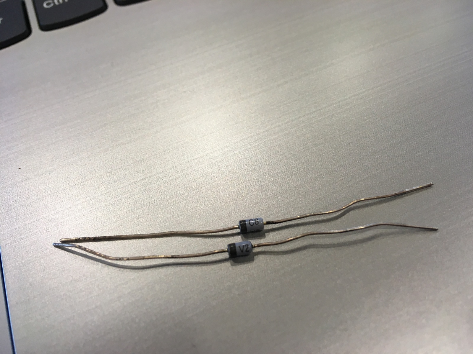

Looks like D412 is bad. We will have to replace both D410 and D412 at the same time.
Part # MA4082MTA 8.2V zener diode
Substitutions are:
NTE5016A 8.2V 500mW
1N5237
Marius83
Joined Dec 28, 2017
423
I stopped by the local service shop and asked if he had the right type of diode.
He got these Motorola 8,2 V zener diode, but they are a bit bigger then the ones in the amp.
They are marked with C8 and V2, he didn't know the exact wattage but he said sure i could use them...
I have googled the numbers and i believe they "are" 1300 mW ...
What do you think MrChips? Could we use these?
