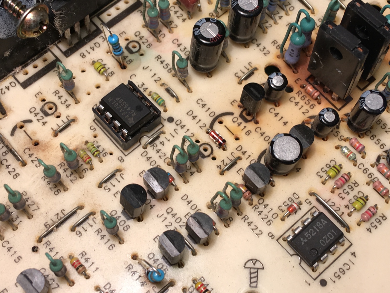

Here is a summary of where we're at.
1) C425 filter capacitor on the +60V line keeps popping. We've left it out for now until we get all the voltages correct and stabilized.
2) LEFT CHANNEL was blown accidentally. I think we have that stabilized. Q507-Q509 complementary output pair are in place. Q515-Q517 pair have been removed for now. DC balance not yet adjusted. Will do that later.
3) LEFT & RIGHT CHANNEL outputs from preamp have been disconnected. Inputs to power amp are currently grounded.
4) On RIGHT CHANNEL, Q406, D412, Q416 identified as blown. Waiting for more supplies to arrive. The plan is to replace Q406, Q408, D410, D412, Q416, IC402.
5) Still to come, replace Q420, Q424, Q426, Q428, Q430.
6) Still to come, check DC levels from preamp.
7) Still to come, check possible fault on front panel.

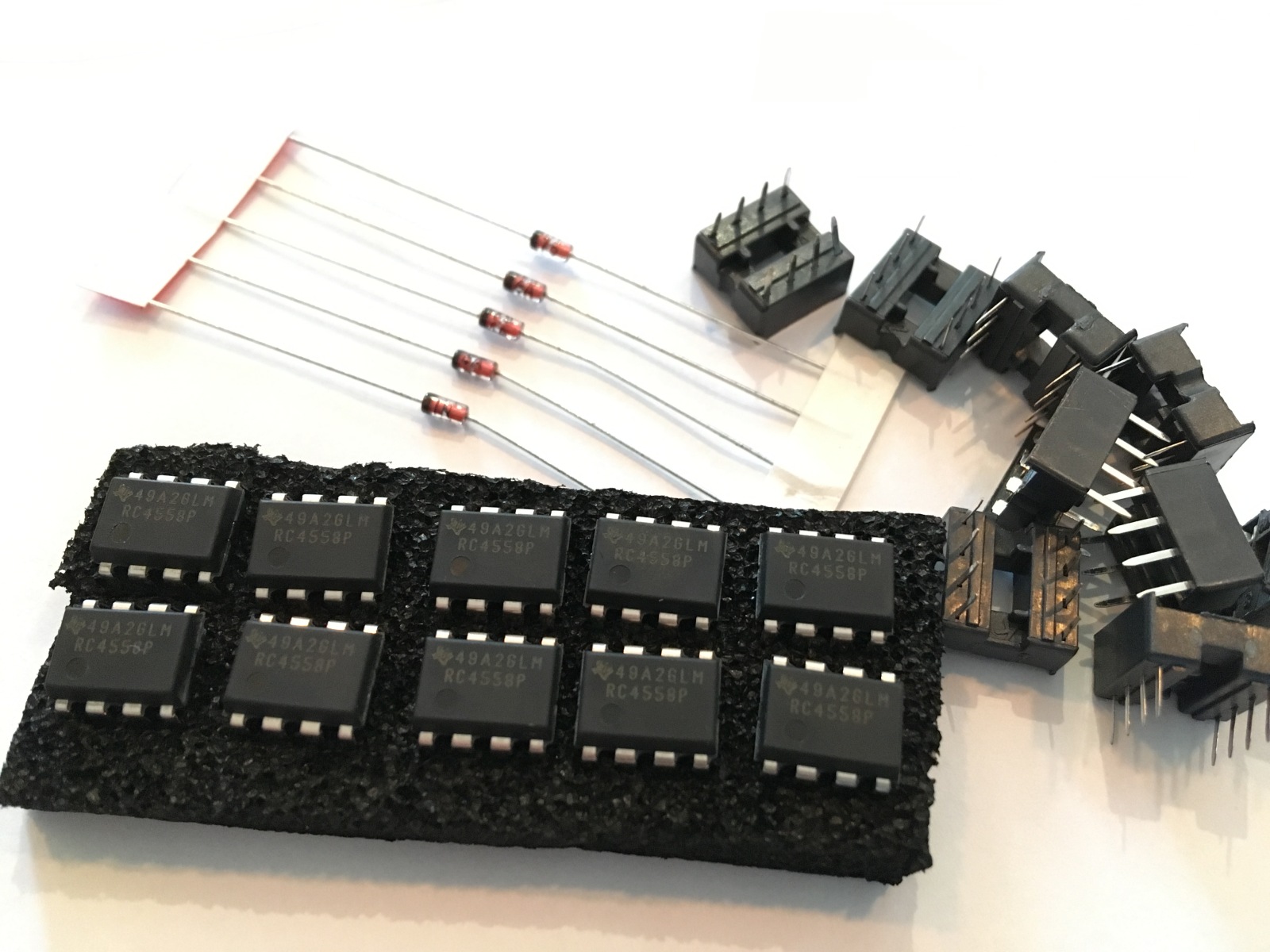

Finally my supplies arrived.
1N756A DIODE ZENER 8.2V 500MW DO35
What is our next step MrChips? :)

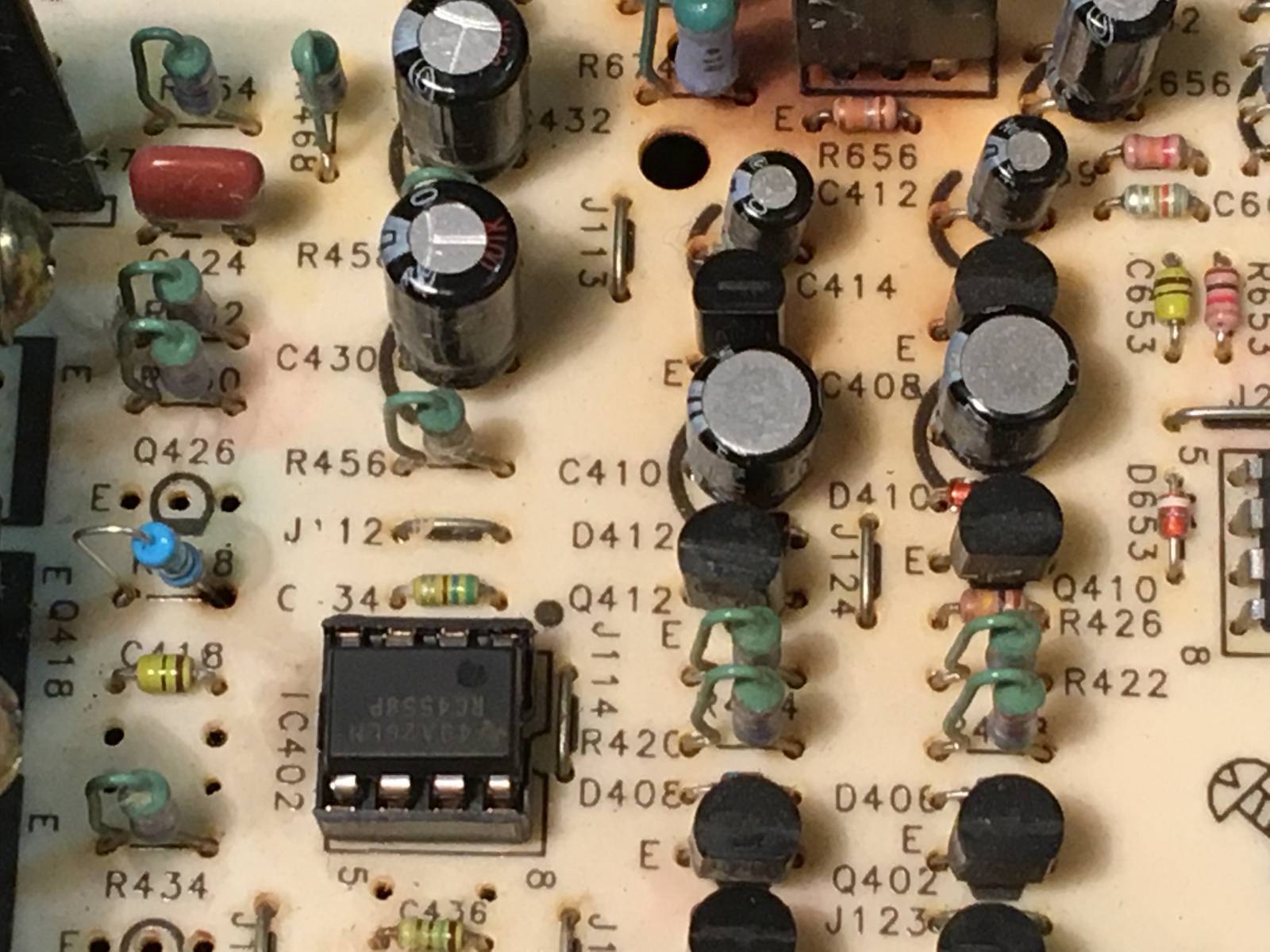

IC402 got subjected to 64V. We cannot be too sure about its status.
I would go ahead and remove IC402. Note the orientation of that chip before removing.
The simplest way to remove an IC in a DIP package is to clip all the leads with a small side cutter rather than trying to save it. Remove each pin one at a time.
Clean the PCB holes with solder wick or a solder sucker. Install an 8-pin DIP socket, oriented the right way as per original IC. Install replacement IC, RC4558P.
When new ICs in DIP packages are received, you will notice that the pins are not pointing straight down but are spread apart. You want to bend the pins so that they are at right angles to the body of the chip. I do this by pressing the one side of the legs against the top of the workbench. Turn the chip around and do the other side.
Remove zener diodes D410 and D412. Note the orientation of anode & cathode (black band on body is cathode).
Install replacement zener diodes, 1N756A.
Install Q406, 2SC2631
Install Q408, 2SA1123
Install Q416, 2SA1123
Power up. Check for smoke.:eek:

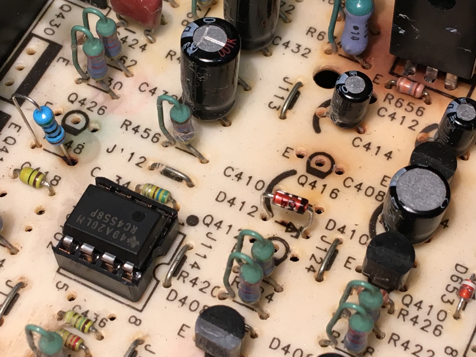

I have a solder wick, it works very good, removing the IC with all legs were no problem. :)
I noticed the orientation, and it were marked on the pcb how to place the socket.
Same with the diodes, it's markings on the pcb showing which way to put it.
SO, i put in a socket and replaced IC402, then i replaced D412 and D410
At last i installed Q406, Q408 and Q416(new one).
Power ON. No smoke ! :)
Measured voltages:
R428: +9,8 / +11,8 Volts
R430: +7,8 / +5 Volts

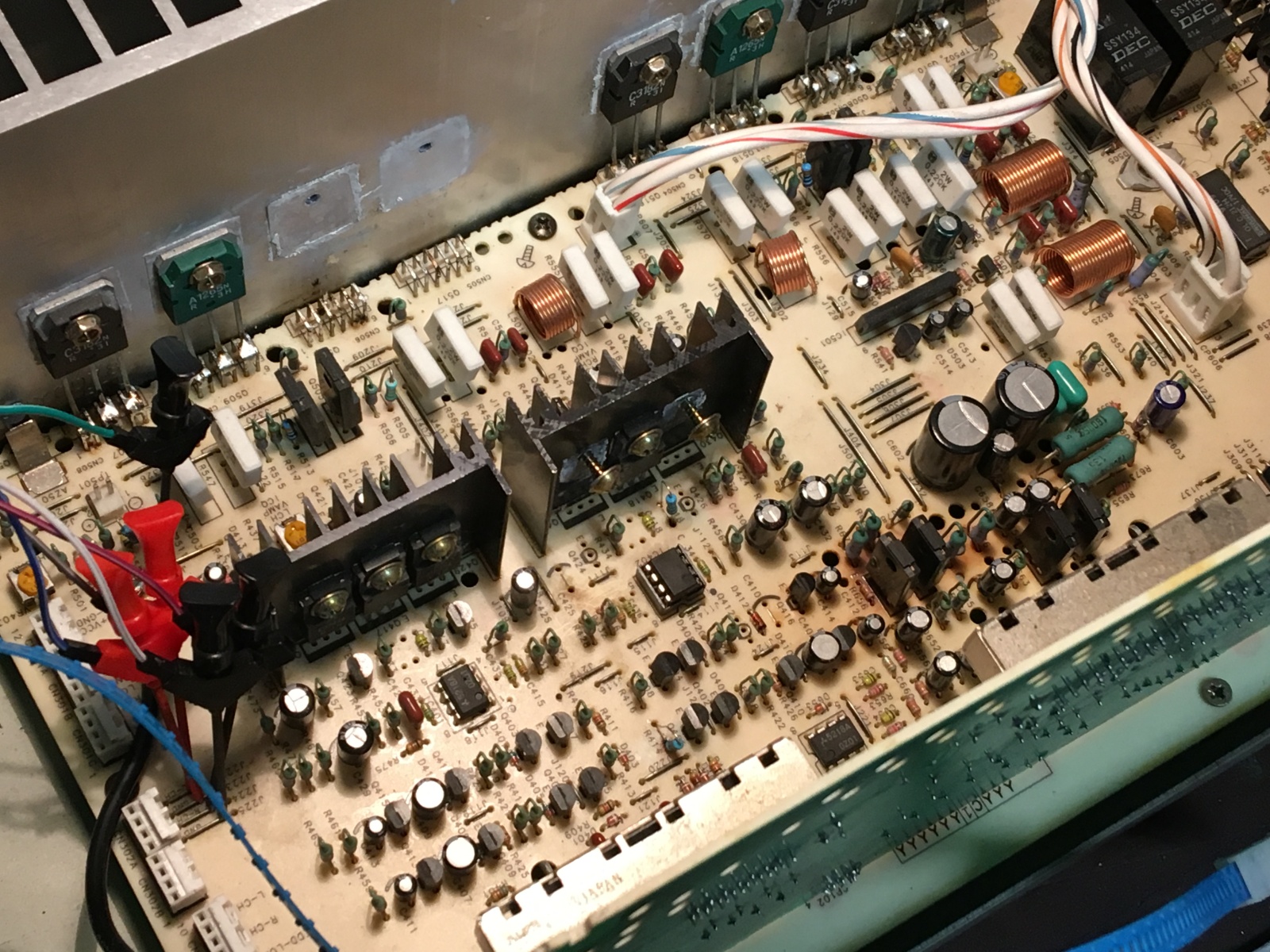

Overview of the amp as it is right now, i realised it was an unclear picture afterwards..
MrChips
Joined Oct 2, 2009
35,095
Ok. Thanks for that.
I see C410, Q412, and Q416 are not installed.
Install these and repeat the voltage measurements on
R428
R430
I need a chance to see where we're at and I will get back to you. I will be away for some hours and may not respond until the next day.

The two pictures are taken at different points, if you look at the first one, Q416 is installed like i wrote.
But you are correct about C410 and Q412, i can't remember you've said i should install them, but i may be wrong :)
I will install them and see what happens :)
