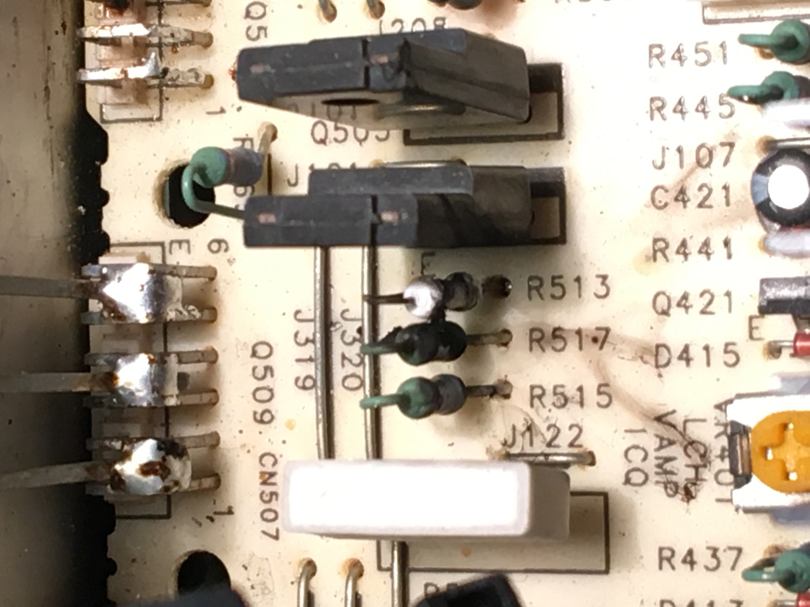

So i begun testing.. power on, and i turned VR402 all the way CCW.
I started to measure all testing points.. i did not get through all before i noticed a humming sound from the amplifier...
..and suddenly R513 went up in flames :eek: .. so i turned it off... tried to turn it on again.. then R401 started smoking so i turned it off afraid of what it would burn next... :confused: ... so if i turn it on again now i think R401 will smoke even more... what should i do? :confused:

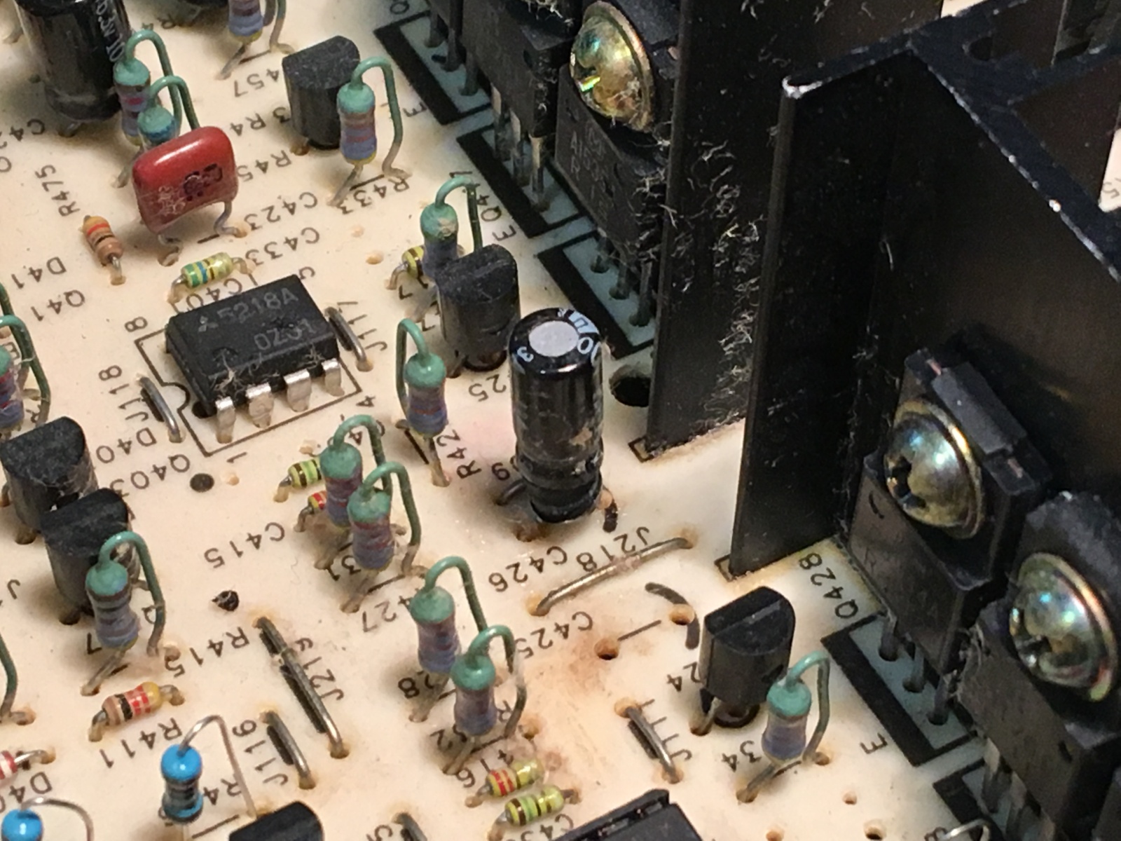

Humming sound...about two seconds and C426 went up in smoke.

Marius83
Joined Dec 28, 2017
423
GND connection to PCB is a screw going to the chassi, it's also holding PCB so it's there.
So this suddenly happening is a mystery if i get it right?
We thought we had stabilized LEFT channel and suddenly it's unstable again...
I have looked closely for shorts, but i can't seem to find anything wrong.
I noticed that R402 looked a little burned too.. but i measured it to be 566Ω, so i thought i'll give it a try.
So i removed C426.
Put back my hook-up jumpers on J222-J223-J224-J225 to J401
Power on!
It went a couple of seconds, before both R401 and R402 started smoking, then R401 burned up and right after R402 :eek:
After that, nothing more were smoking..
Before..

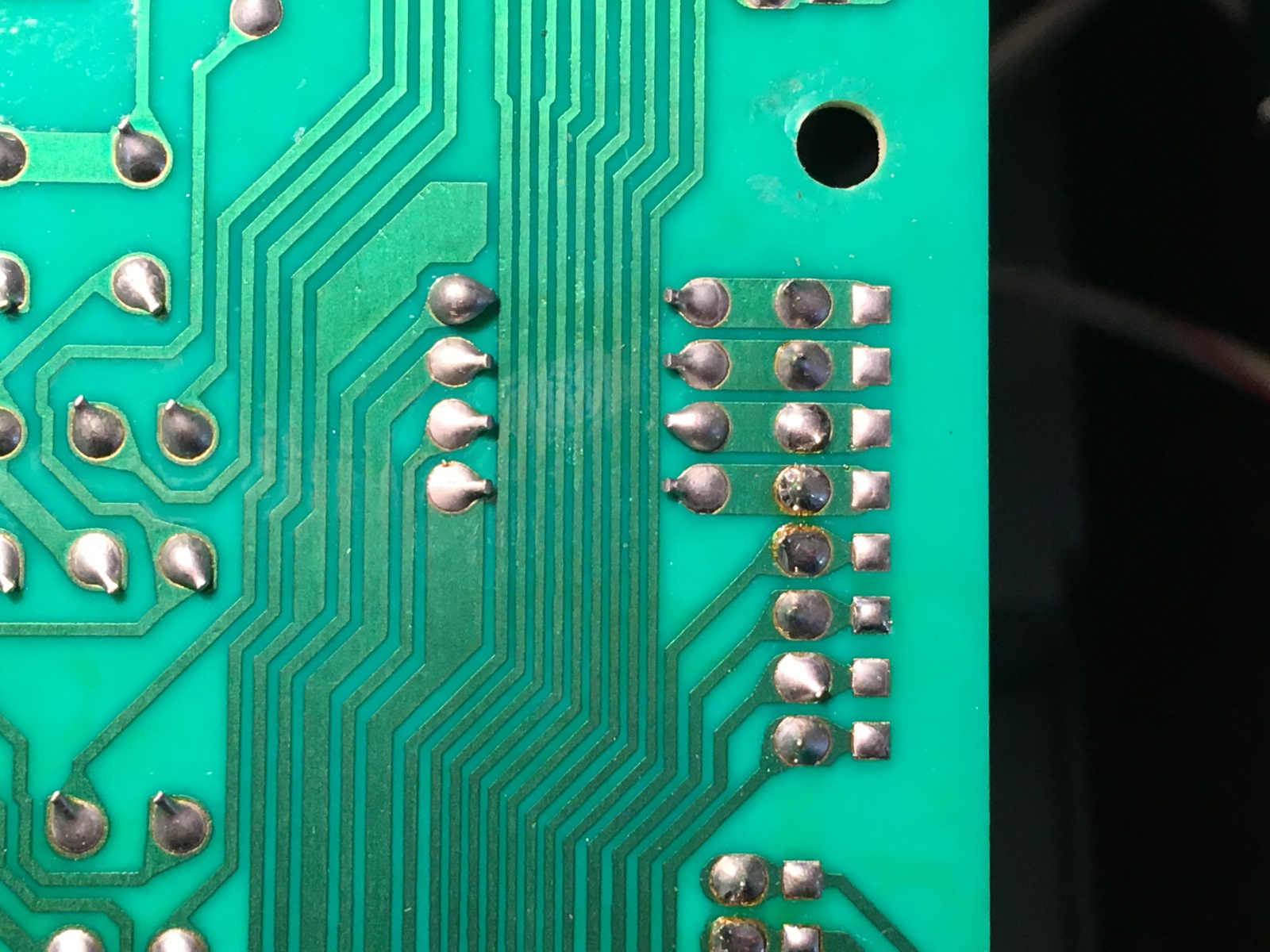

This is a previous photo of the solder side of the PCB showing the connections to R401 and R402.
It is a mystery as to why both R401 and R402 would be destroyed even when one leg of each resistor is left floating.
We need to see a closeup of the pads at the connector circled in red at the area around R401 and R402.

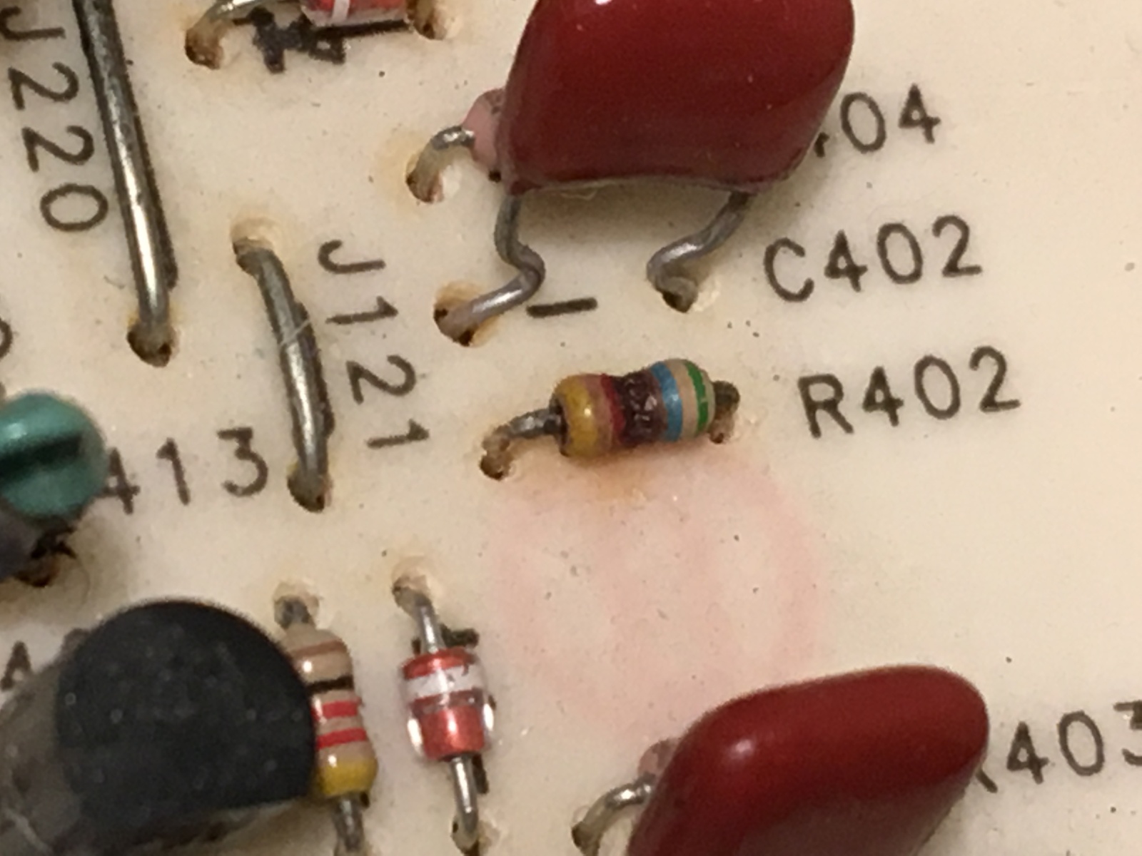

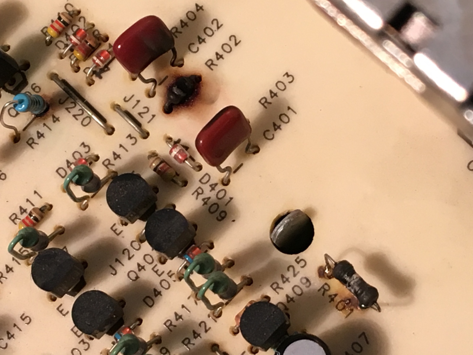

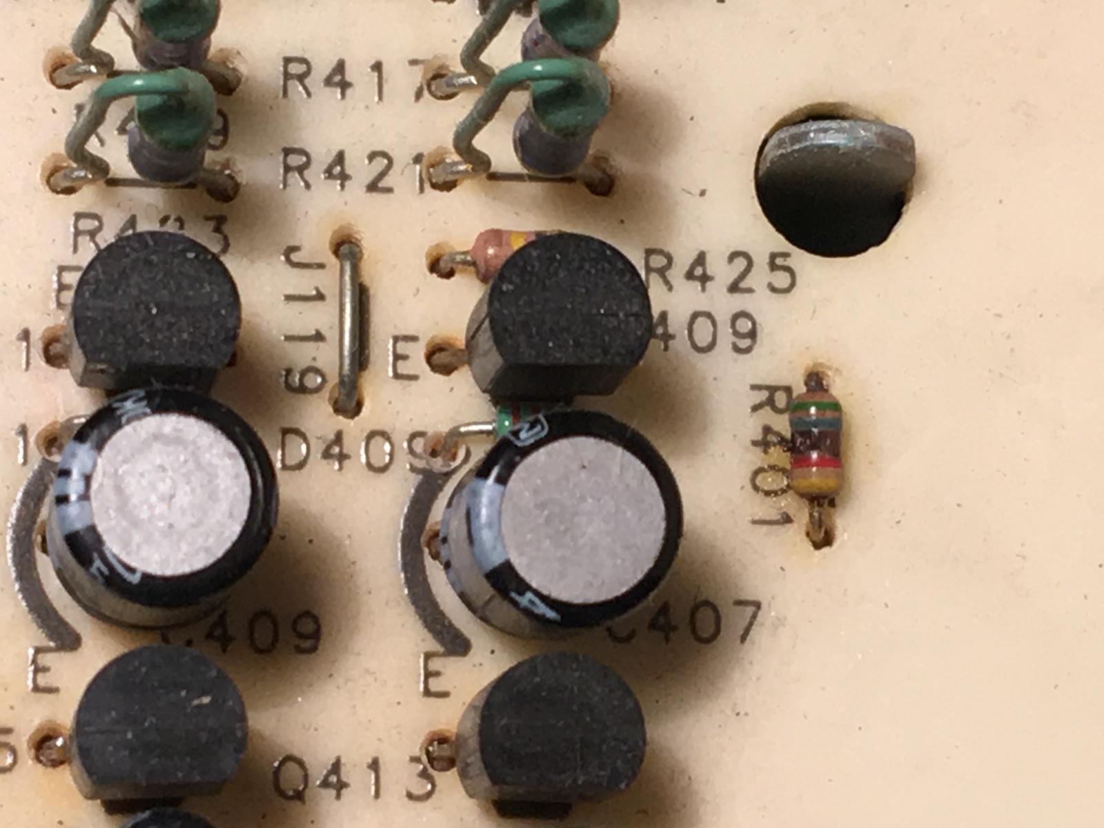

Marius83
Joined Dec 28, 2017
423

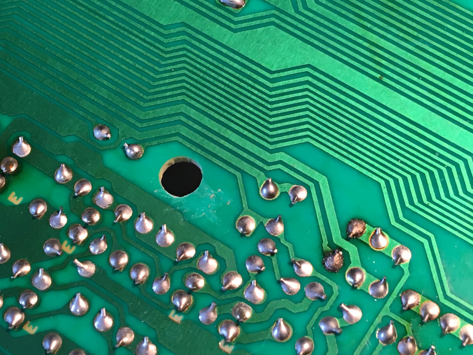

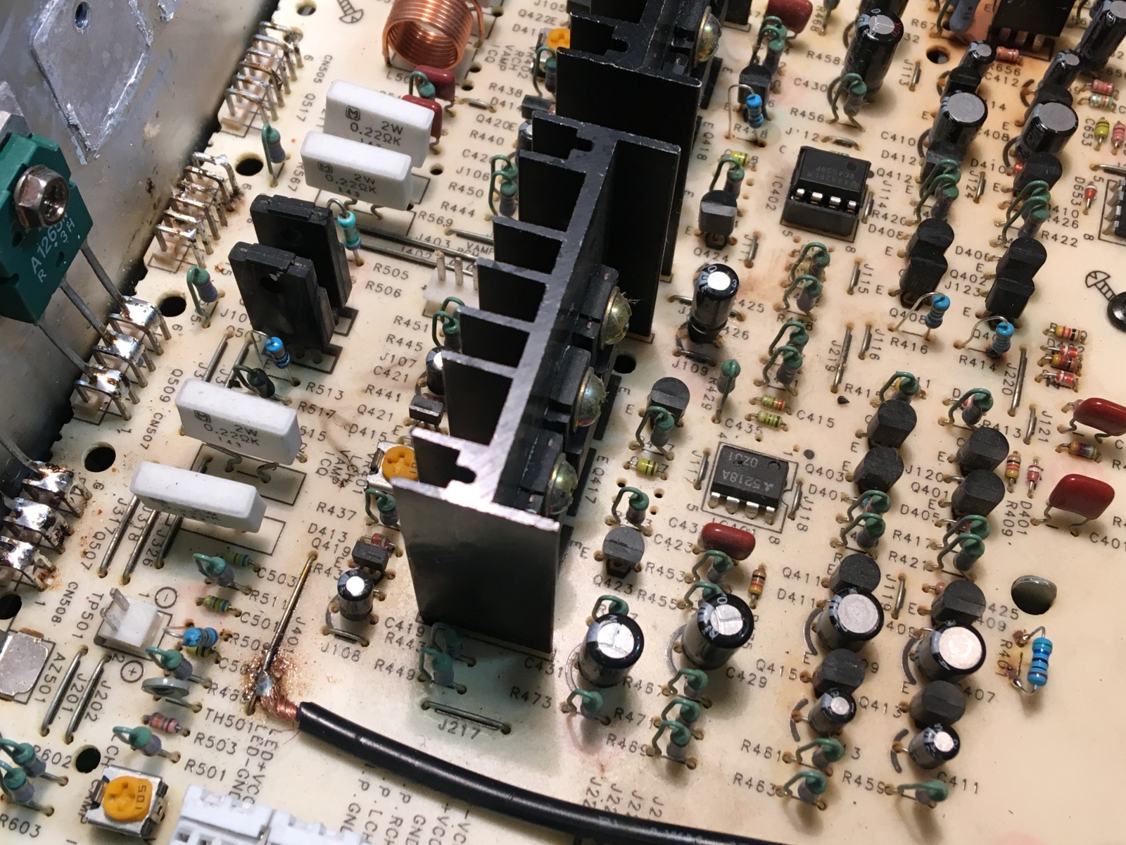

I have taken out the circuit board and carefully inspected it.
I cannot seem to find anything wrong on the solder side....
See pictures, the points that have been hot is R402, the one upper left is R401

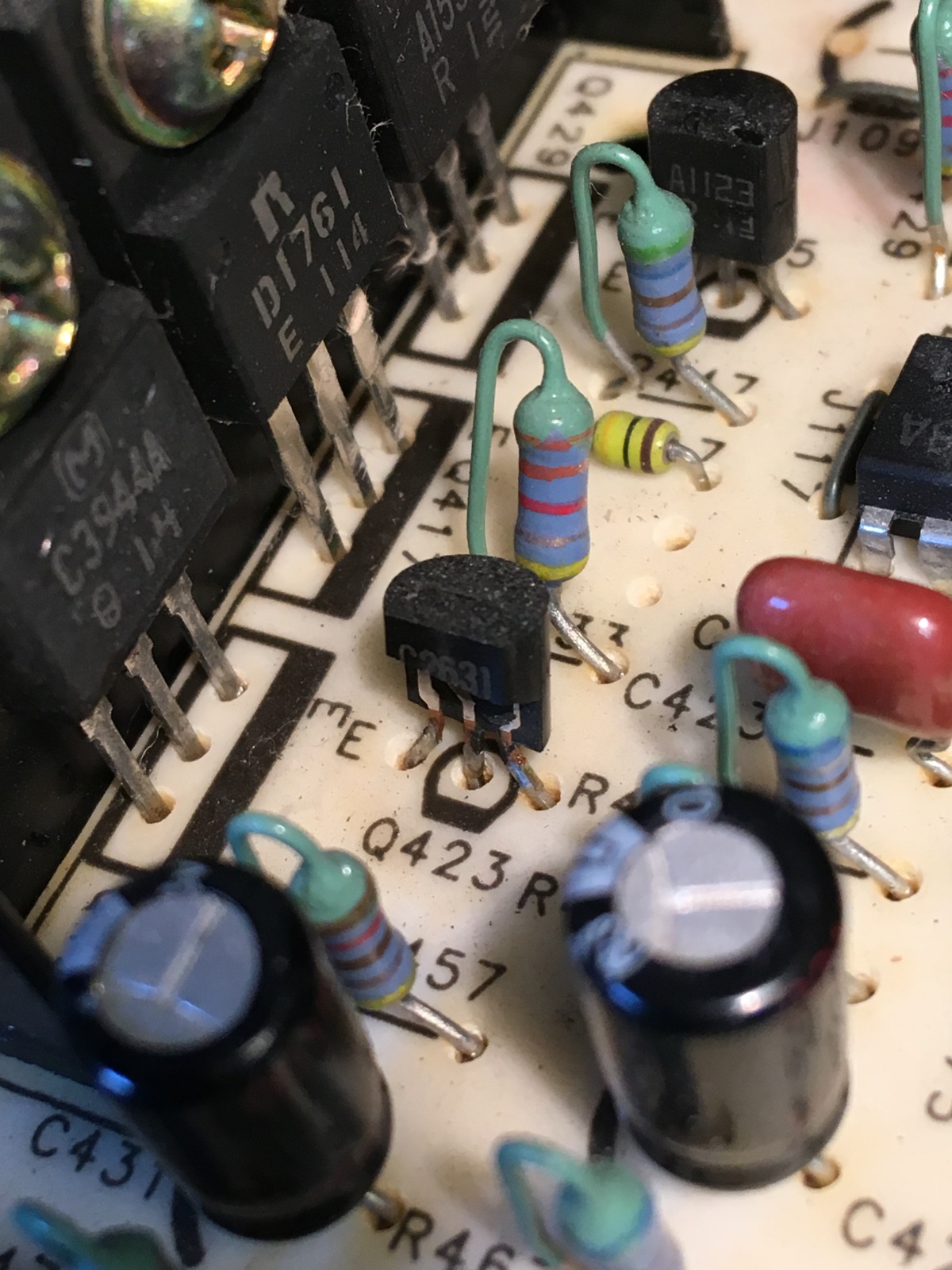

On the component side, i did find something that i have not seen earlier, so if it happened now or earlier, i'm not entirely sure..
Q423 is damaged.. but i suppose it would only cause a break..
