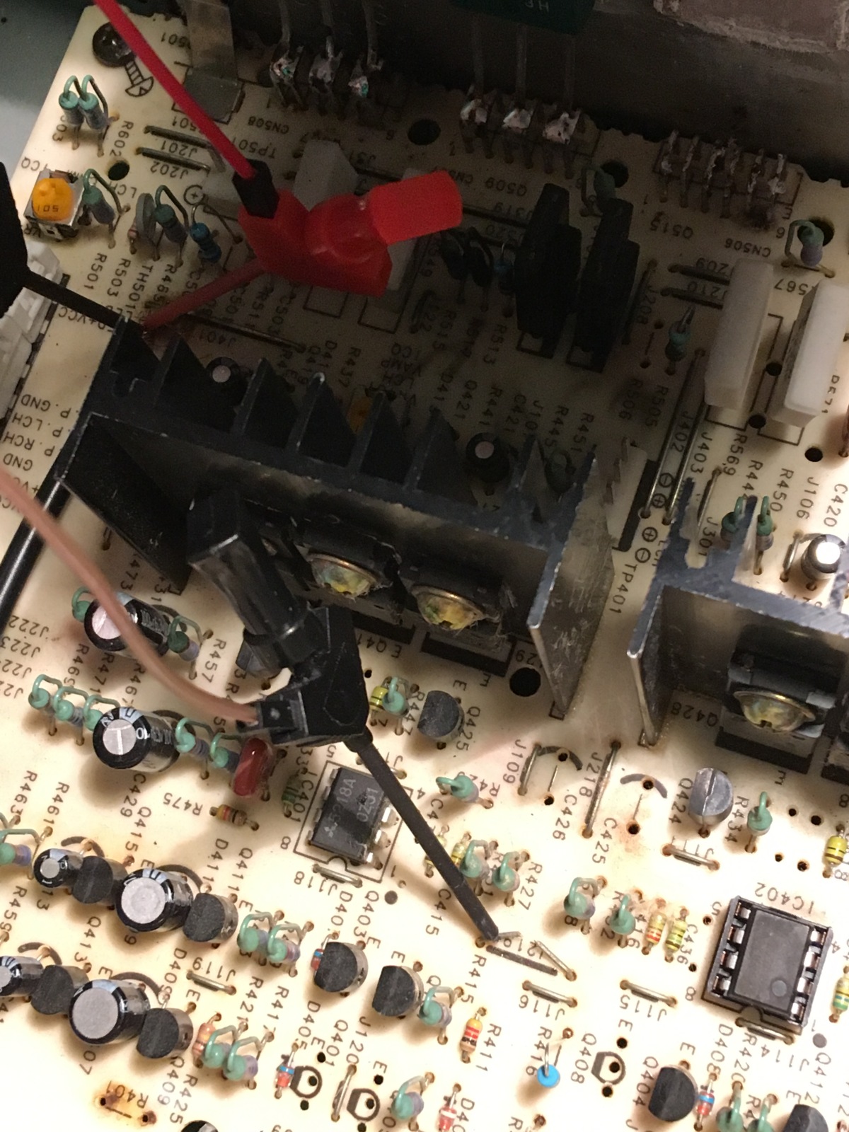

With POWER OFF and unplugged, we will do some resistance checks.
At this point I assume C425 and C426 have been removed. Make sure that there are no shorts at the C425 and C426 solder pads.
Also R506 has been removed.
Measure resistance between J401 and J402. Measure both ways (i.e. leads reversed).
If you get a low resistance (under 10Ω) proceed with the following.
Cut J219 in the middle with a side cutter. Separate the two cut wires so that they are apart and not touching.
Measure resistance between J401 and left side of J219, both ways.
Measure resistance between J401 and right side of J219, both ways.

C425 and C426 are removed and there is no solder issues. R506 has also been removed.
So i measure the resistance between J401 and J402..
With the red wire to J401 the resistance is increasing very rapidly, and stops on the value you can see in my picture.
If i do measure the other way with black wire at J401 the resistance just increase until it gets out of range... like open circuit
So i did not proceed with the other you described...

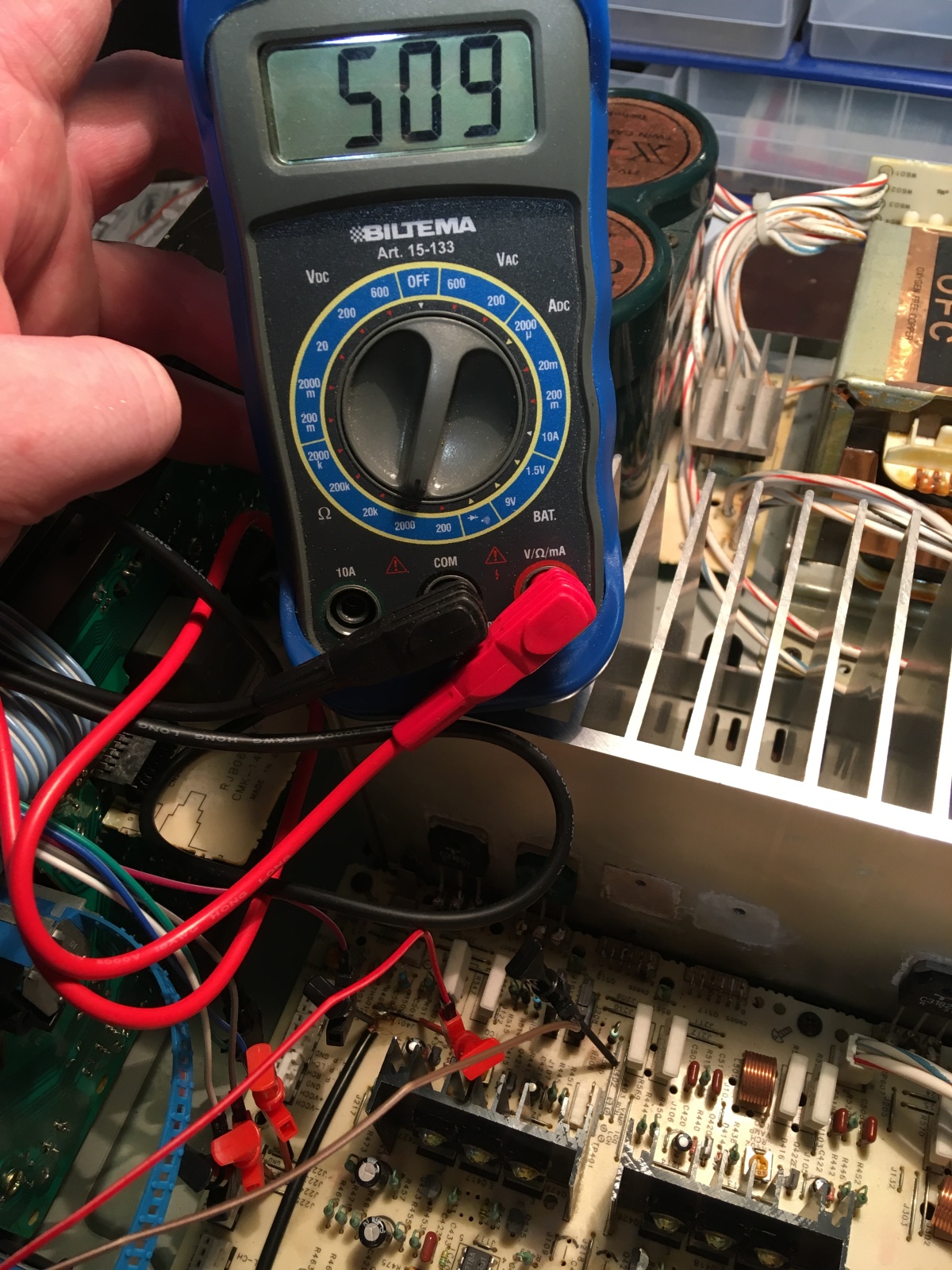

So i cut J219.
Let's use right and left in in your picture, my picture here will be opposit.
When i put red wire to J401 and black to the left leg of J219 in your picture i got 512Ω
The three other combinations just increases till it gets out of range

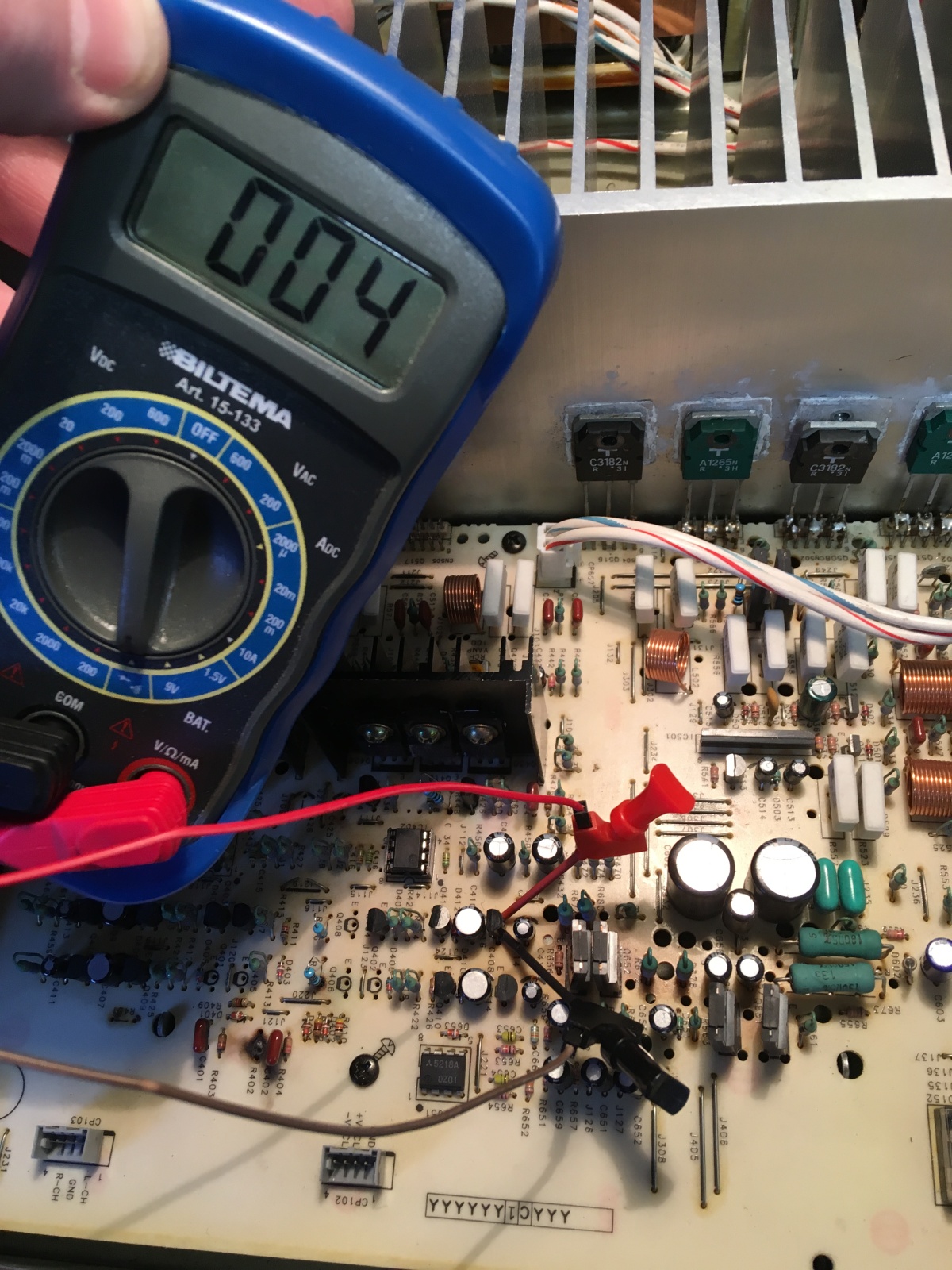

In your report, some measurements are shown as "0" while some are shown as "short".
Can you clarify the difference?
By "0" do you mean "open"?
What reading shows on the meter when you report "short"?
Sorry not beeing specific enough, yes with 0 i mean open circuit, i rather might type open circuit than 0, i agree :)
My DMM "beeps" when the contact is good enough, i don't know exactly at which value it does, but i take that as the transistor has a short circuit...
Look at the picture, there's the value at Q416 with Red to E and black to C and it beeps.

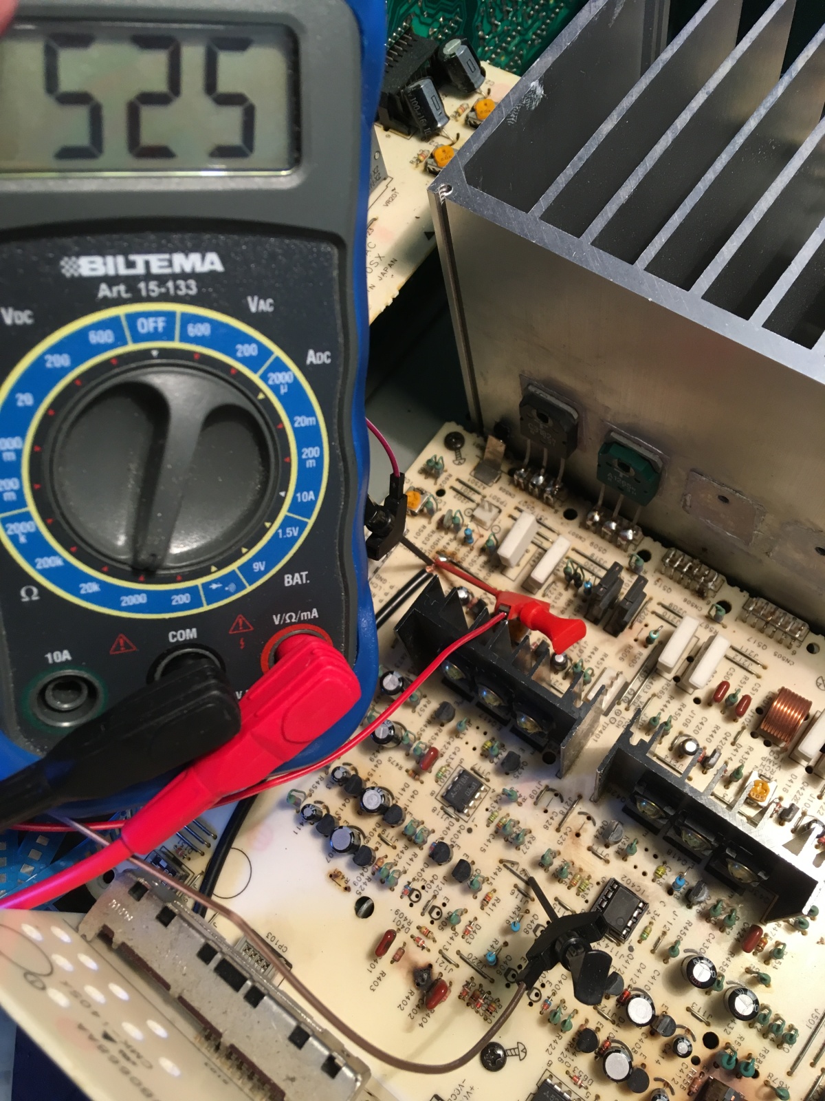

Then i measured resistance between J401 and J219:
With black to J401 it's open circuit at both J219
With red to J401 and to the right J219 i get 534 at the 2000K setting on my DMM.. hehe.. almost open circuit or what?
With red to J401 and black to the left J219 i got 510Ω

Then i measured resistance between J401 and J219 again.
Readings are the same as after i removed Q430 with a little difference, i got 580 at the 2000K DDM setting, and 505Ω with black to left J219
