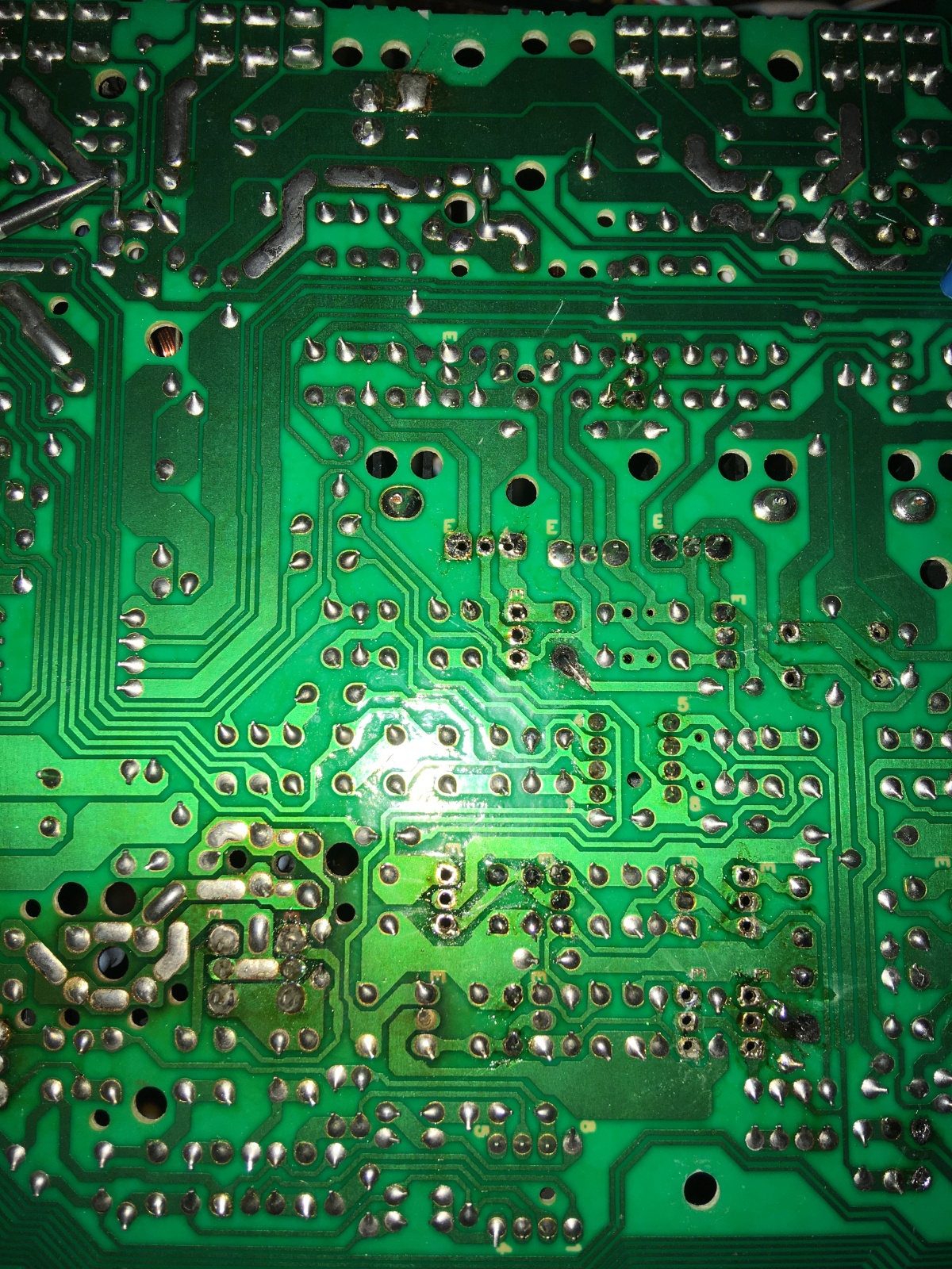

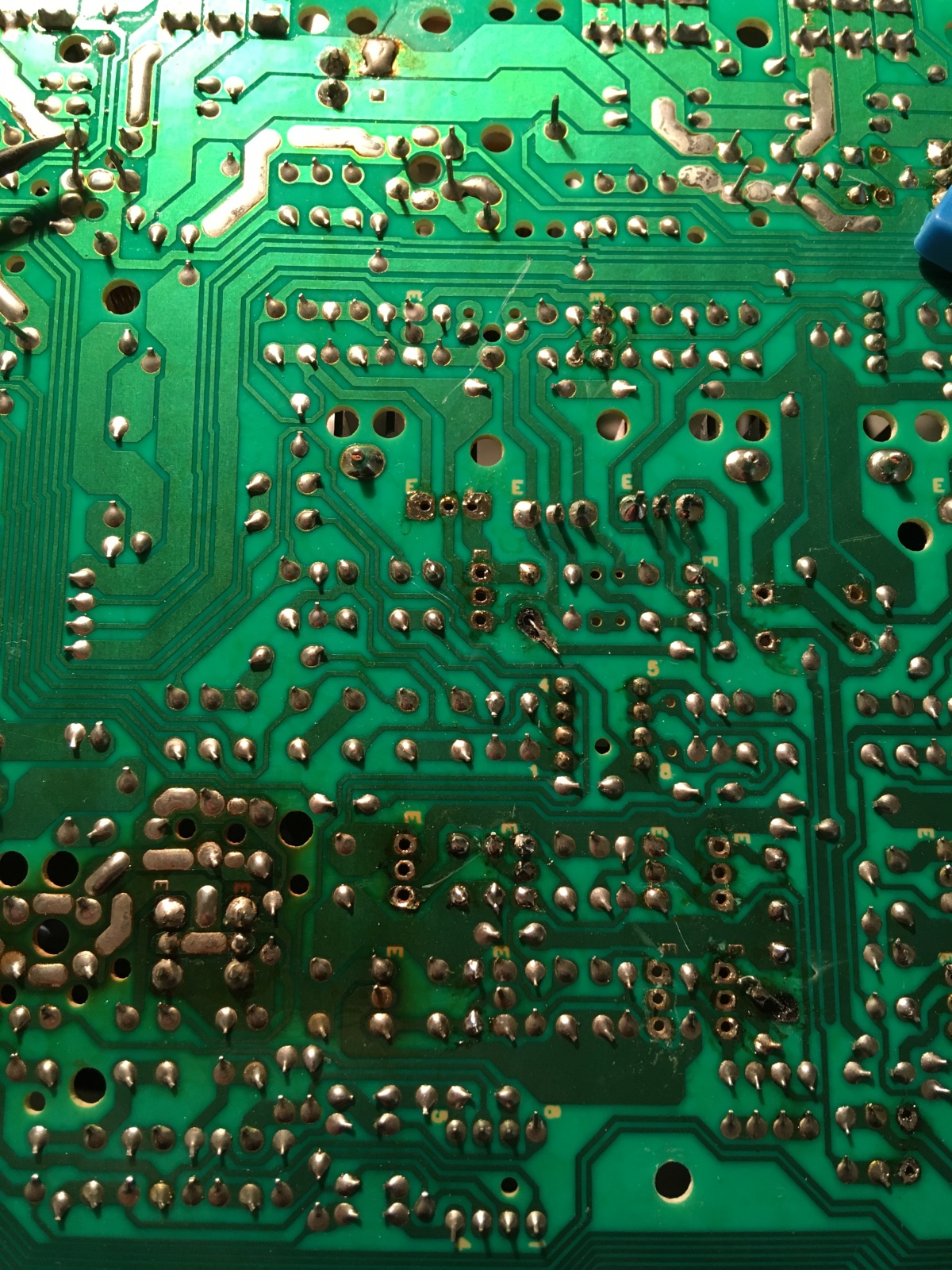

Hard to get a really good picture, here's one with flash and one without..
I can try to do a better job if it's hardt to see :D
MrChips
Joined Oct 2, 2009
35,138
Thanks for the great photos. I can see the traces very clearly now.
Remove Q425 and test.
Check resistance between J401 and J219.
I hope you're keeping track of which components we have removed lately.
