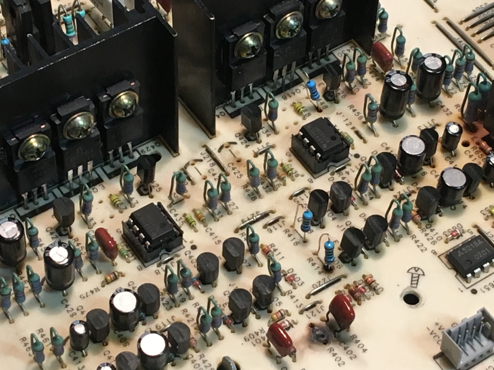

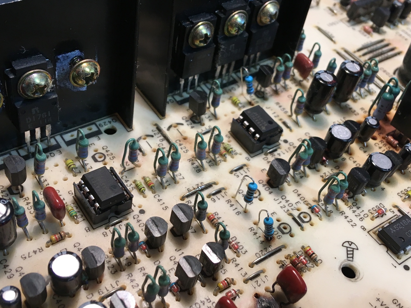

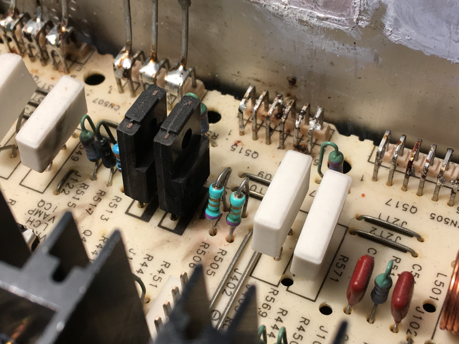

I finally got to do something here.
I have done some cleaning under the board, and I have now installed:
I actually got hold of some Sn/Pb solder it is a little better to use, i agree.
New IC402
Q401
Q405
new R506
resoldered R505
Soldered in socket and inserted new IC401 (RC4558P)
Some overview pictures of current situation

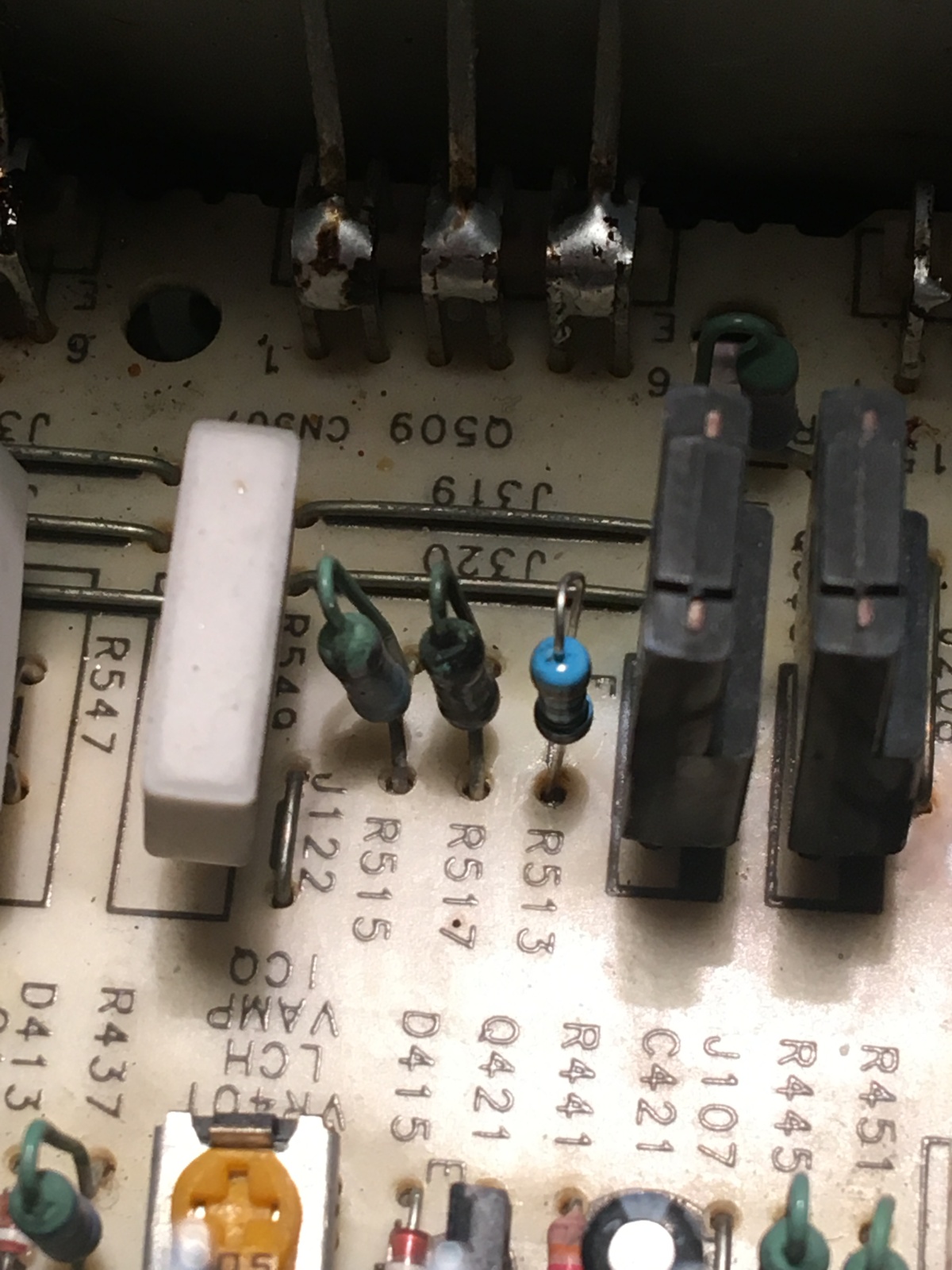

R517 looks discoloured or is that just the lighting in the photograph?
Install new
Q425, 2SA1123
Q427, 2SC3944 power transistor
Q429, 2SA1535 power transistor
Q402, 2SA1123
Q406, 2SC2631
Q408, 2SA1123
Marius83
Joined Dec 28, 2017
423
Install new
Q425, 2SA1123
Q402, 2SA1123
Q406, 2SC2631
Q408, 2SA1123

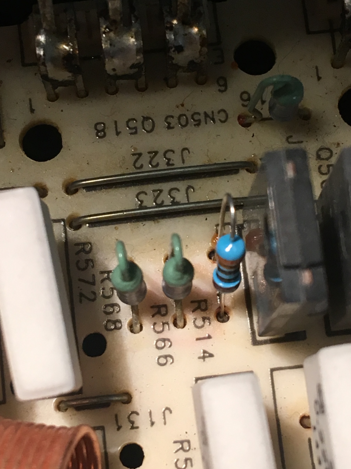

Yes, R517 is discoloured, because of R513 next to it has burned up twice or more.. hehe.
But i got curious and measured it.
Both R517 and R515 next to it, measures open circuit..:rolleyes:
I checked two other similar resistors on the other channel, (R566, R568) just to check that my meter was ok.
And they measure the correct resistance, so my meter was ok.

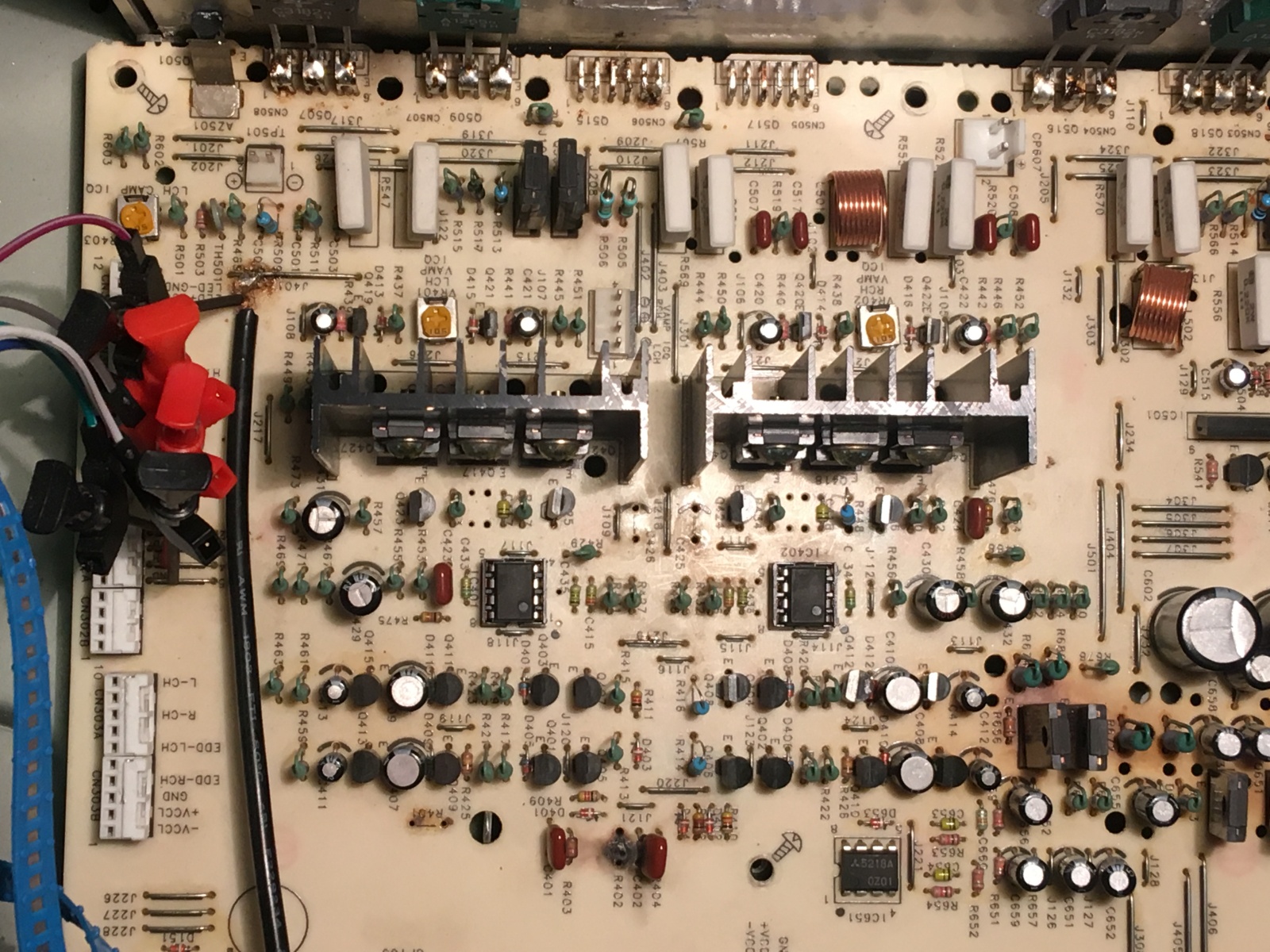

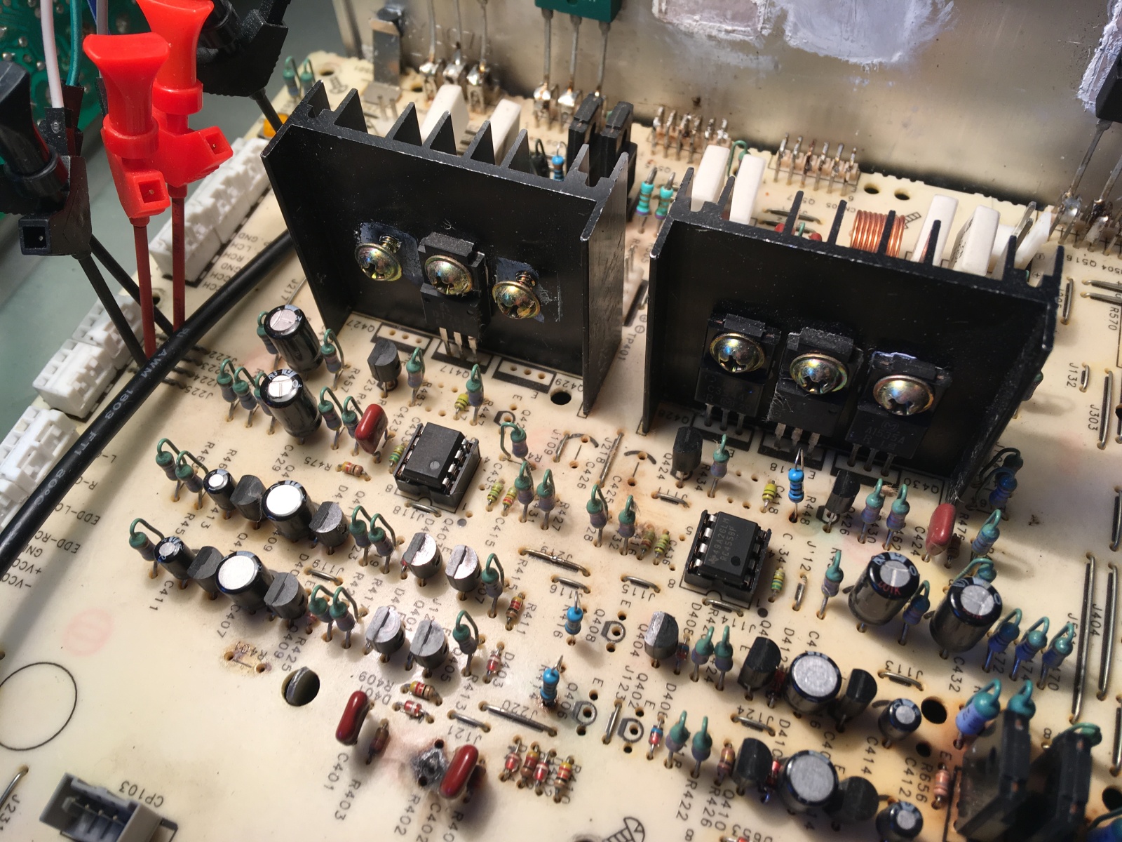

Then i installed:
new Q425
new Q427
new Q429
original measured ok Q402
new Q406
new Q408
Just some overview pictures of current situation again:
