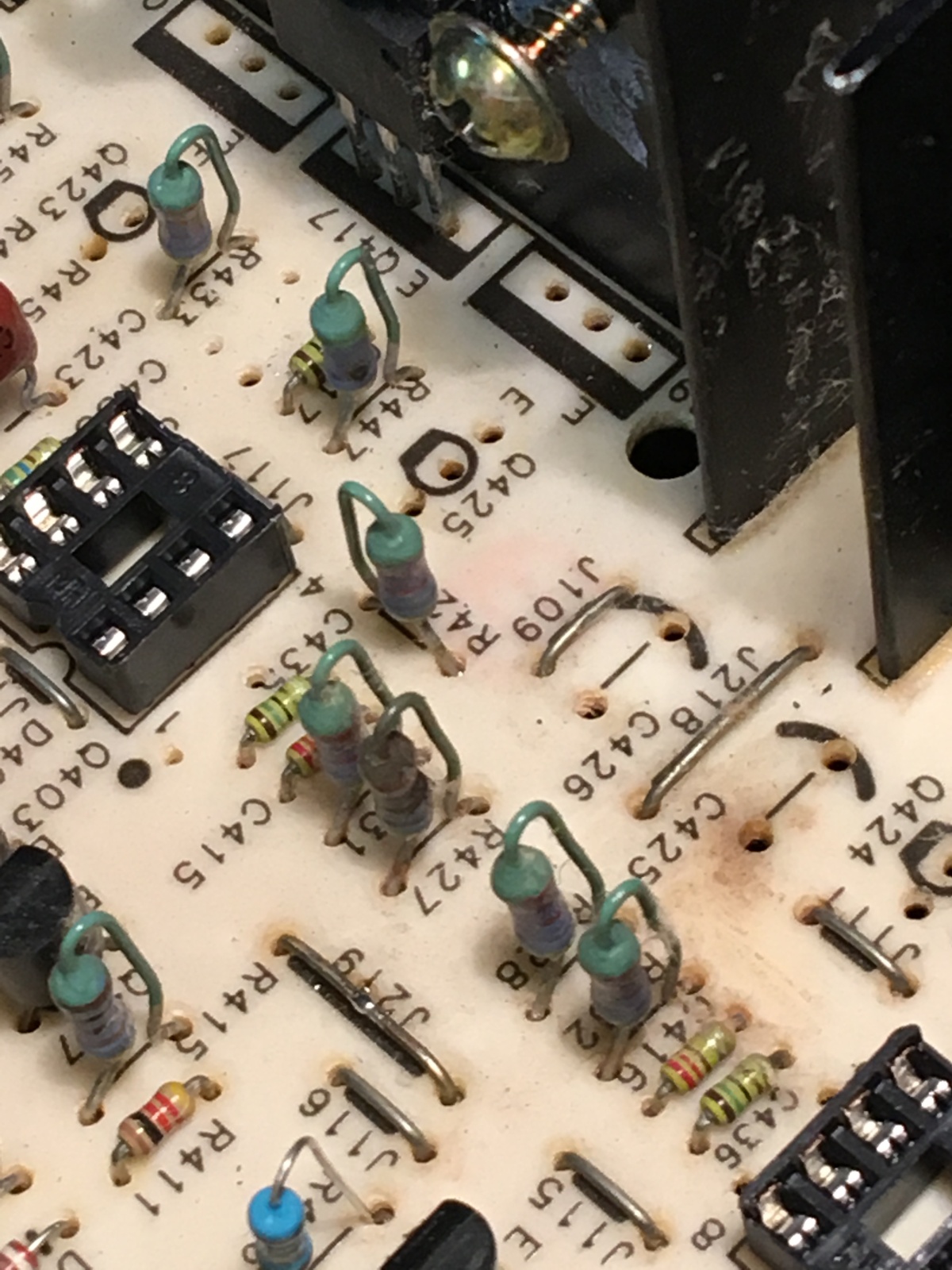

Then i turned power ON!
R506 burned up immidiately.
I felt it was humming a bit, like something was using power, and there was slowly coming smoke from somewhere else, i did not see exactly before i turned it off.
But when i took a closer look, i believe the smoke were coming from R427... it seems to have been hot..
So since it was slowly smoking i did not take any measurements.:(

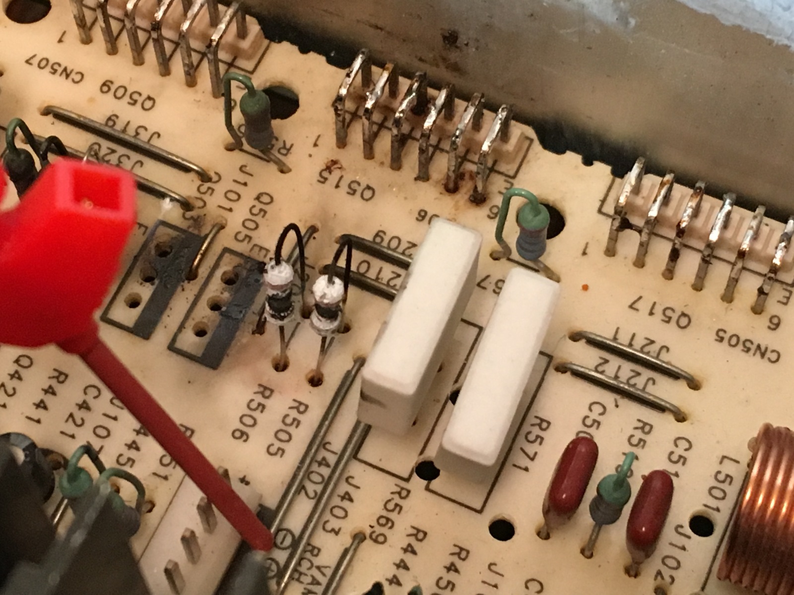

Finally got to do something here.
I removed Q428 and Q430 marked and set aside.
Replaced R505 and R506 with 100Ω 1/4W resistors
I just looked at the two power transistors... Q515 and Q517.. i tested Q517 in circuit.. then i removed it.. it has a short in every measurement.
I also removed Q515.. this tested OK.(!!)
So now these are off the board too.
Then i connected my DMM between GND and J402 (200VDC) and turned power ON.
I did not get any reading.. R505 and R506 went up in flames instantly and the voltage dropped to almost nothing.. and i turned it off.
I feel like every component we install in the LEFT channel gets burned when we turn the power on, every time.
Q517 was installed new just recently...hmm :(

Looks like a new short has developed across the power rails. We will have to find the short with the power off and cable unplugged.
Remove the charred remains of R505 and R506.
Use the DMM set to Ohms and measure between J402 and J401 - both ways.
Do the same with J403 and J401.
