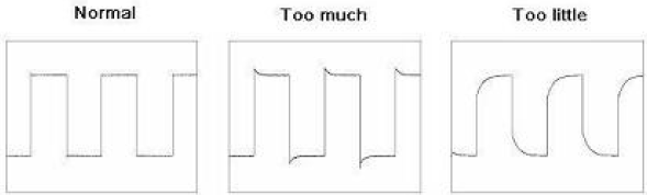

There should be a small trim capacitor on the body of the scope probe. Adjust this until you get square waves as shown as Normal in the left drawing above.

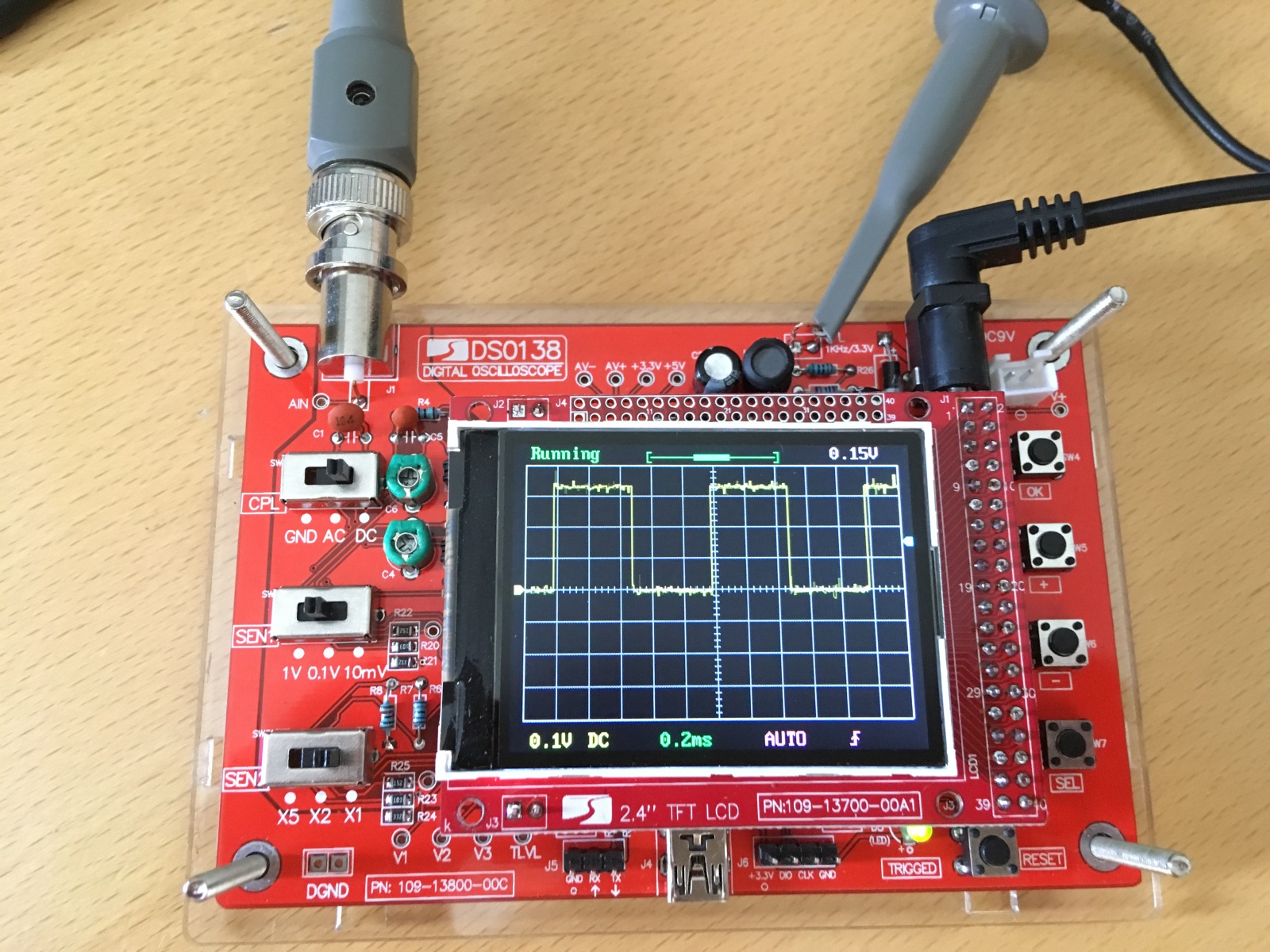

I have not adjusted the oscilloscope with the probe it came with....
I tried with my x10 probe now, it's a little screw at the BNC connection as you said.
Here is the best i can get by adjusting on the probe!

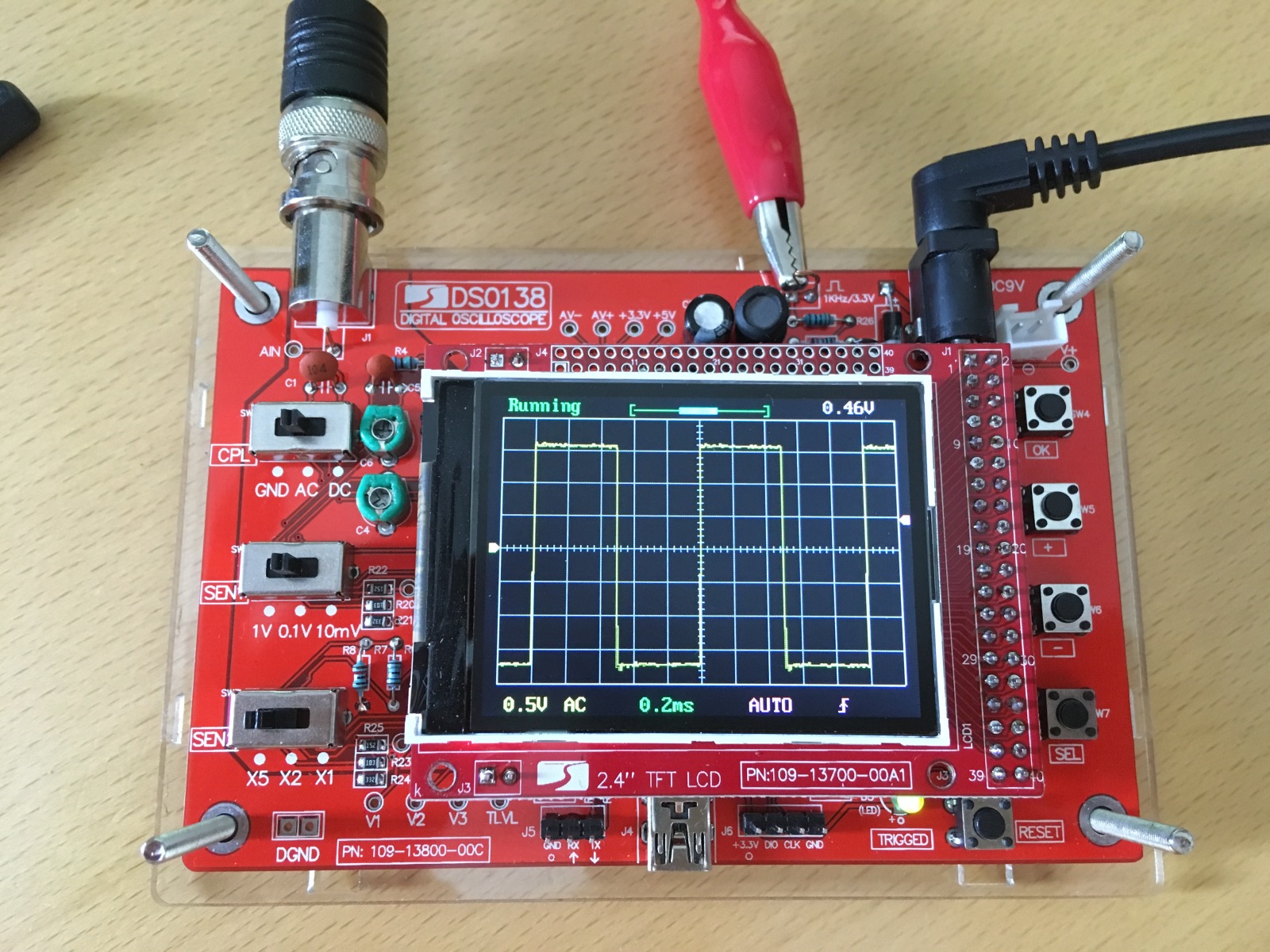

You need to do it with the probe that came with it as the adjustment are on the scope board.
Only then can you do the x10 probe.
Look at your manual. It's there. If you have any questions after reading it, let us know.

So i did what was described in the manual, i had to disassemble the acrylic case to get to C4 and C6... hehe.:)
Heres the best with the original probe...

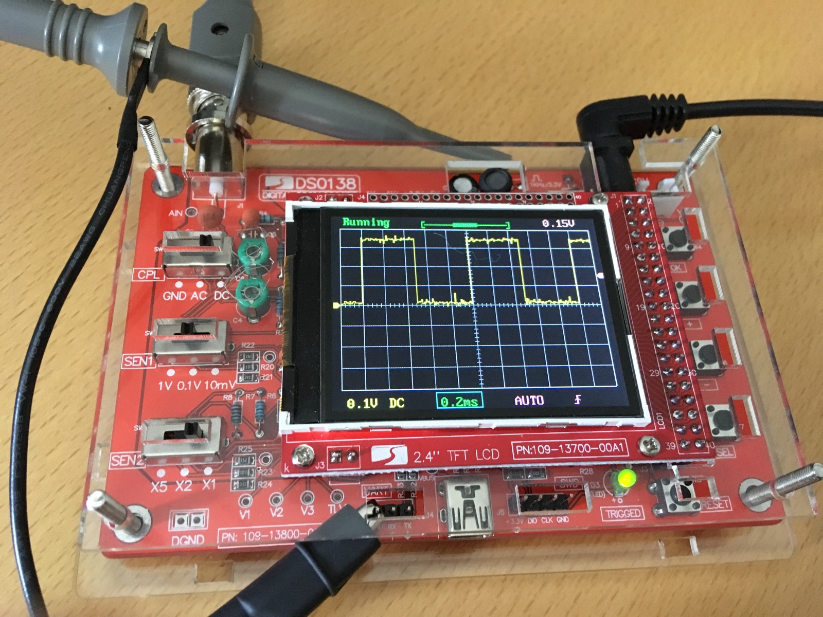

And here's how it looks like with my new X10 probe now..

Nice job. Some noise spikes are visible. Connect the ground of the x10 probe to ground. See if that eliminates the noise spikes. If it doesn't, Do you have florescent lighting? If you do, turn off the light to see if that's the noise source.

Don't worry too much about the spike noise that is being displayed. I have several of these units and they all show a noisy signal when the timebase is set to 0.1mS, 0.2mS & 0.5mS. It appears that the noise is either an A to D conversion error or a straight up aliasing problem. The noise level does not change with variations of the input attenuator. Just remember that it is a very cheap oscilloscope (which actually does work very well for what it is) and may have a few limitations.

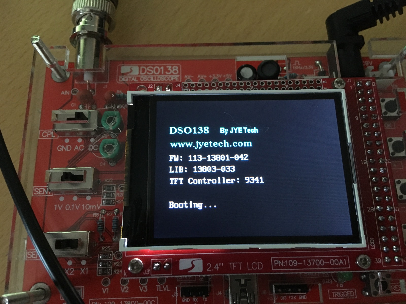

Mine does not display that information @Slowpoke101, i tried with the hold button, but it just goes in an out of hold and running, no other text.
@JoeJester, do i need that firmware to do my measurements? I have 113-13801-042
The firmware in your scope must be of a different version to what is in my units. When mine get back to the workshop I will check what version is currently running in them. So not to worry that the HOLD additional feature is not on your unit as it still works as an oscilloscope.

I would like to upgrade the firmware, i thoughti could use the mini usb(?) port on it, but i saw a video online this guy used the three pins aside it. and a little circuit board with a usb connector to connect it to a pc. i don't have that pcb board with usb connector.....
Could we do the measurements to my amplifier without upgrading the firmware, JoeJester? Or do you think it mandatory?
