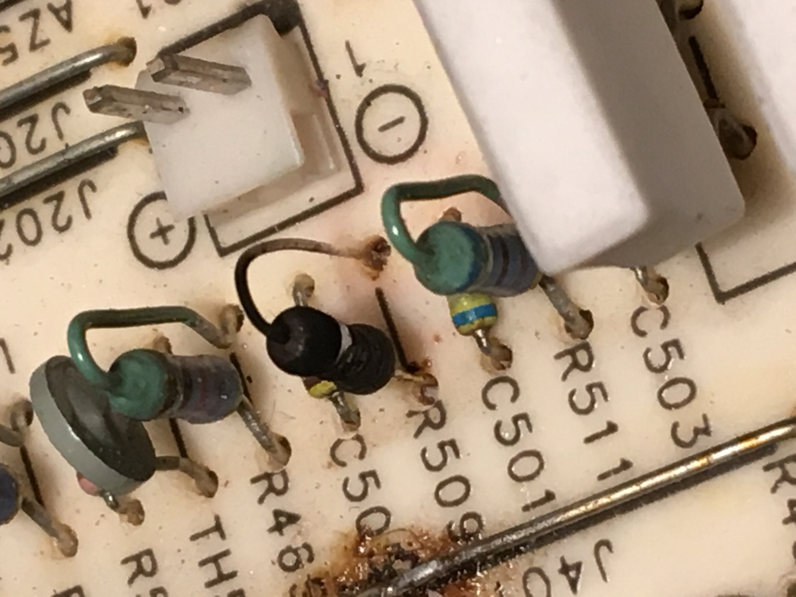

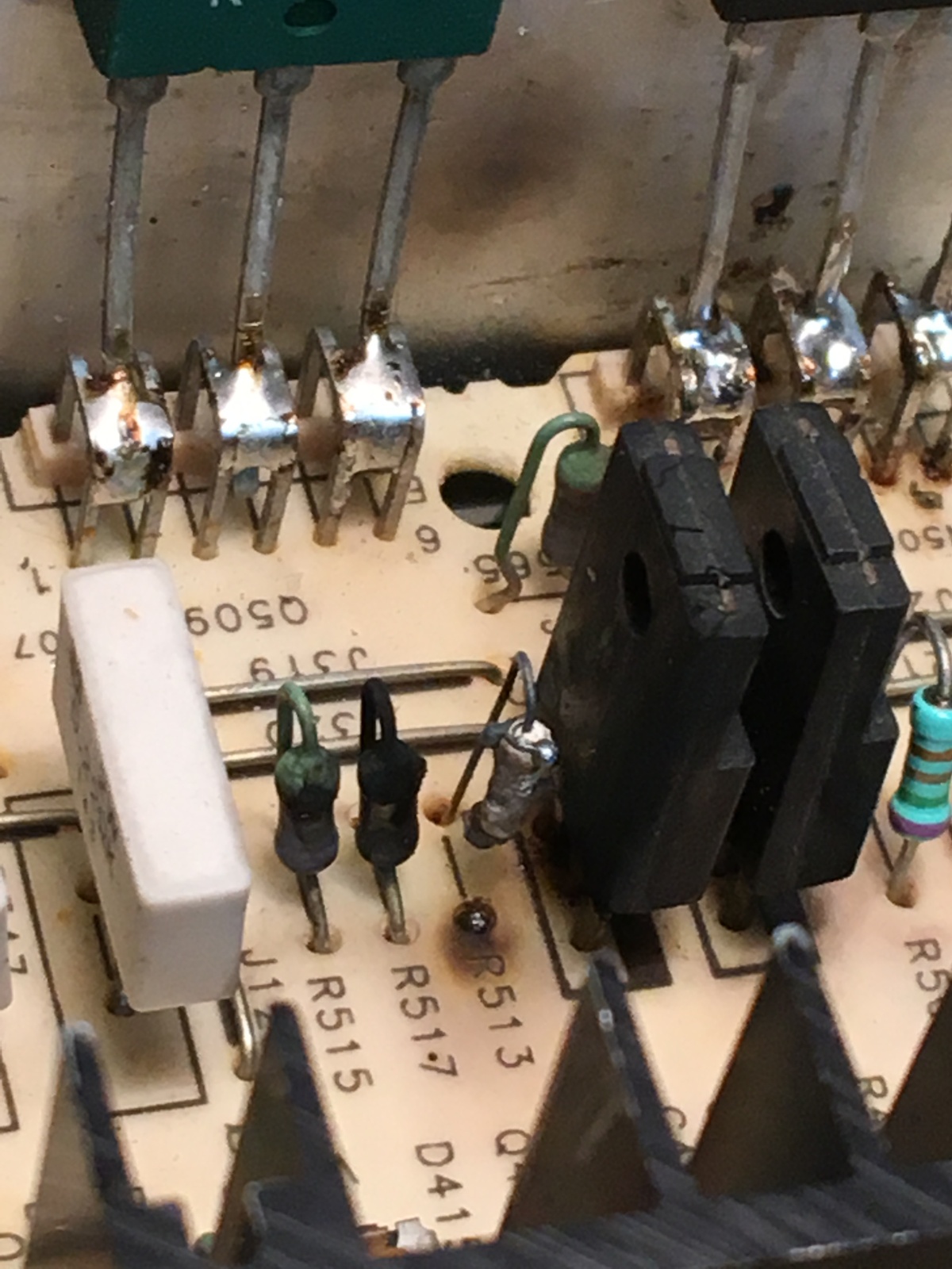

So i installed:
New Q515
New Q517 (even the one removed, tested ok in #73)
Power on!
R513 had literally a meltdown :eek: and R509 was glowing..
I turned off power after a second or two..

Just thinking, this is just the same that happened when i at first made the mistake and was trying to measure voltage at R505 when my wire leads was set at ampere measuring, could the fault i caused by making connection between GND and R505 still be there... like a component we haven't touched yet.. ..?
You know best, i was just thinking :)

There are lot of possibilities, considering how much abuse we've put that amp through.
It is possible that R515 and R517 were blown a long time ago and went unnoticed.
It appears that Q503 has gone bad.
How difficult is it to test Q501?
I would remove Q503 and Q505 and do a power ON test.

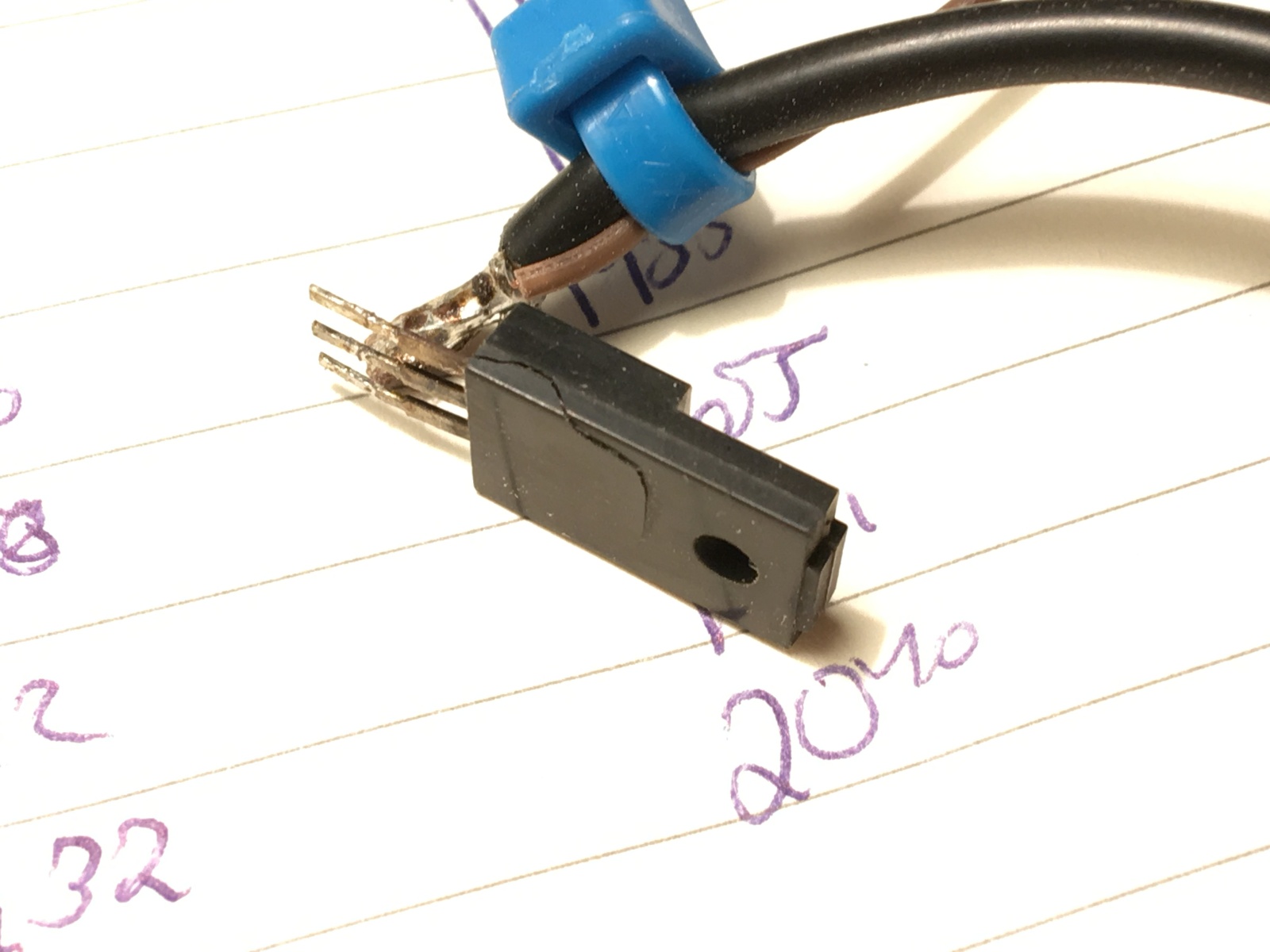

So i finally removed Q501, Q503 and Q505
So i would say Q503 and Q505 is bad... again(?) have i tested these earlier or did i just take them out.. hard to remember .... Q505 has also cracked! :confused:
Q503
Red to B
Black to E: 86
Black to C: 80
Black to B
Red to E: 89
Red to C: 86
Red to E
Black to C: 5 (short)
Black to E
Red to C: 6 (short)
Q505 DMM beeps (short) on every test

Yes, your pinout for Q501, 2SC1815BGL is not correct.
Your tests do not indicate a failed transistor.

So then Q501 is ok.
What could have killed Q505 and Q503? Is there anything else i should test before we replace them?

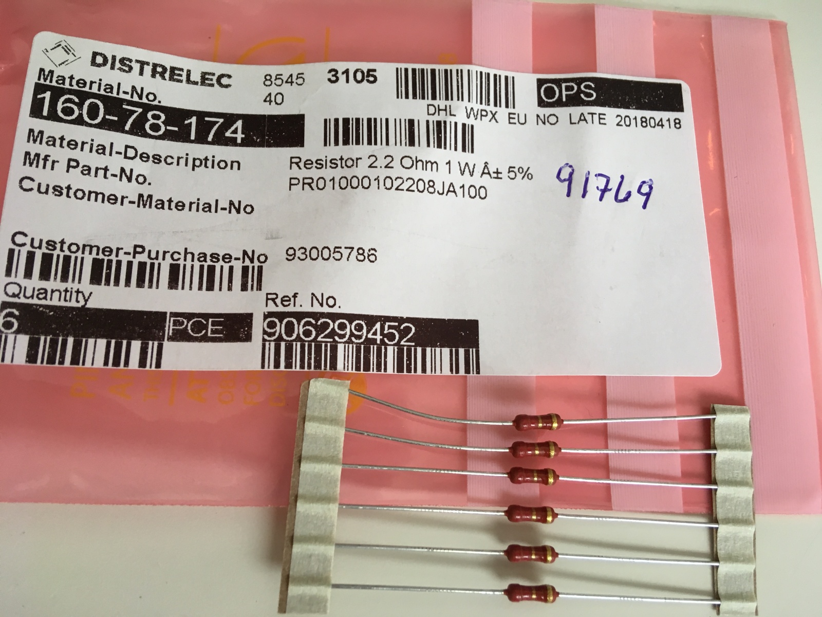

I was at the local guy and ordered some 2.2Ω resistors, i specified they should be 0,25W.. but when they arrived, he had ordered 1W instead, he said there was no use for such small resistors as 0,25W....probably so small because of the price he said..:rolleyes:
But when the resistors possibly can burn up, we could cause larger damage with installing bigger resistors or what?o_O

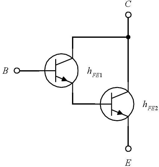

Q503 and Q507 are configured in a way similar to a Darlington pair.
Why they put such low value resistors between the emitter of Q503 and the base Q507?
Normally the emitter of the first transistor is connected directly to the base of the second transistor.
The only reason I can see for putting the resistors in is so that they are able to drive two output transistors at the same time.
Why the resistors blew?
If a catastrophic failure caused both transistors Q503 and Q507, or Q505 and Q509, to fail at the same time.
Assuming a beta about 35 for Ic at 5A, the base current is about 140mA.
A 2.2Ω ¼W resistor is rated to carry 300mA.
Going to a 1W resistor increases the current capacity to 700mA.
There is no harm in using the 1W resistors. They will still blow if the transistors fail.
