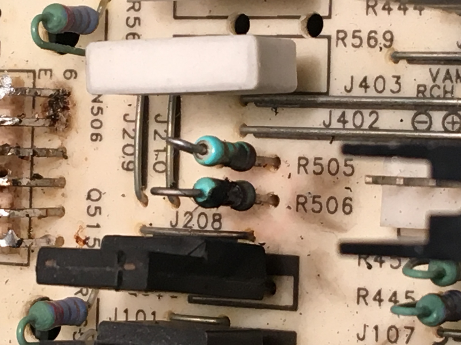

hehe... what could have gone so wrong suddenly...it's like it's 60 everywhere :confused:
R423: +64 / +64 Volt
R424: +64 / +64 Volt
C426: +64 / 0 Volt
R506: -64 / +64 Volt
Marius83
Joined Dec 28, 2017
423

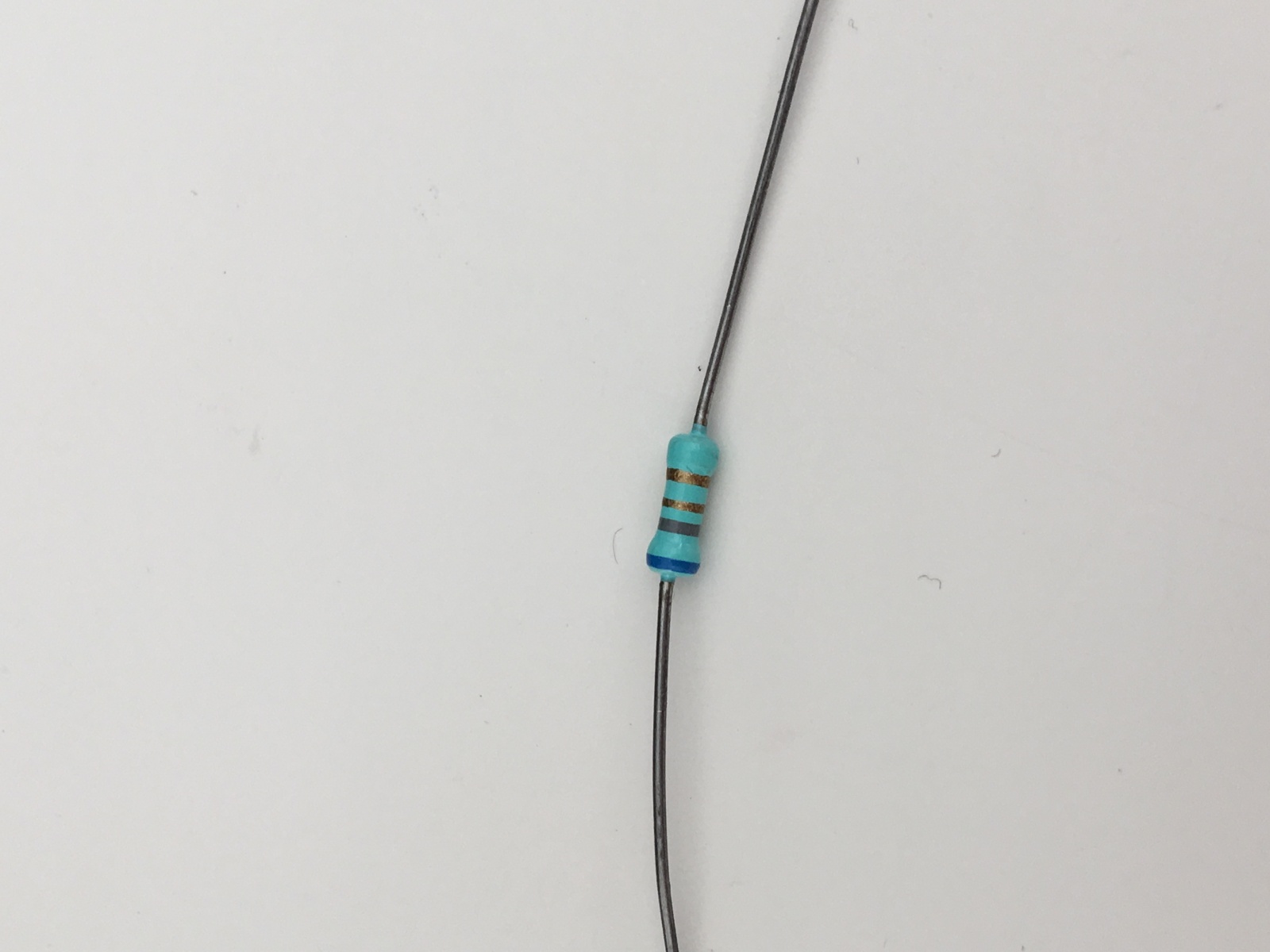

So i removed R506, measured, it is open circuit...
I actually have a replacement, i believe it is a 6.8Ω ¼W, i bought two when i earlier replaced R505
See picture.

Keep that in mind next time you need to get more parts.
Replace R506.

Ok i leaved the hook-up with 100kΩ installed.
So i replaced R506 with my replacement 6.8Ω ¼W.
Power on!
R506 fried instantly.... so i did not do any measurements..:oops:
