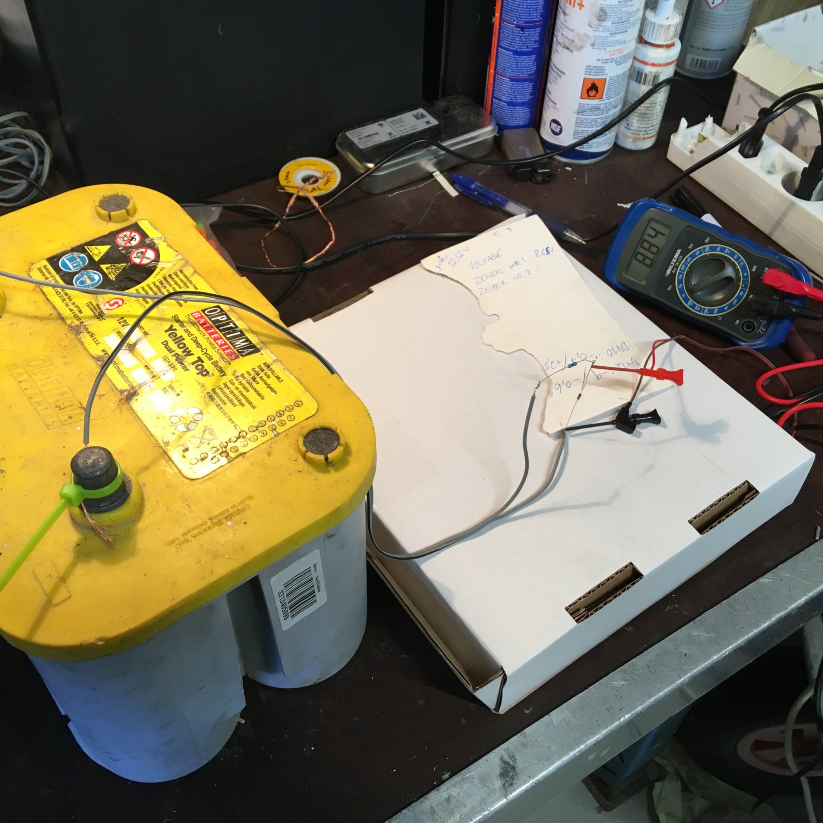

I am thinking of testing the remaining zeners you have at hand with something like this:
With a 12VDC supply feeding two 100Ω resistors in series into the zener, you can measure the zener voltage at 20mA = ( 12V - 8V divided by 200Ω).
Or 10VDC with one 100Ω resistor in series will deliver the same 20mA = (10V - 8V divided by 100Ω).
Also in the same test, measure the original D410 that was removed from the board.

I have this amp outside in my garage, it is kind of cold outside, so i let the amp sit on for like 10 minutes and measured the installed zeners again today. Don't know if it was necessary but this was the result:
D410: - 0.7 / + 7.5 Volts
D412: - 9 / - 0.6 Volts
I went outside to measure the zeners.. either i've read wrong or you have edited your post, because i only used one 100Ω resistor in my test.. :)
If it's not okay, i'm just doing it again with two resistors.
I used a 12V battery for testing, checked the voltage on my battery under the "load" if it would make a difference.

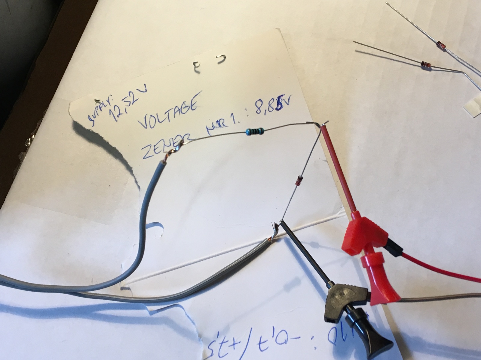

I have three spare new zeners, and i let them stay connected some minutes, because the voltage seemed to variy a little in the beginning.
Zener 1: 12.46V battery : 8.87 Volts
Zener 2: 12.45V battery: 8.77 Volts
Zener 3: 12.44V battery: 8.60 Volts
The removed original D410: 12.44V battery: 8.60 Volts
The removed original D412: 4.02 Volts.. :D
Don't look at the values in picture 2. it changed.

Sorry. Yes, I did edit the post while you weren't watching. Not to worry. Your tests are still meaningful.
With a single 100Ω resistor, you are testing the zener diodes at 40mA with a 12V battery.
With 200Ω in series, the test current will be at 20mA with a 12V battery. The zener voltage will be different at the different currents but this will still give us some idea of the variations.
Your results for D412 of 4.02V is alarming. Could this be an error in the measurement or transcription?
In any case, install the D410 just removed (tested at 8.6V).
Install Zener 3 as D412 (tested at 8.6V also).
