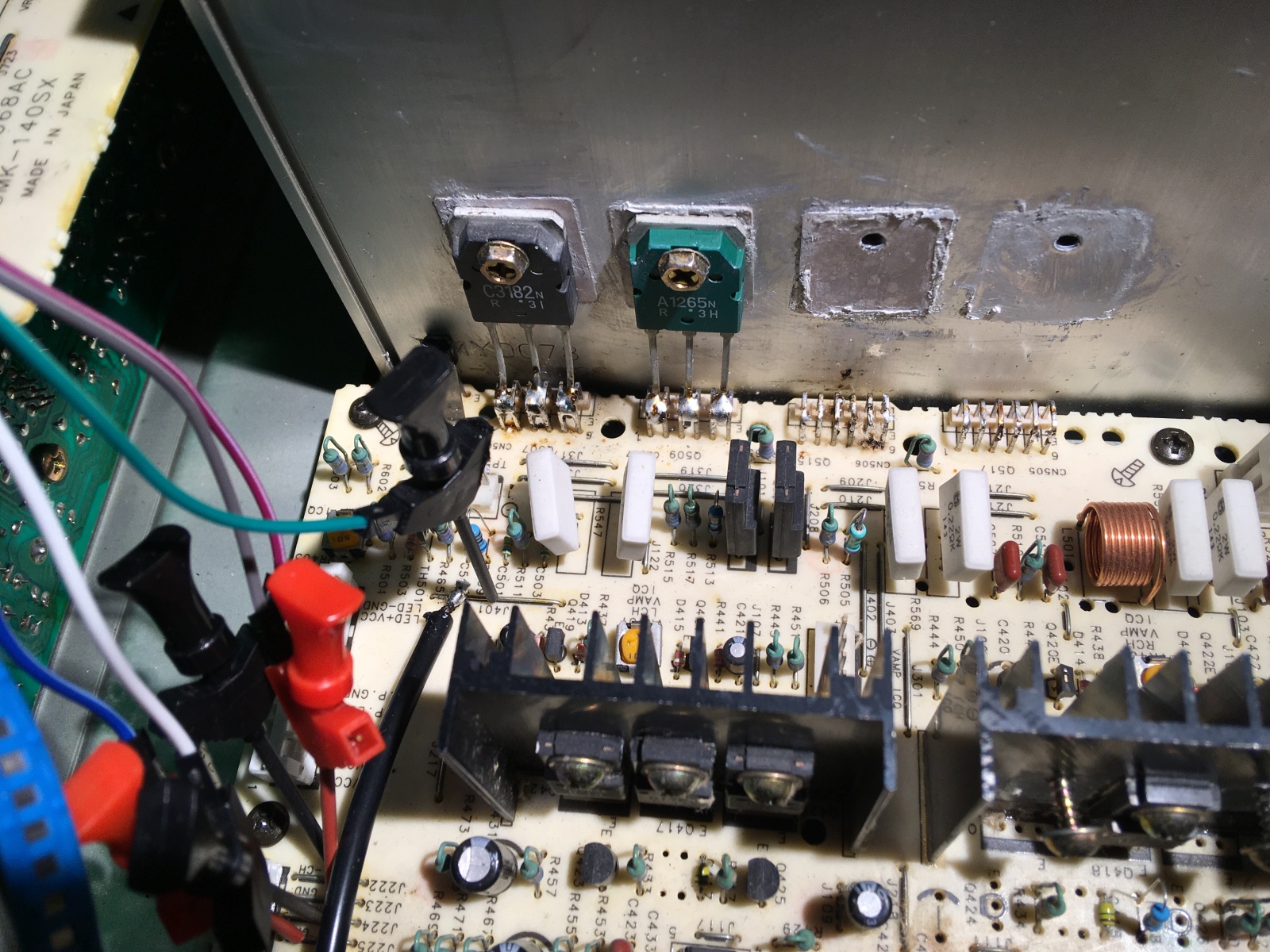

@pvanb, thanks, it's altso metioned earlier in this thread, but as i understand it will not work very well in this case.
@Mr.Chips:
So i installed, Q501, Q503, Q505 , and i have replaced R513 and R509 earlier.
Power on.
No smoke.
Measuring R513: +5,4 Volt / +4,2 Volt
So i did not proceed with installing Q507 and Q509

Ok, sounds good.
Make a note of how R401 is adjusted, i.e. the position of the yellow pointer.
While measuring the voltage at one leg of R513, adjust R401 fully counter clockwise (CCW) and the fully clockwise (CW).
Record the two readings you get.
See if you can find a position of R401 when the reading at R513 is somewhere between +0,5V and -0,5V.
Ideally, one leg of R513 should be at +0,5V while the other leg is -0,5V.

So i hooked my DMM on to one leg of R513 and adjusted R401, there was no difference in voltage from fully CCW or full CW.
+5,4 Volt the whole time i was turning it.
And the other side was +4,2 Volt.
But i could hear the 50hz humming was getting stronger at full CW, from almost quiet full CCW, so something is happening :)

+5V is too high. We need to find why that is the case.
Set R401 to the mid-range.
Please measure voltages at:
R453
R455
R457
R461
R467
R471
R473
R501
R509
R511
Measure the voltages at the two pins on TP501.
Connect either pin of TP501 to GND (J401).
Repeat the voltage measurements on the resistors above.
(Sorry for all the work I 've given you.)

As i understand, i was going to connect either pin on TP501, but i don't dare until you see what i measured first.
The pins are also marked with + and - ... so which one? Doesn't matter?
My measurements, without connecting anything to one of the pins at TP501:
R453: 0 Volt
R455: 0 Volt
R457: 0 Volt
R461: +3,7 / -7,7 Volt
R467: 0 Volt
R471: 0 volt
R473: 0 volt
R501: +6,3 / +4,4 Volt
R509: +6,2 / +6,3 Volt
R511: +3,7 / +3,7 Volt
TP501:
+Pin: 0 Volt
- Pin: 0 Volt

Ok.
So i connected one pin (-) at TP501 to GND
New readings:
R543: 0 Volt
R455: 0 Volt
R457: 0 Volt
R461: -6,7 / -7,6 Volt
R467: 0 Volt
R471: 0 Volt
R473: 0 Volt
R501: -6,4 / -5,5 Volt
R509: -5,6 / -5,6 Volt
R511: -6,8 / -6,8 Volt

Remove the connection at TP501.
Install
Q507 2SC3182
Q509 2SA1265 (new one, of course)
Cross your fingers and turn ON power.
Measure voltage at (with respect to GND, as always)
TP501 +
TP501 -
If you get 0V on both pins, and no smoke anywhere, breathe a sigh of relief. :D

Removed connection at TP501.
Installed
Q507
Q509
both new ones of course
Turned power on.
No smoke.
Measured the pins at TP501, 0 Volt at both ! :):)

That is very encouraging news!:)
We are making good progress here.
We will omit Q515 and Q517 for now. Basically, the LEFT channel is looking good at this point. We just have a few more tests and adjustments to make.
The next step is to wait for supplies to arrive and we can start working on the RIGHT channel.
