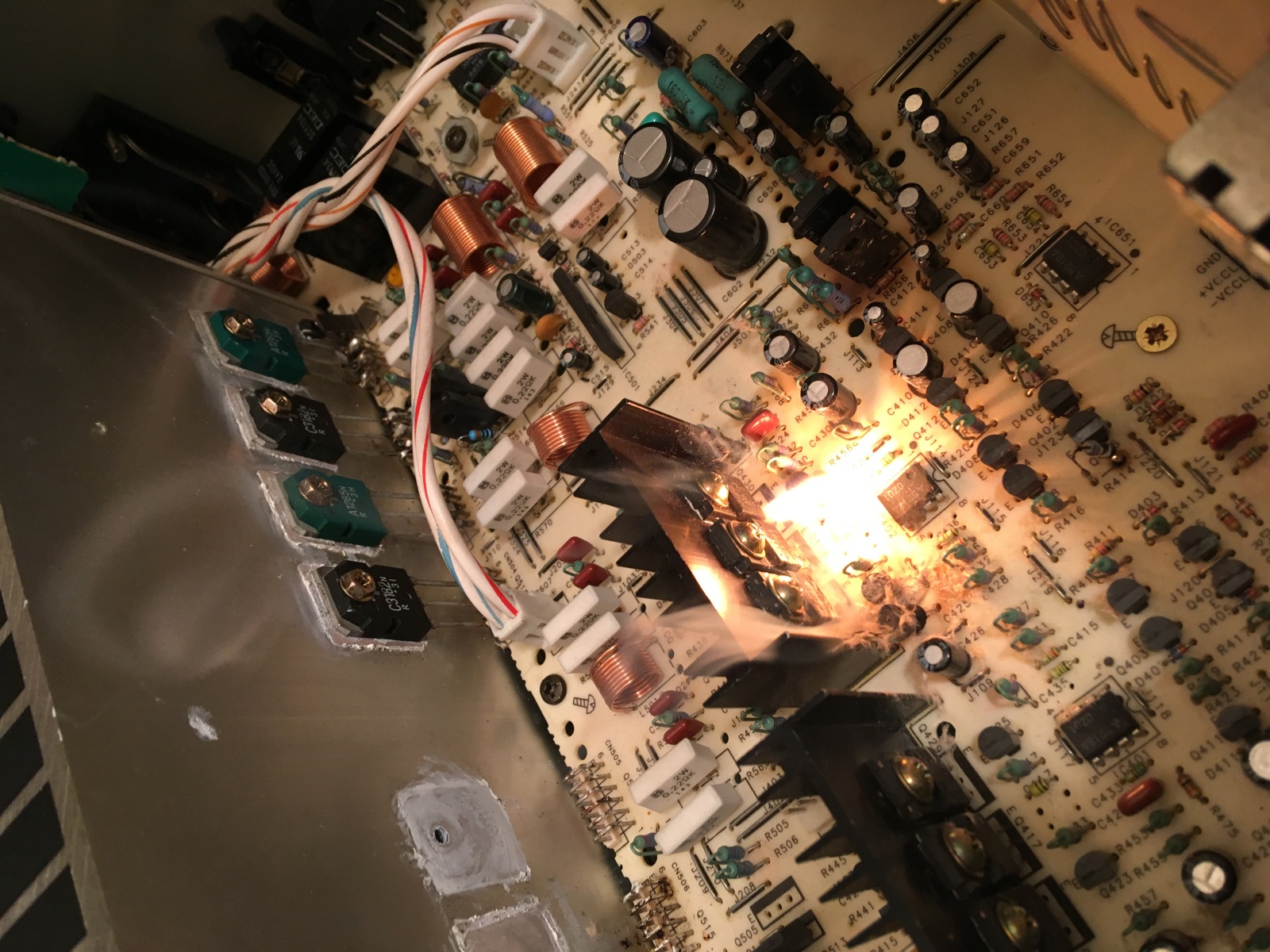

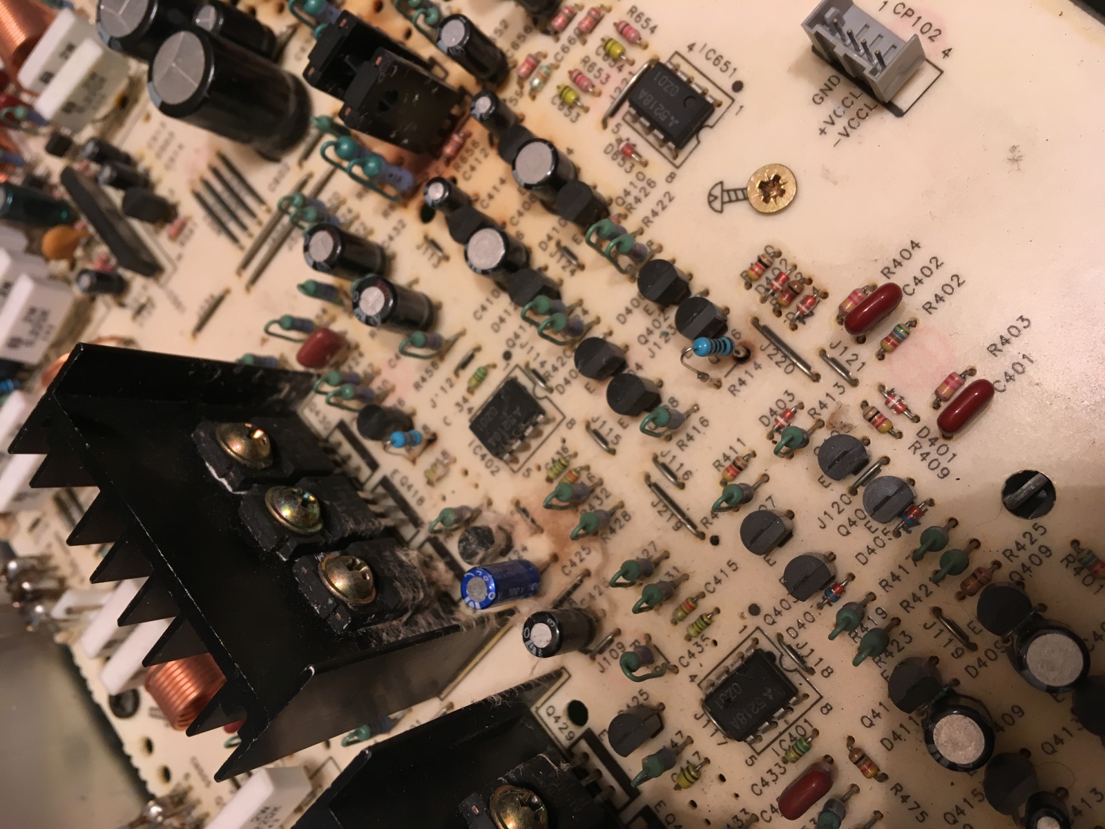

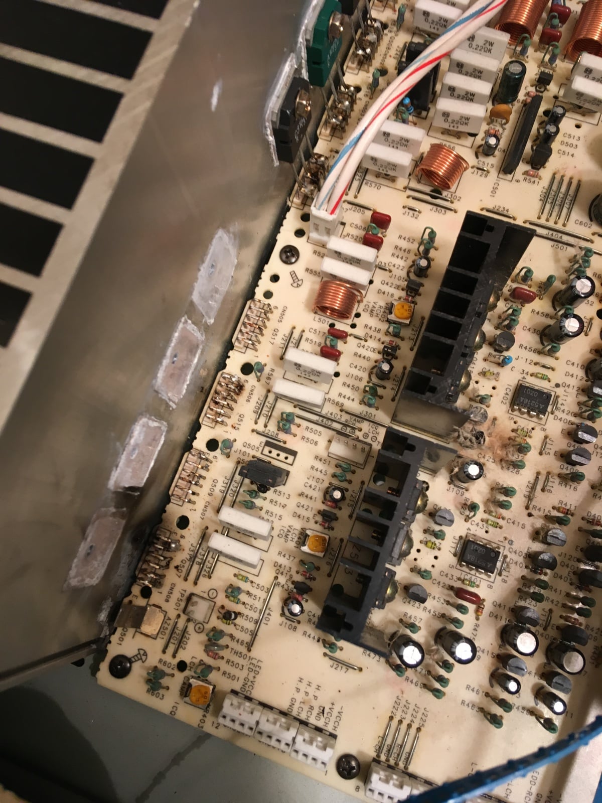

Those are beautiful photos. Actually, the two photos align up correctly as you wanted when viewed on my iPad.
Our objective is to do what it takes to stop smoking anymore components.
After that, we can move on to take voltage measurements. The correct expected voltages are well documented in the circuit schematics. There are still bad components on the board that result in the wrong voltages and blowing components. Each of these bad components has to be located and corrected before moving on.
For starters, C425 1μF/100V must be replaced.
Which flat cables at which connector have been removed?
If there was smoke coming from the front panel then don't plug those in yet.

@Dodgydave you are correct, my DDM leads were set to measure Amps:oops:
Happy the pictures turned out that way :)
There are three flat cables going from the main board to the front board.
You can see three white connectors in three groups to the right in the bottom picture.
Ok, I will leave them disconnected.
So I will now replace C425 again.
But, when C425 blew up, R414 was smoking at first, should i replace it too?

Leave the flat cables disconnected for now. (Of course, the VOLTAGE CONTROL light will be off).
Replace R414 100Ω ¼W for now and hope for the best.

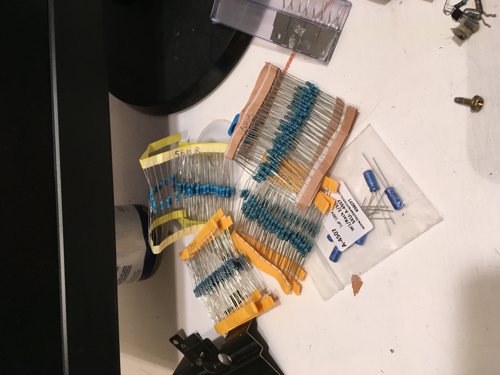

(How come you happen to have all the right parts available? Resistors, capacitors, transistors? Do you have fairly wide stock at hand?)

I do not have so much components, when i looked over the main pcb the first time i ordered the reistors,capacitors and transistor
i saw needed replacing.
I ordered from Ebay, and they sell in such large quantum and costs almost nothing.:)

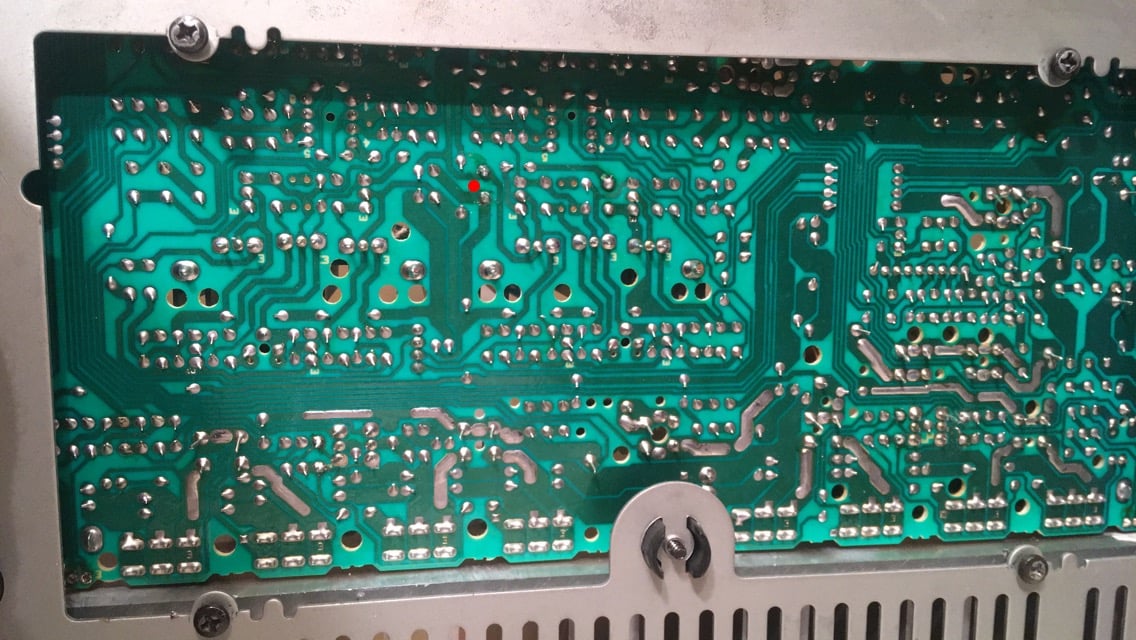

As for C425, we need to verify the proper orientation of the capacitor. The most likely cause for it to blow instantly is that it is installed backwards, i.e. with the polarity reversed. There is 60V applied across this capacitor. If it is backwards it will blow instantly.
Is it possible for you to take a photo of the underside of the board so that I can see how C425 is connected?

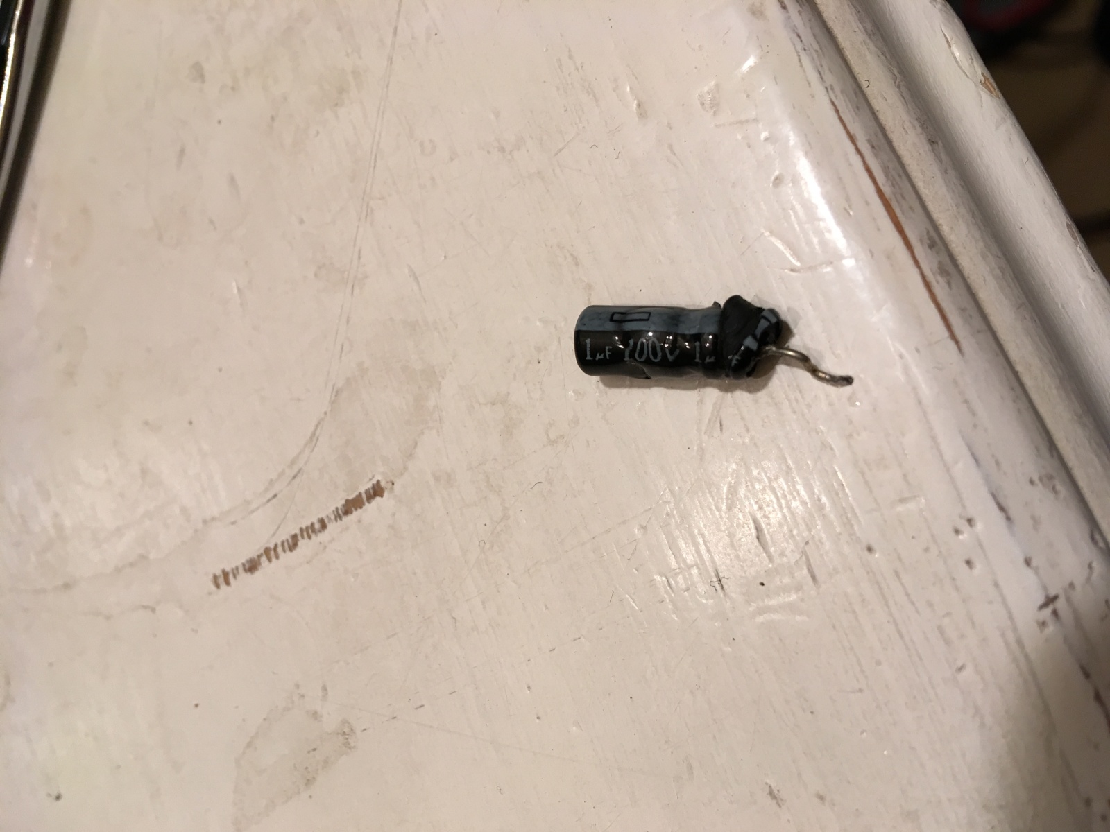

When it comes to C425, it's mounted the way the old one stood, the negative connector is shorter and marked with a grey stripe as you can see in my earlier pictures. Could it be marked the wrong way?
See the picture of how the original capacitor looked like, which I replaced.
I also took a picture of the underside on main PCB as you said, C425 is marked with a red dot between the connectors.
Negative connector will be to the right of the red dot in the picture.
If the picture isn't good enough I will take the test as you mentioned over.
Hello, I think the capacitor is reversed.
As you can see on the image of the underside of the board, C425 y C426 have a common terminal (-), so you connect the C425 reverse.

Edit: Disregard what I wrote below:
C425 was installed backwards. The -ve lead should be further away from the heatsink.
Strangely, C426 is also installed backwards. Why it hasn't blown, that I have no answer.
You would be wise to replace both C425 and C426. The +ve lead is closer to the heat sink for both capacitors.
C426 is on the -60V supply line. Hence its +ve lead is connected to GND, while the -ve lead of C425 is connected to GND.
I forgot that I was looking at the bottom of the board and the heatsinks have been flipped from the left to the right.
It appears that C425 and C426 are installed correctly after all.
Now we have to analyze why C425 keeps blowing.
