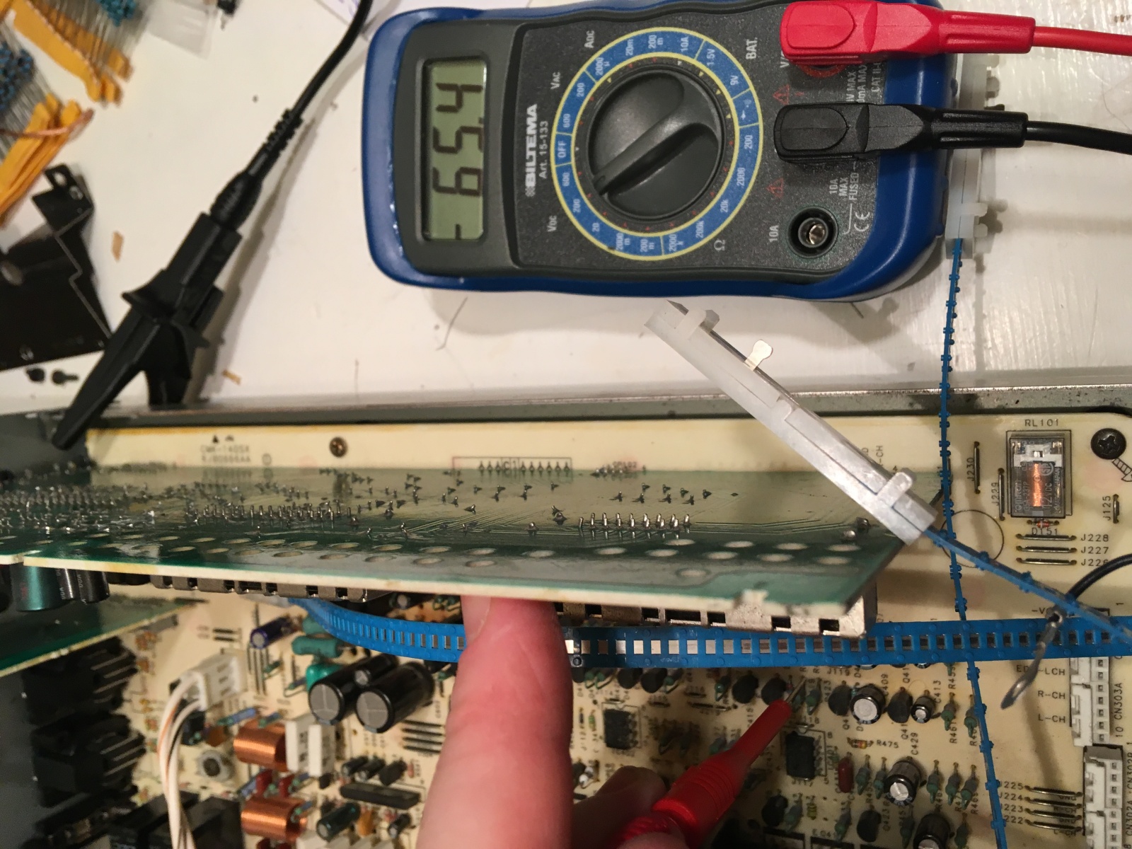

Some pictures of my test probe, i have a cheap DDM, but i hope it'll do the job.
Also picture of a measure taken at a resistor so you can see if i'm doing it right..?

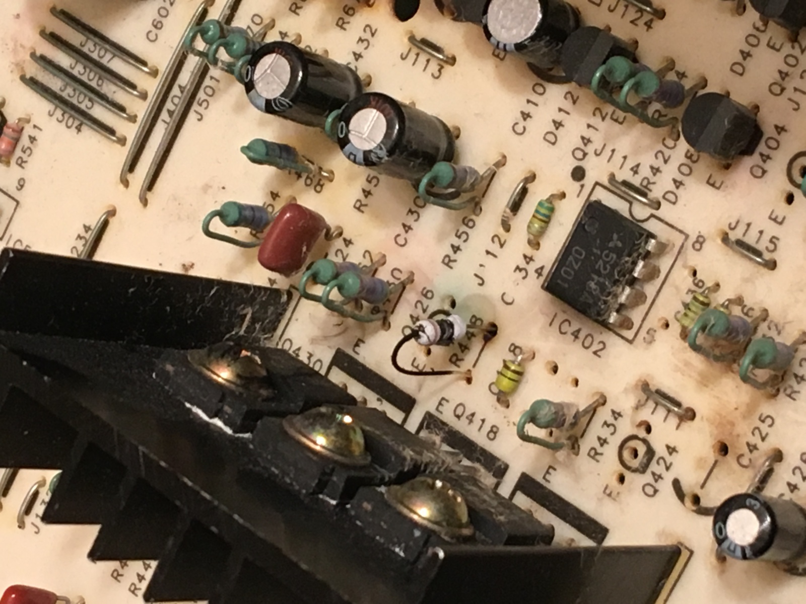

R448 went up in flames instantly. Nothing else.
R448 is 560Ω , right? Just to verify im doing it right.
hmm

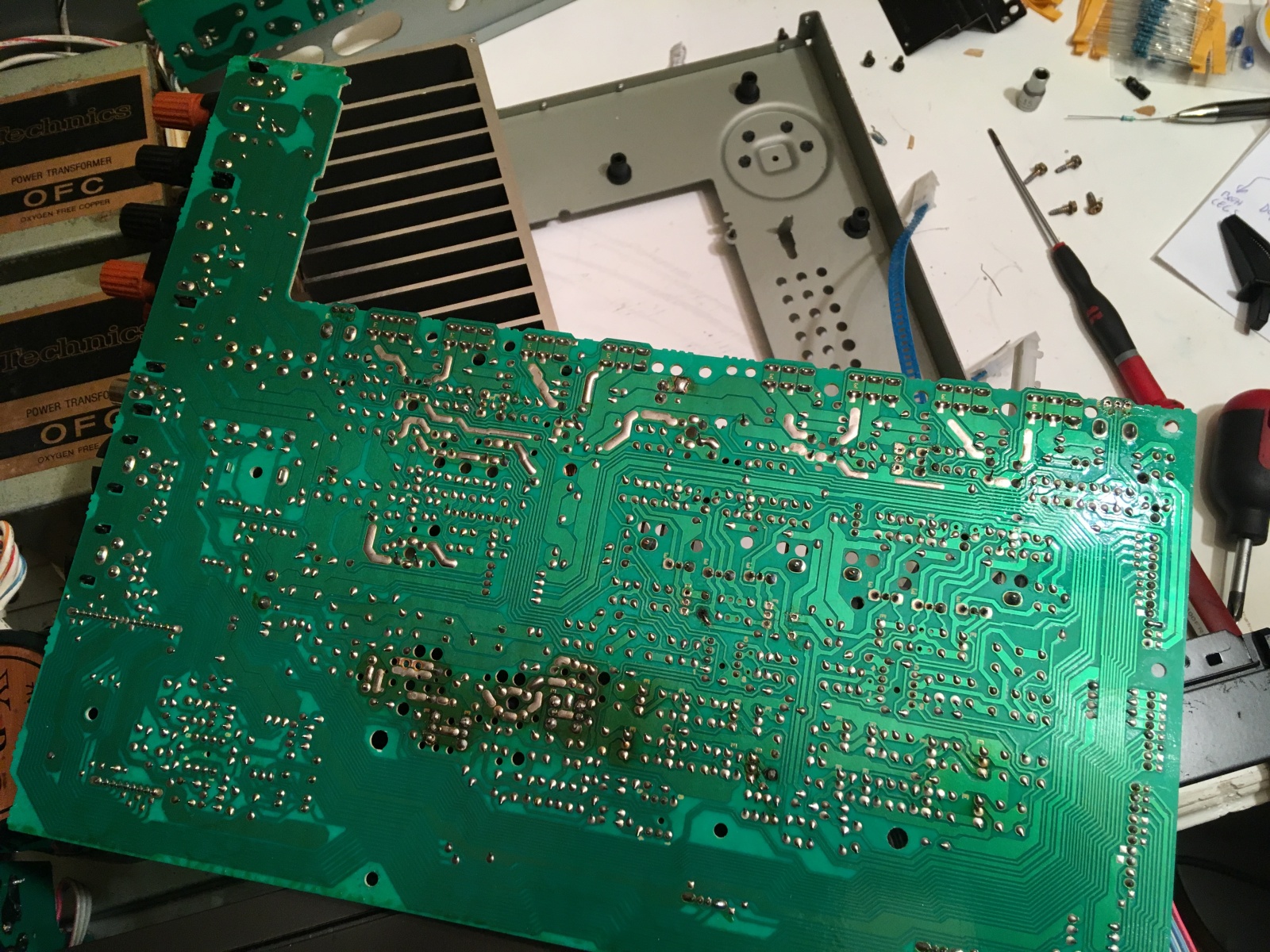

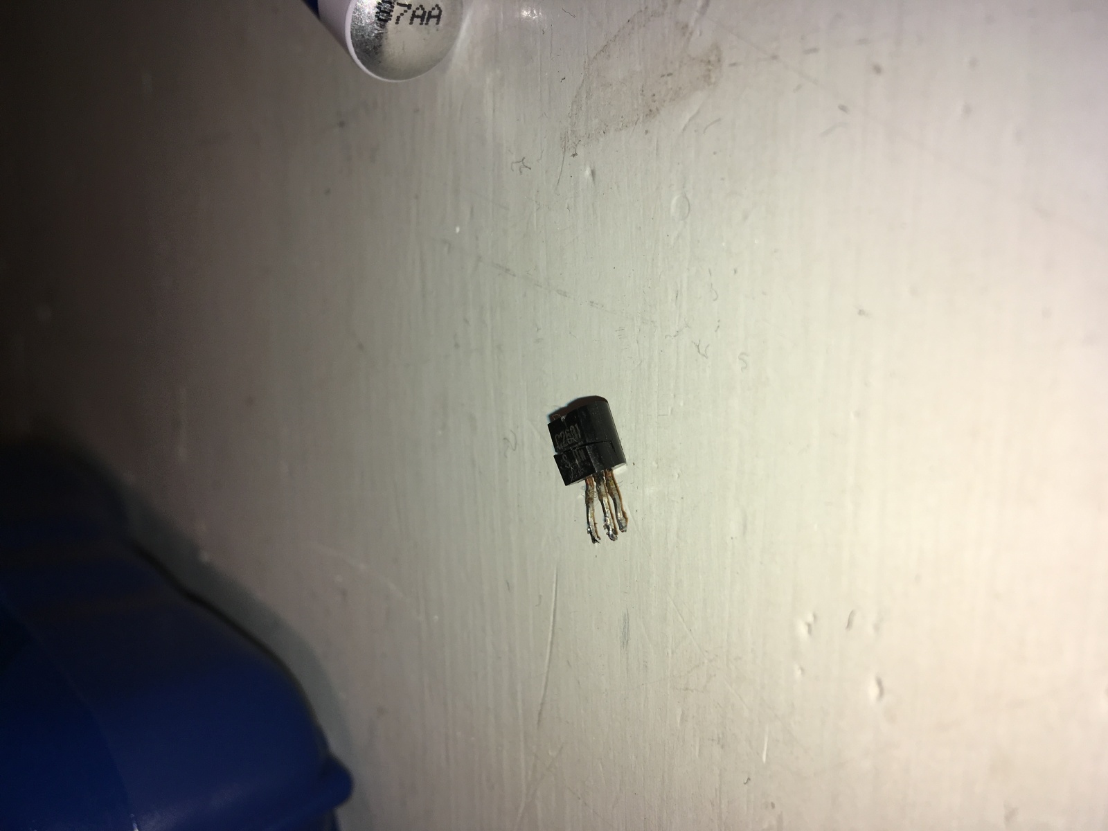

I noticed Q424 was damaged, it sits right next to C425, possibly it has cracked because of the "explosion" of the capacitor?:rolleyes:
The "service hatch" in the bottom of the chassi was not big enough to get to the components on the side
MrChips
Joined Oct 2, 2009
35,327
Check the solder joints under Q428 and Q430 for any shorts, especially between base and collector pins.
(E marks the emitter pin. The other two pins are collector and base.)
If everything looks good, Remove Q428 and Q430.
I am very certain these two are bad. I will show you later how to test these with your DMM.
Replace R448, 560Ω (assuming you still have spares, if not, you can omit for now).
Power up and check for smoke.:(

The soldering under Q428 and Q430 was perfect, no chance for a short.
Removed Q428 and Q430
Replaced R448
Power on..
No smoke!

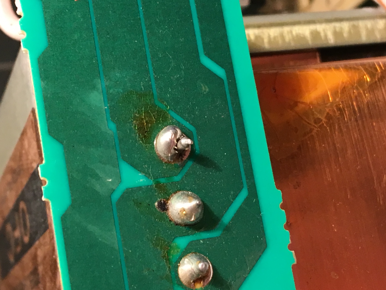

I noticed a bad soldering on one of the small PCB on the front transformator, which actually sparked when i turned it on.
I gues it has nothing with our problems to do. Just mentioned it.

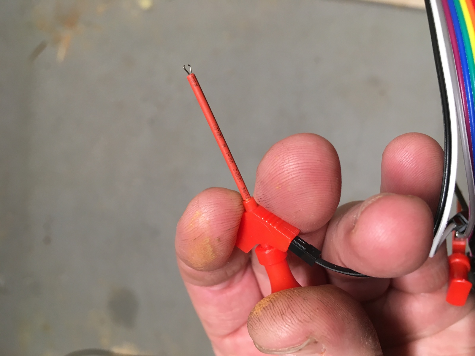

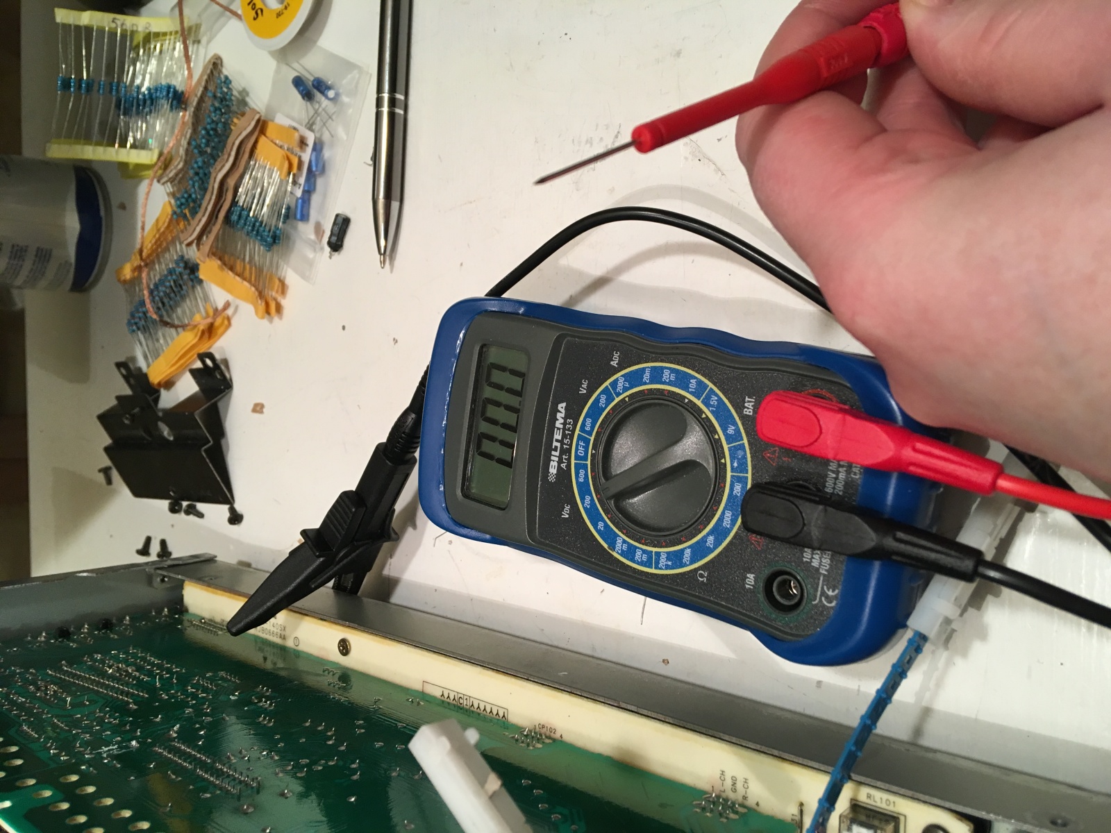

Now some comments about your DMM probes.
The long exposed tip on the red probe is an accident waiting to happen. I would insulate most of the metal part and just leave the tip exposed. Use a piece of heat shrink or the outer insulation from a piece of hookup cable and slip this over the tip.

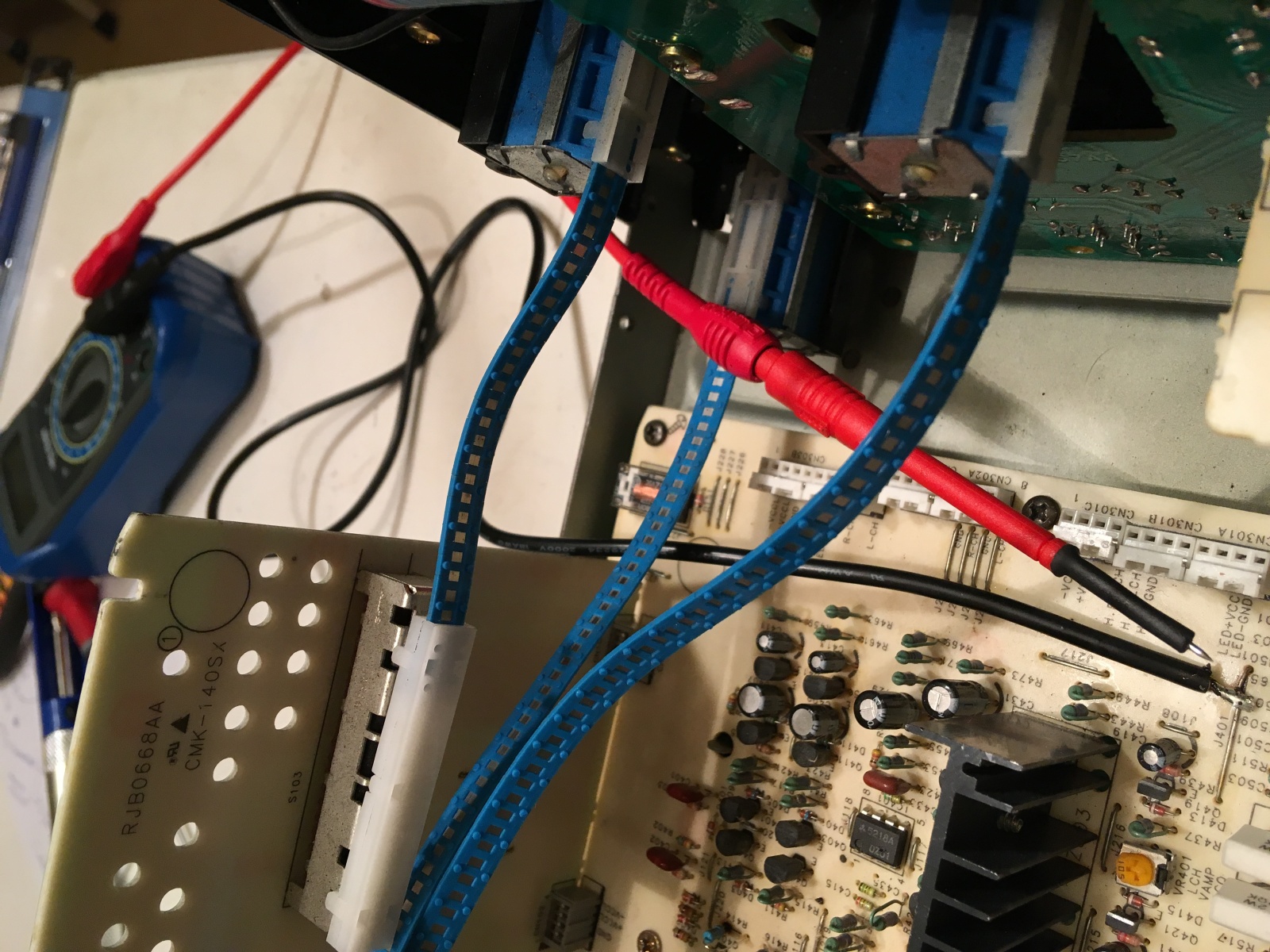

Your black grounding clip on the negative probe looks somewhat agape. To make sure that you always get a consistent ground, I suggest that you solder a length of insulated hookup wire to jumper J401, long enough so that it is not likely to create an accidental short. Then clip the black clip on to the end of this hookup wire.

Glad you like my photos, i'm not a pro :) i just have a good lamp which i move around and point to where i want it.. the photos are taken by my Iphone SE camera(12megapixel). It's a mix of a little zoom,(sometimes) and just to let the camera take it's time to focus on the right spots, and i almost never use the flash. Sometimes i can take many photos to get one good enough.
I took a picture of the bad factory soldering which sparked, just to show you, i have now fixed it.
I have also fixed my test gear after your recommendations. See picture in the bottom. :)

Measurements:
When i started measurements on left channel, it was first at 13 Volts, it was rising slowly all the time, and when i got to the last, it was about 17 Volts.
All the resistors measures the same on either leg.(except 425,426)
LEFT CHANNEL:
R401: -17 Vollt
R403: -17 Volt
R409: -17 Volt
D401: -17 Volt
R411: -17 Volt
D403: -17 Volt
R425: -63 Volt (Leg nearest heatsink) +63 Volt on the other leg
RIGHT CHANNEL:
R402: +35 Volt
R404: +35 Volt
R410: +36 Volt
D402: +36 Volt
R412: +36 Volt
D404: +36 Volt
R426: -64 Volt (Leg nearest heat sink) +64 Volt on the other leg
I ordered 10 mini grabbers from ebay which came in the mail today.
Really small ones :)

btw, nice grabber clips. Great for hooking on to leads. Make sure that you do not short adjacent components while hooking up to leads while the power is ON. It is easier to make all the measurements with the power ON. If there is any danger of creating a short, turn the power OFF between measurements if you must.
