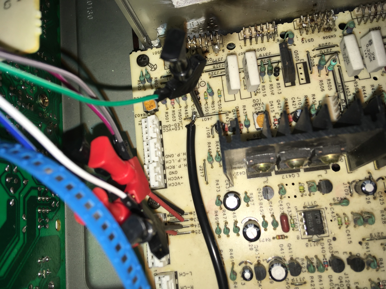

OK, i have now connected J222,J223,J224,J225 togheter with J401. CN302A still disconnected.
I have also checked that i have connection on all.
Soldered the wires from my mini grabbers togheter.
So here are my new measurements:
LEFT CHANNEL:
R401: 0 Volt
R403: 0 Volt
R409: +0,5 Volt
D401: +0,5 Volt
R411: -0,5 Volt
D403: -0,5 Volt
R425: -62 Volt on leg nearest heat sink, +64 Volt on the other
R413: 0 Volt
R415: 0 Volt
D409: +8 Volt
D411: -8 Volt
RIGHT CHANNEL:
R402: 0 Volt
R404: 0 Volt
R410: +0,5 Volt
D402: +0,5 Volt
R412: 0 Volt
D404: -0,5 Volt
R426: -62 Volt on leg nearest heat sink, +62 on the other
R414: -55 Volt
R416: -55 Volt
D410: -55/-46 Volt
D412: -63/-55 Volt
(I guess 0,5 Volts are equal to zero in this measuring?) but just wrote it anyway because i wasn't totally sure.

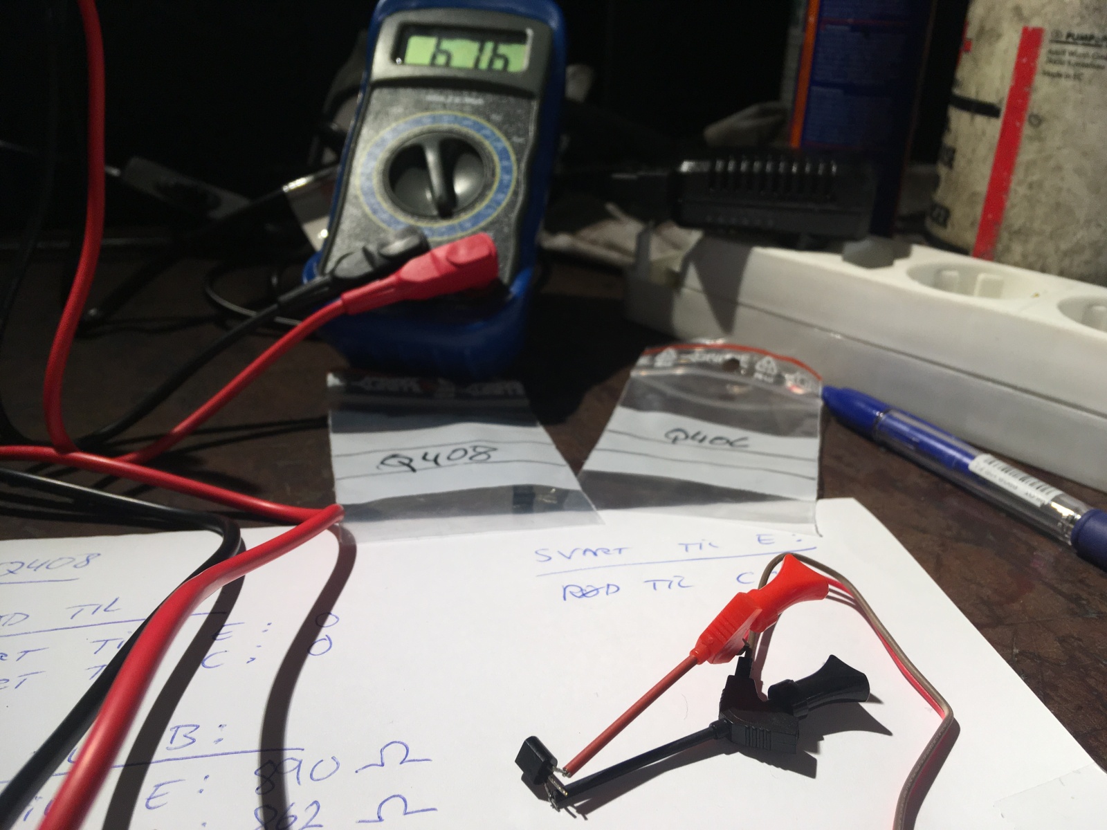

Sorry, i just didn't realize i had taken out Q406 and Q408, i thought it were some transistors who stood on the PCB, that's why i asked to take them out to measure, since you wrote "out of circuit".
I was not referring to the "shotgun" method you mentioned earlier, just a little misunderstanding.
I also know the components are listed in the parts listing, but i thought it was genuine Technics part numbers, but i see it's not.
Soo, i did measure the transistors the way you told me to, i made a mistake and thought at first my readings where OHM..
(as you can see in my picture:oops:)
Anyways, here are measurements:
Q406:
Connect RED probe to B.
Record DMM reading with BLACK probe connected to E: 668 mV
Record DMM reading with BLACK probe connected to C. 258 mV
Reverse the measurements as follows:
Connect BLACK probe to B.
Record DMM reading with RED probe connected to E. 950 mV
Record DMM reading with RED probe connected to C. 262 mV
Connect RED probe to E.
Record DMM reading with BLACK probe connected to C. 900mV
Reverse the procedure as follows:
Connect BLACK probe to E.
Record DMM reading with RED probe connected to C 700mV
Q408:
Record DMM reading with BLACK probe connected to E. Open circuit.
Record DMM reading with BLACK probe connected to C. Open circuit.
Record DMM reading with RED probe connected to E. 890 mV
Record DMM reading with RED probe connected to C. 862 mV
Record DMM reading with RED probe connected to C. Open Circuit.
As i understand, you are right about Q406..

That confirms that Q406 is bad and needs replacing.
And that is why R414 keeps burning up.

Q507
Q509 (a new one, of course)
Turn ON power and measure voltages, again at
R513
and
TP501
We're looking for voltages close to 0V in all cases,
and of course, no smoke or flames.:eek:

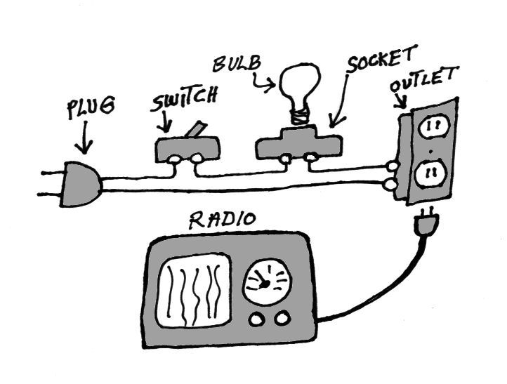

6
Marius83
If you want to stop burning and blowing components when first powered up, wire an incandescent light bulb in series before the amplifier.
If there is a short, or shorts, as is evident, then the bulb will light up and consume the power rather than your components. If no short, the bulb will not light up. Try 100 watt to begin with
