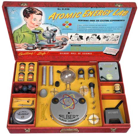

jpanhalt
Joined Jan 18, 2008
11,087
Is the stuff in the kit depleted?
Probably not. That kit looks like it is from the 1950's -- last century. People in the US were not nearly as sensitive to radiation hazards then as we are now. It was even used to treat acne (egads!) and most shoe stores had fluoroscopes so you could see how new shoes fit. Kids will be kids. My brother and I played with them, like making shadow figures on the wall with our hands. Atomic bomb tests were announced, and we would get up early (SoCal) to see the glow from over the mountains.
John
