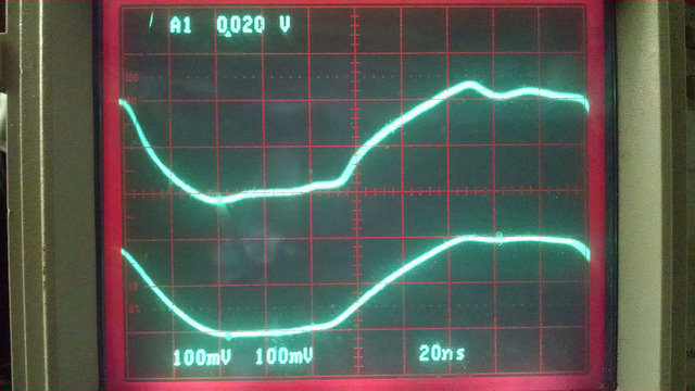

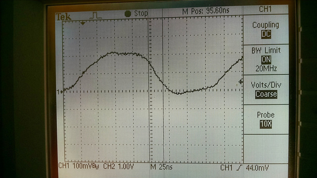

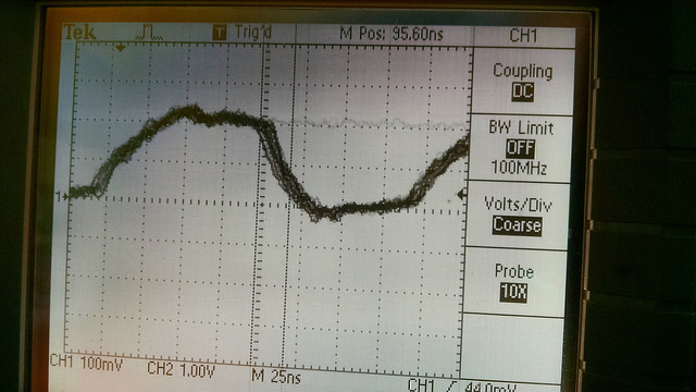

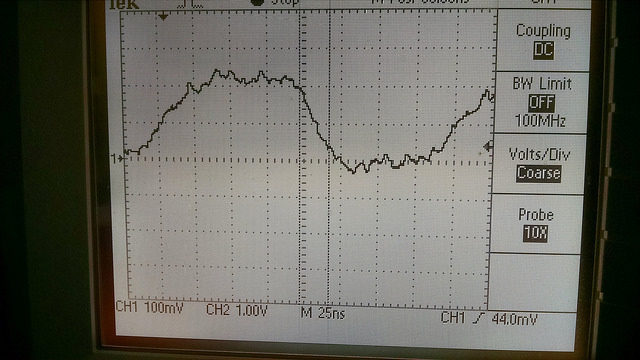

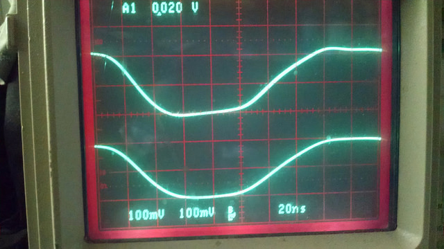

Often we are interested in rise/fall time assorted waveform for some sort of transmission effect on the signal.
The same source signal with different signal paths BW limited to 20MHz on analog scope 350 MHz (real bandwidth) 2465A
They look much the same.
Full BW
Much easier to see the difference between signals. The analog scope CRT tends to hide random noise resulting in a 'cleaner' viewing signal of repeating signal features.
The waveform intensity/Analog persistence function on a DSO does the same thing.
http://www.hit.bme.hu/~papay/edu/DSOdisp/gradient.htm
Top signal from above 20MHz BW limit on TDS 220 100MHz 1GS/s (an oldie now low-end DSO with a small sample memory)
Full B/W STOP
Full BW RUN
