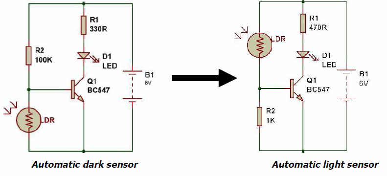

Hehh :/ I calculated that if i need 1A of current and i have for example 4.5V so the resistor would be 4,5Ohms. So i would need to add 50 resistors to each LED for circuit to work correctly..
Yeah and about the LDR circuit.. Im currently working to understand it. But i dont understand one thing.. When there is light, the resistance of the LDR will be very low and most of the current will go throught the LDR so the LED will not glow.. As the light fades, the resistance is getting higher and higher, so at some point the resistance will be high enough and the current will choose the easier way and will travel to the LED side and light the LED up. But i guess i understand the circuit wrong, because if it was like i said, the transistors would not be needed.
dl324
Joined Mar 30, 2015
18,350
There could be many issues with your circuit. For example, can the transistor you're using handle 1A. Will the saturation voltage be low enough to not affect the brightness you expect?
Exactly my point; it's clear that you don't understand what you're doing.
The LDR and resistor on the base of the NPN transistor form a voltage divider. When the voltage applied to the base of the transistor is around 0.7V, it will be on (saturated) and the LEDs will be at maximum brightness. The transistor will turn on before that and the LEDs will be dimly lit; but you're not that far yet.
When the transistor is used in it's "off" and "on" state, it it also referred to as a switch.

Ok lets give the random numbers, if the resistor is 100k Ohms and LDR is at 50k Ohms so theese 2 resistors is in the divider, and the one to LED is lets say 500Ohms. And how about the current now? What would be the whole circuit current?
Do you mean this?
The divider would try to put 1.5V on the base of the transistor, but the BE junction will limit it to 0.7V. That will saturate the transistor, so it's collector will be at approximately 0V. Assuming the LED would drop about 2V, that would put 2.5V across the 5K resistor. Since I = V/R, current would be 2.5V/5000 ohms = 0.5mA.

I wanted to ask one more question.. Is there any way to calculate the values when the voltage to the base will be 0.7 volts? Assuming that circuit will have 0,5mA current and so that LDR and 100K ohm resistor is in parralel with the battery so in both of theese should be also 4.5V. Am i right there? So how do i know with what LDR value there will be enough voltage to make the transistor working ( 0,7V)
dl324
Joined Mar 30, 2015
18,350
Why the divider will try to put 1.5V if the power supply is 4.5V? :eek:.Is that something you cant calculate you just have to know?
There's nothing mystical about it. You just use the voltage divider equation and some knowledge.
VLDR = 4.5V * RLDR / (RLDR + R1) = 1.5V
The current in the divider is ILDR = 4.5V / (RLDR + R1) = 0.03mA
(Tried using tex, but it was too finicky...)
At 20mA, the resistance of the B-E junction will be on the order of an ohm. Most of the current will go into the base of the transistor and the voltage will be limited to about 0.7V.
The resistance looking into the base of the transistor is something you learn. It's re (I pronounce it "little r e") and is about 25 ohms / Ie.
If you changed the values of the resistors so they were ohms instead of KΩ, say 1Ω and 0.5Ω; the current in the divider would be 3A. Using the same resistance for the B-E junction, 1A would go into the base; the transistor would be destroyed if it couldn't operate at that current.
The transistor will start turning on before the B-E voltage is 0.7V. That value is what the voltage will be when the transistor is completely on.
Assuming a lower, starting to turn on, B-E voltage of 0.5V, when this equation is satisfied, LEDs will start turning on:
\( \small 4.5V * \frac{R_{LDR}}{R_{LDR}+R_1} = 0.5V \)
What transistor are you using for the switch? You want one that can handle 1A and have a low saturation voltage.
Wow that some very usefull information! thanks. I understood most of it, just this part seems tricky for me. What do you exactly mean Ie? is that those 20mA?
and i didint quite catch why if we have lets say 3A in the divider, why only 1A will go into the base?
and im using BC547 transistor
dl324
Joined Mar 30, 2015
18,350
Your welcome. And if I was wrong, someone will correct it...
Mostly. The transistor has 3 currents: Ib (base), Ic (collector), and Ie (emitter). The relationship is Ie = Ib + Ic. Further, the relationship between the currents is Ic = βIb and Ie = (β+1)Ib. Transistor β is a function of transistor geometries, chemistry, collector-emitter voltage, and current; to name a few. When a transistor is operated in it's saturation mode, β is typically reduced to a tenth of it's typical value.
You use the current divider equation for parallel resistors. If you have 3A flowing through 0.5Ω||1Ω, 1/3 of the current will flow through the 1Ω and 2/3 will flow through the 0.5Ω.
