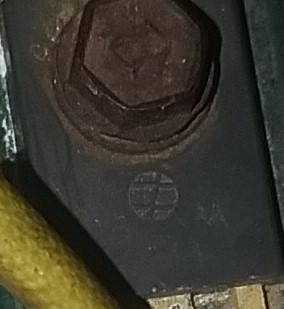

1) The video shows a little BC547 NPN transistor. It has the European small low power transistors pins layout as CBE on its datasheet . American little transistors have pins that are EBC. But the POWER Darlington transistors are completely different because their collector gets hot and is the rear metal that is bolted to a heatsink and is also the middle pin.
2) We don't call the positive supply wire "hot".
3) What is the part number of the NPN darlington transistors that you sketch with an antique case? They might be European with a different than American pins layout. Oriental transistors use another pins layout. Motorola used to use that old case and I found this one but its max current is too low:
I don't think this is the case, If so the 12VDC would not be going to the middle pin.
I do think now it's a NPN. What I said about having NO electrical experience might be a little wrong. I have done wiring in my time, relays , timers, control panels....etc. But it's mostly been AC. I've done programming and just plan 110AC, 220VAC and 440VAC when I would install the machines the company built. But no electronic board design. I have known for many years what capacitors, diodes and resistors are but never took the time to know how they worked. I would have a schematic and would just wire it to what it said to.
I don't know "yet". The numbers are worn off of it and I'm having to do some more reading on it to find the one that will work. I will try to reframe from using the word research from now on. And I will not use "hot" anymore. I get that someone looking on here would say that's wrong.
If your referring to my drawing and the font, we don't call them sketches and it's from my reference drawings. it's and old design practice used to keep you from going back and forth incase you forgot a measurement. and the font is autocad standard. See I'm an old man but, this dog is just trying to learn a new trick. My "sketch" should have looked like this:
to be correct.

Digikey is great. talk to rep there and he's helping out a bunch. Got another question in a pic I took with my phone I could make out an big M on the transistor. Does this stand for Motorola?
