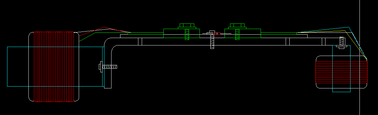

THANK YOU! I had to remove it from the board and thought it was a three wire transformer, come to find out it had four. Still don't know what the output is?

Most transformers have four wires, two for the primary winding (input from the amplifier) and the other two for the secondary (output) winding.
I found the patent of the Tenna Mindblower speaker and it shows a 5 wires input transformer with its center-tapped secondary feeding two darlington emitter-followers which drive the 4 ohms center-tapped speaker. So it has a custom-made transformer and custom made speaker.

The transformer 48 on the patent has 2 wires on its input (right side) and 3 wires on its output (left side) that feeds the Darlington transistors. Then it has 5 wires. The custom-made speaker 41 has 3 wires.

I know our problem now you pulled up a spec from the old design. Now there are two transformers on them.
one for changing it from a three wire speaker to a two wire speaker and the other I don't really know what it does, But it's bigger fits on the opposite side and hooks between the transistors and a few other things.

I have not found a schematic of the MindBlower speaker with the new design that added an ouput transformer to convert the custom 3 wires speaker so an ordinary common 2 wires speaker can be used. This transformer is not common today and also must be custom designed and made. You can decide to use an expensive design with good deep bass and sizzling highs or a cheap design that sounds like a cheap little old AM radio.
You cannot simply use Google to find a suitable 5-wires transformer and 3-wires to two-wires converter transformer. There are no such things available today, these things are 40 years old. They must be designed properly to match the Darlington transistors and the raw speakers including all the audio spec's you want.

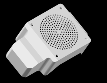

the designs and layouts. They got so hot you couldn't touch them and often blew fuses and I wondered why they done that sooo, I designed a cover that incorporate a computer fan to keep them cool. Now I don't know if they will get so hot that it will destroy the fan but that's what research and development are all about right? So give me an opinion on it, what do you think?
