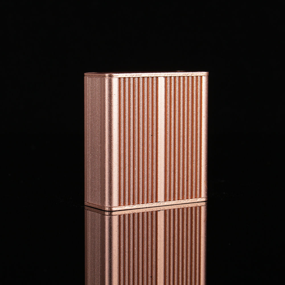

Found this on ebay.....
Aluminum Circuit Box. 45x45x19mm
IP5x

You don't need an enclosure if you pot it. The motorcycle environment is harsher than the interior of a car or even under the hood, So, the IP rating is a classification system. Note that there may be a NEMA equlivelent enclosure type.
Your worst enemy is probably salt spray depending on where you live, Salt used to de-ice roads could cause corrosion.
There is also a PCB conformal coating that you can spray on too. See https://en.wikipedia.org/wiki/Conformal_coating

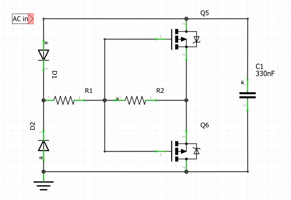

Am I understanding the MOSFET connections and capacitor orientation?
(The image has been corrected and re-uploaded)
Alec_t
Joined Sep 17, 2013
15,158
The two FET sources connect together. The two FET drains connect to the cap. The capacitor should be non-polarised, so can be connected either way round.

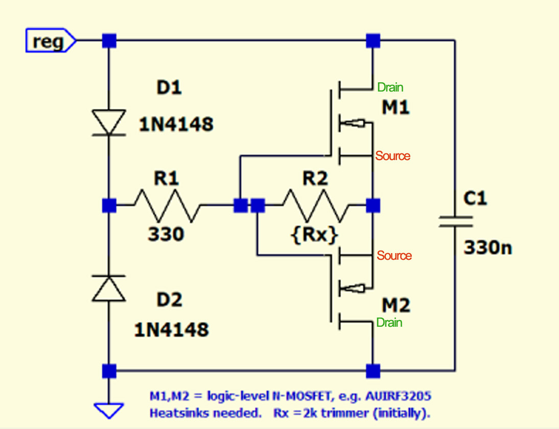

Here is the (hopefully) final schematic I will use. 2 things.....
1). Alec-t, do you or does anyone see any issues with this schematic?
2). If I was making a PCB for this, which trace segments might need to be wider for carrying more current?
3). If I put this in an aluminum box with the MOSFETS heatsinks attached to the aluminum box, would the aluminum box become electrically active (for example, would the box need to be protected from touching the motorcycle's frame?
Alec_t
Joined Sep 17, 2013
15,158
1) No.
2) Personally I wouldn't use a pcb, but if you do, it's the yellow bits that carry heavy current:
3) Not if you use the recommended insulating kits for mounting the FETs.
Lumenosity
Joined Mar 1, 2017
614
I read they were "better" ? Does that change the functionality ?
Is the circuit as designed good to go?
Or are N channel Mosfets a requirement?

The shunt type regulator circuit that you showed replaces the high current zener diode that used to be on some motorcycles. To use polite terms, the whole concept was REALLY DUMB!! The cheap and reliable replacement that allowed charging the battery and not burning out the lights when the biker reved the engine and the zener diode failed was to put in a rectifier and a series regulator circuit. A power-tab three-terminal voltage regulator with two 15 amp, 100 volt, PNP transistors "wrapped around" it and a decent heat sink and the regulator will last forever if built well. Total parts cost of about $10, so it was cheaper as well.
For a six volt circuit with a six volt battery and lights, you will need to use a six volt power-tab regulator IC.
Having a series voltage regulator does demand changing the wiring harness a bit but the benefit is easily worth the effort.
