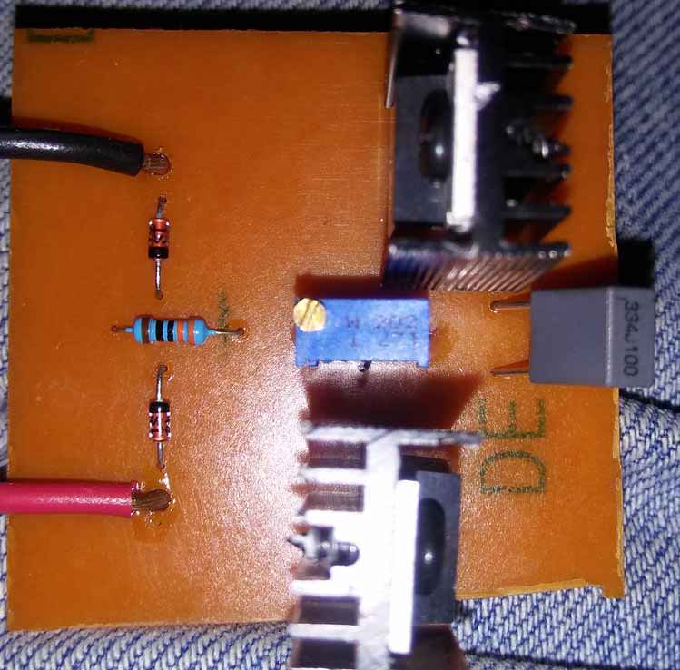

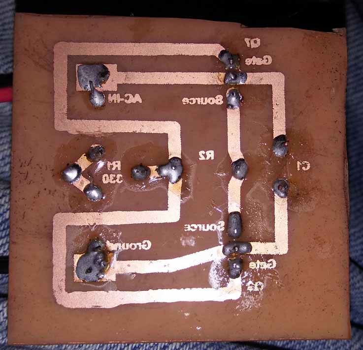

Here's a simple circuit I designed a year or two back for a biker. He reported it worked for him.
It's a shunt regulator which clamps the AC voltage when its amplitude tries to go above a set level. R1 and R2 set the level. I suggest using a trimpot initially to adjust the level to what you want, then measuring the pot resistance and replacing the pot with a fixed resistor. Depending on the Vgs(thr) threshold voltage of the particular FETS, you may need to tweak R1. Ideally the FETs should be from the same batch. They should be a 'logic-level' type.
Current flows through the body diodes of the FETs and the FETS will get hot, so require a good heatsink. Choose beefy FETs and use insulated mounts for them so that the heatsink(s) can be thermally coupled to the bike chassis to take heat away.

rudio
Joined Jul 10, 2016
4
It's to suppress voltage spikes if the regulator load is inductive. Yes, I've simulated with and without C1.
