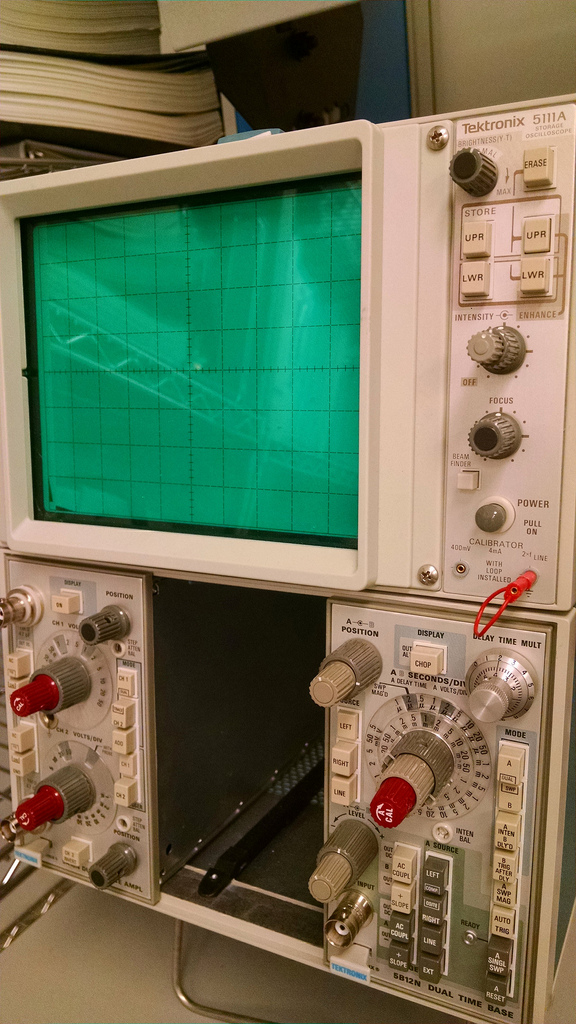

Found a classic while checking the old scope inventory.
http://w140.com/tek_5111a_r5111a.pdf
Somewhere, I think, I have two scopes. My very first, a 2Mhz Leader I got in the 80s, which was fantastic for audio work compared to nothing at all, and I was tickled to have an oscilloscope. My fiends and colleagues in the recording studio business considered such things as on par with rocket science. It saw a lot of use in troubleshooting and cemented my high-nerd status.
The other I saved from the scrap pile at work. It is a Tektronix analog storage scope. Massive with tiny screen but oh it's from the vintage of the Leader, and so it makes me imagine if I'd had that back then. Also, storage tube, baby![/QUOTE]
