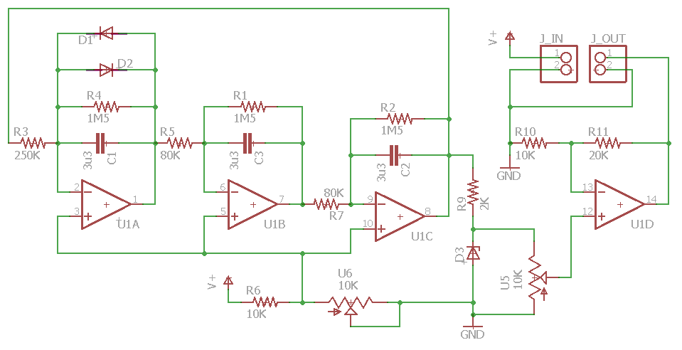

Which circuit did you choose to go with? The one suggested in post #34? Attached is a quick work-up for you that you could send to OSH Park for fabrication. They do multiples of 3 of your board (minimum order is 3), but they're really cheap; this board is coming in at $14.15 (for the order of 3)... order 3x the parts, and you have two backup boards!
Ironically, AAC doesn't allow .brd attachments -- just remove the .txt extension.
It's probably not the greatest, but it should do the trick (and I'm posting it here in hopes that @crutschow and others can vet it), and might save you some work :)
Here's a parts list for it from Mouser: http://www.mouser.com/ProjectManager/ProjectDetail.aspx?AccessID=238521fb7d
Right now the design uses trimmer pots which give you great precision at 20 turns, but they're kinda pricey. If you find some acceptable board-mount pots that are considerably cheaper, it should be trivial to tweak the design. The current pricing is ~$24 for components to populate three boards.
J_IN is for your supply connection (15VDC according to crutschow's schematic), and J_OUT is your signal (and ground) output connection.
Below is the schematic, to confirm that I didn't omit or mis-wire anything, as well as the top and bottom mockups of the board as OSH Park sees them.
P.S.: Please IM me directly if you need it modified or have any questions... otherwise I may miss your reply :eek:

DJ, that's a neat layout. Unfortunately the modified schematic I posted in post #37 is preferred, which uses a TL431a with an added pot for adjustment of the clip level, in place of the fixed zener.
Interestingly, the TL431a is actually about the same price as the zener.
If Harvey wants to go with your board, could you modify it to include that?
Thanks,
Zapper
Edit: I don't see power and ground on the schematic for the op amp, and I don't see any ground connections to the ground plane on the board (I expected to see thermal relief pads to the ground plane. Did I just miss seeing them?).
I should be able to work that up if I have time tonight :)
Ground is tied via thermals (ground plane is on the top because there are a couple of places where the traces run within the isolation tolerances of the polgygon that the ground plane would start to look more like a jigsaw puzzle)... the thermals are hard to see because of the solder mask layer.
Remember on the board bottom image the pinout is flipped, so pin 4 (+V) is in the right column of the DIP pins. It's got a trace running directly to J_IN (which also squeaks between pins 2 & 3 to go to the resistor for the Vref used in the amps). Eagle CAD has basically a "hidden" connection to the +V and -V nets from most IC parts, so there's nothing in the schematic that shows the power connection, it's just implied.

Even if you use the PCB, I would recommend breadboarding the circuit first, since all I've done is a simulation of the circuit, which is not an absolute guarantee that it will work in practice.
You could do that fairly simply without any soldering, using the plug-in type breadboard I referenced in post #42.
Doktor, there's one thing I forgot to include on the schematic and that's a decoupling cap.
Please add a 0.1μF ceramic cap directly between pins 4 and 11 on U1 when you redo the board.

@crutschow:
Will putting the decoupling capacitor next to pin 4 on the IC socket (parallel to it, with the other lead in the ground plane) be sufficient?
Do you think a larger electrolytic (maybe 10uF-47uF) next to the input (J_IN) would be a good addition too? The circuit strikes me as potentially susceptible to noisy power since the reference voltage is based off a voltage divider.
Your thoughts?
crutschow
Joined Mar 14, 2008
38,945
Your thoughts?
Yes to the first.
Adding the electrolytic next to the power input is also a good idea.
Now that you mention the reference voltage, let's go whole hog and also add a 0.1μF cap from the junction of R6-U6 to ground. :D

Updated board... finished it up on the train today. I used an inline layout for the TL431a so you can pop in a 3x1 socket rather than soldering the regulator directly. I also added silkscreen labels on the trim pots for clarity, as well as a values list on the back of the board for reference if something ever lets out its smoke.
I will hopefully be able to update the cart @ Mouser tonight to include the new components.
Top of board:
Bottom of board:
To help visualize the grounding and connections, here are the top/bottom copper layers:
BOARD (.brd file): https://drive.google.com/open?id=0BzoF3M9qOL2ZNkQ2SGdFd3dWdmc

On the board file itself I corrected an errant trace that was out of position from moving components around on the board (you can see it most clearly in the bottom copper layer, toward the upper left). It's not going to break anything, but I'm a bit OCD about the layout, heh.
Also, if/when you get this made, be aware that the hole next to R9 is a just a cheater via, and shouldn't have anything in it. R9 had to connect to U1 pin 8 and C2, and I didn't want to have any traces wrapping around the outsides of J_IN or J_OUT, so I ran a short top trace to jump over. I also didn't want to nearly cut the ground plane in half, so I used the via to drop back to the bottom layer as soon as I got over the obstructing trace.
