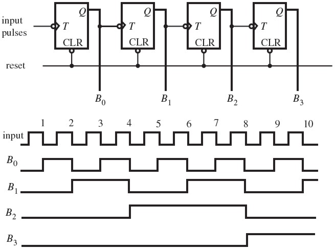

How the CD4060 counts in binary digits
n My understanding of the 4060 oscillator is that, by adjusting the resistor and the capacitor, I am controlling the time over which each output pin goes high. There are 14 output pins, labelled Q4 to Q14, and Q12 to Q14. These represent place makers in the binary counting system. Conceptually the Q pins correspond to ten places in the following string of 14 places: |0|0|0|0|0|0|0|0|0|0|0|0|0|0|. Each of the 14 binary place markers can be unity or zero. The meaning and significance of each place is relative to the first place marker on the extreme right hand side. The first in the series of place-holders counts the 2s. Each place to the left of the last represents twice the value of the last in base ten. So the location of each 1 or 0 in this 14 character string determines its binary position and its corresponding base ten value eg |1|0|0|0|0|0|0|0|0|0|0|0|0|0| shows 1 in the 14th place from the right. The 14th binary holder represents 16,384 in base ten counting since Power(2,14) is 16,384.
n Q4 corresponds to the place-holder for the 16s. And Q14, as shown immediately above, corresponds to the place for the 16,384s. It follows that if Q4 flips at, say t = 30 secs, then Q14 flips at t = 1,024 times later or at t = 30,720 secs (or after 512 mins). This is because 16,384/16 = 1024. And, as one more example, the Q9 output pin would have flipped at 960 secs (or 16 mins) after Q4 went high. This is because Q9 holds the binary place for the 32s in base ten counting. This means that Q9 flips 32 times later than Q4 at t= 390 seconds after Q4 (since 32*30secs = 390secs).

3. "How the CD4060 counts in binary digits" is correct. Note that not all of the 14 output stages are connected to device pins. This was a compromise in the design of the part. Given a desired maximum timing range and a limited number of output pins, which outputs will most people want most of the time? Q1, Q2, Q3, and Q11 didn't make the team.

Calculating the period of the oscillation:
Each successive pin goes high for and at the same time period after the last as the pulse generated by the oscillator moves from each output pin to the next. Each escalating pin in this sequence represents the binary count digit moving sequentially to the left from its neighbour to its right.
It is not exactly clear what you mean, so maybe no. The 4060 is not like the 4017. The outputs of a 4017 look more like a shift register than a counter. Only one output is high at any time, and the high output appears to travel along the output pins, moving one step with each input clock pulse. All high output pulses are the same width.
The 4060 is a true binary counter. Each successive output is running at 1/2 the frequency of the previous stage, but all stages are running at all times. Here is a partial timing diagram for a 4-stage counter that counts on the trailing edge of the input:

Q1
At Q1 the power spike would occur 4 times earlier than at Q4.
No, 8 times. 4-1=3, and 2^3=8.
Also, there is no "power spike". There is a signal that can source a small current in one state and sink a small current in the other state. If you are referring to when the output signal has a leading, positive-going edge, then yes, the first one after a reset happens at Q4 on the 8th cycle of Q1. Referring to the graphic in post #136, B0 and B3 also are three bits apart, and show the high-low relationships among the signals.
"Q1 represents the first binary place holder which holds the 2s."
No, it is the first binary output so it "holds" the 1s. It changes state with every 1 clock cycle. Q4 changes state with every 8 clock cycles (low for the first 8 clock cycles after Reset, then high for the next 8, then low for the next 8...).
