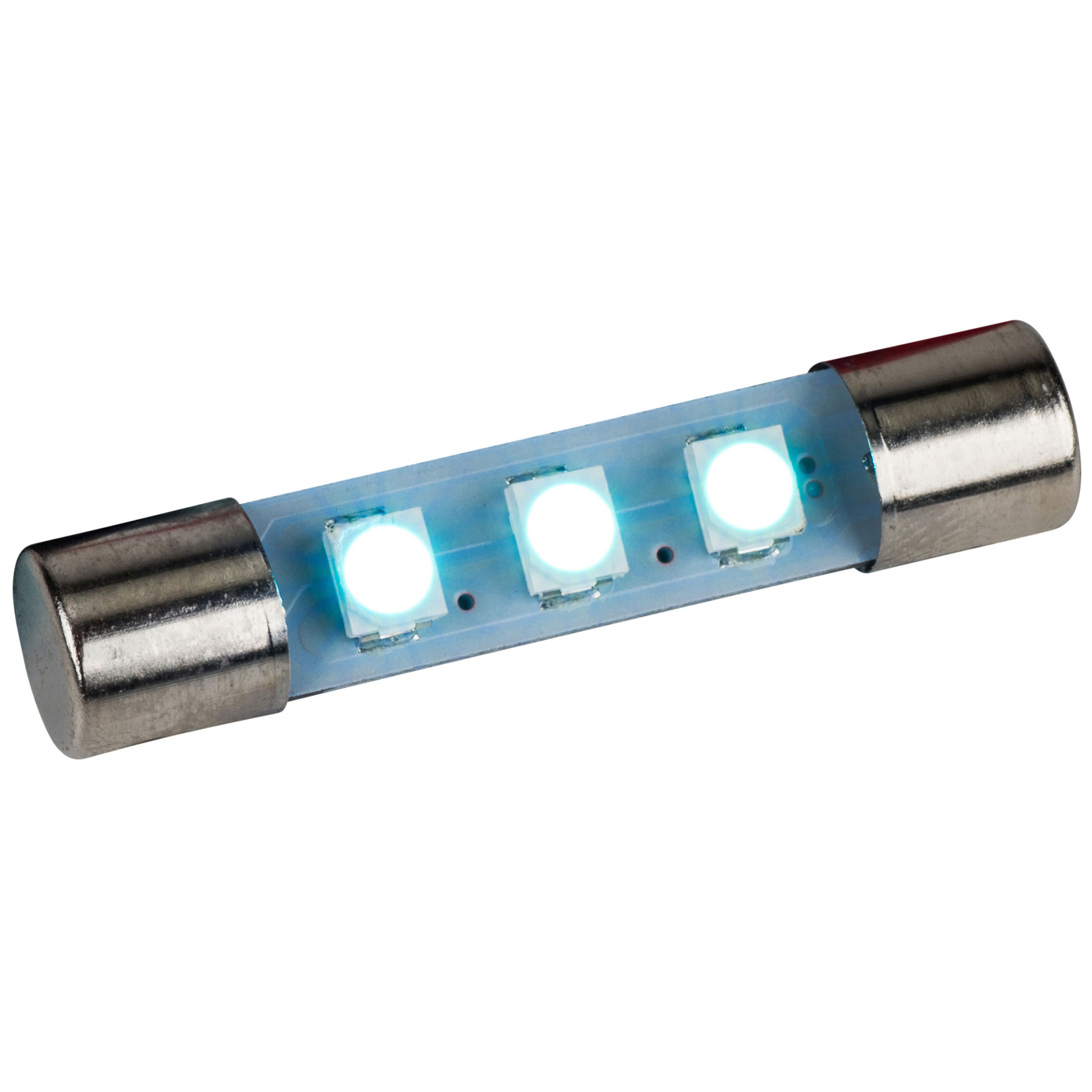

Problem solved. I found some LEDs in a fuse casing! Well, I guess I'll just have to replace them a lot. I don't see any other option (aside from proper heat sinking).;)
I'm not designing a consumer product or something where it is absolutely vital that it works flawlessly. And none of the sellers seem to list any specs other than the dimensions and the material. If it looks very similar to a well-documented item, then shouldn't it work about as well? Maybe I could look on mouser, but unless I'm getting something else from them, the shipping is a deal-breaker. But putting that aside, what do I need as a thermal resistance? Is higher or lower better, and how do I figure out an acceptable value based on dimensions and power?
