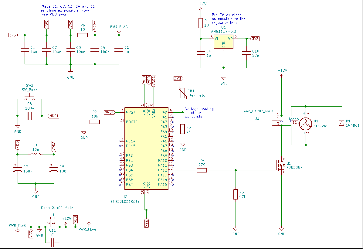

Ok, an update.
A friend of mine gave me some suggestions for improvements and this is what I have now:
There are some values, mostly the capacitors and inductor on the top of the circuit image that might need values adjustments. I need to check the datasheet of my STM32L031K6T6.

Ok, I changed the circuit above and end up with this. I still not sure about 2 connections from the datasheet and I'll try to ask about them tomorrow. For now, this is what I have:
Datasheet shows this:
Meaning 1x capacitor of 100nF between each VDD pin and VSS and 1x 10μF between VDD (again) and VSS.
What I'm not sure here is from which VDD pin this 10μF capacitor connects to VSS.
Then, the inductor part was told me by a friend of mine and I trust him. He's experienced in electronics. What I'm not sure about is if I understood 100% correct the way he told me to connect the inductor and the 2x polarized capacitors.

Ok, I may not need it unless to protect the mcu pin. But the other resistor is needed to avoid any unwanted unknown states at the mosfet gate.
This is what datasheet says about the pin currents:
Fine as drawn in last schematic above. I was referring to D1 in the schematic in #43.
Ah ok. yeah, I won't use one there for now!
I also need to fix a few more details I just figured out that are not as good as they could be in the circuit. I'll do it when I get home.
However I would like to get some more feedback about the inductor and its role, if possible.
Thanks
What else can be done to improve ? Anything else? I'm still waiting for some feedback about the inductor from my friend or from somebody else here!
Thanks
I don't want to comment on the rest of the circuit. It looks OK to me but I'm not familiar with the details of the other components. Just one minor thing - is R4 really needed? It takes some of the heat off the regulator, literally. Make sure it's rated to at least double the power you expect to be dissipated there. Otherwise it may start to look like a fuse.

There absolutely need to be bypass capacitors very close to the voltage regulator IC, and even then, you might get a serious oscillation due to R4. I experienced that early in my career, a very strong oscillation, several megahertz, caused by a resistor in that position. The bypass caps should be 0.1 mfd and within a half inch of the regulator leads.
Other than that, the one issude with the drawing is that GROUND SYMBOLS NEVER POINT UP!! I am aware that this is a picky point to some folks, but there are a few conventions that make a lot of sense to those of us who read a lot of circuit drawings.
Hello.
I will add a capacitor there and I already changed the GND symbols down. Curiously, a friend of mine told me exactly the same. heheh
I'm now waiting for the components and I'm also trying to fix a problem with my STM32CubeMX software. I installed it in the past in an external drive but now I am not using that drive anymore, so, I need to try to uninstall the remainings that I have in my main drive and reinstall the software!

This is how the circuit is now:
PsySc0rpi0n
Joined Mar 4, 2014
1,786
Now that I analyse better this image, I have a question:
What means the line the red arrow points to? At a first glance, I would say it shorts the ADC VDDA with VSSA but it makes no sense, I think. Or is it what splits the outter side and the inner side of the microcontroller?

That line represents the border of the integrated circuit device. The small squares represent the connection pins or solder pads. So that line should be a different color or texture from those lines indicating circuit conductors. JUst as in a roadmap, border lines should appear different from roadway lines and rivers.

As mentioned, the IC looks a little overkill! Probabally a 8 pin would have done it?
It appears you are using KiCad for the schematic?
If so, you will need to Flag the PWR and GND as power source if running it through the NET compiler.

The goal on using this chip is for learning purposes. I know it's overkill for the job.
Yes, I'm using KiCAD. For now, I'm just designing the circuit. I'm not very used to KiCAD nor I have done many circuits with it, so I'm not even familiar to what that means about needing to add flags of PWR an GND. If you can be more specific and detail the steps to do that, I would be glad to do it!
Edited;
Ohh, I know... I changed the circuit a bit further like this:
