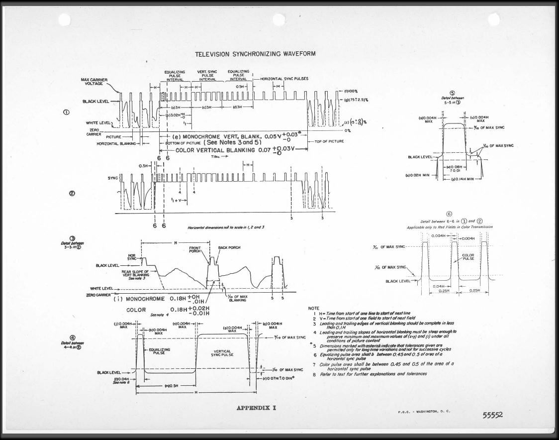

I was having look at the picture I posted earlier, and I "noticed something":
it says we need equalizing pulses because we are doing interlace, that is, the last ,line must be half its width. So we insert an equalizing pulse, which takes half a line, and sends the beam to the left. I can understand this, however, why do they go ahead and add even more equalizing pulses? Why isn't just one ok ? And they also add them after the vsyn pulses. Why would that be? It seems they add equalizers in order to add lots of hsync pulses, but there are hsync pulses at the beginning of every line anyway.

I been thinking about designing a state machine in hardware to generate these signals.
I started drawing the ASM for it.
It starts with State0, and outputs a VSYNC_START bit, then goes to State1, called SYNC_WAIT, and in this state it waits for the VSYNC to finish, then when it is done, it goes to State3 where it outputs HSYNC_START, and then waits for each HSYNC to be done, then writes the video data, and then goes back to State0.
However, the waiting states themselves will be connected to other state machines, that actually generate the signals.
Now for the VSYNC machine. It starts at State0, where it is waiting for the VSYNC_START signal. Once the VSYNC_START signal is high, then this machine displays the equalizing pulses for a few clock cycles (half a line period). Once this is done, then it outputs the Vsync pulses, and then the final equalizing pulses. Once this is done then this machine outputs VSYNC_DONE signal.
The same applies to the HSYNC state machine.
How does this sound ?

A few quick comments...
The drawing showing the diagonal lines is greatly exaggerated. The slope of the line is only from one line to the next -- about one line spacing or 1/600(?) of the height of the screen.
Even though it is US TV standard, you may want to check out Don Lancaster's TV Typewriter Cookbook. (Mentioned in previous posts.)
Also check out Appendix B A Color TV Primer for the E.E in the 1999 National Semiconductor Linear Applications handbook. The PDF is 399MB. :eek::eek: I have not managed to view the much smaller .gz version.
https://archive.org/details/NationalSemiconductor-LinearApplicationsDatabook1986OCR
There are both equalizing pulses and serration pulses. I can't remember off the top of my head which is which. One of these is used to keep the horizontal oscillator in sync during the vertical retrace. These pulses are needed even if non-interlaced video is generated.
If you leave out these horizontal "sync" pulses during the vertical interval then the image will have curved vertical lines because the horizontal oscillator will have lost lock and drifted during the vertical retrace.

The first and last images have it all inverted, why ?
In the US, the video is transmitted "upside down". This makes the sync pulses the largest amplitude and the white level the smallest amplitude. I think video is biggest since you never want to lose sync even when receiving a poor signal. Similarly, the black is bigger than white to make noise in the video less visible.
If I am remembering wrong, I am sure someone will correct me. ;)

That's not the main reason.
Interlaced scanning is used to reduce the bandwidth for a given resolution and frame rate.
Interlaced scanning means the field rate is 1/2 the frame rate (thus a 50Hz frame rate has a 25Hz field rate).
This means the interlaced transmitted information bandwidth is 1/2 that required for a non-interlaced signal with the same frame rate.
That pretty much sums it up.
There probably isn't much use for interlaced outside TV.
For the UK system; its pretty involved - the vertical sync is produced by "equalisation pulses" in the horizontal pulse train. Horizontal pulses that exceed the viewable screen have different widths - the on time is integrated to make the vertical pulses.
