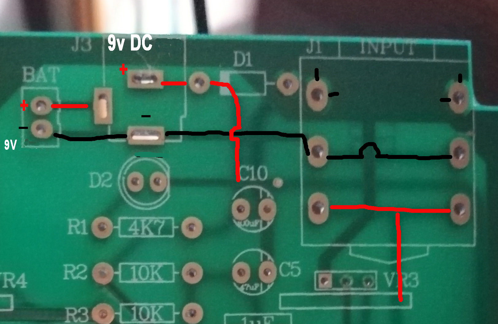

I want to draw the schematic of the Carl Martin Optocomp to be able to modify it later to make it better suit to my needs.
I managed to desolder every part successfully. I have some problems with understanding the connections here and there. Especially at the input jack and the power inputs.

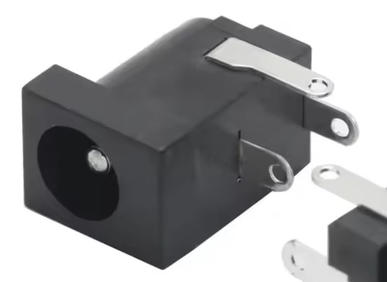

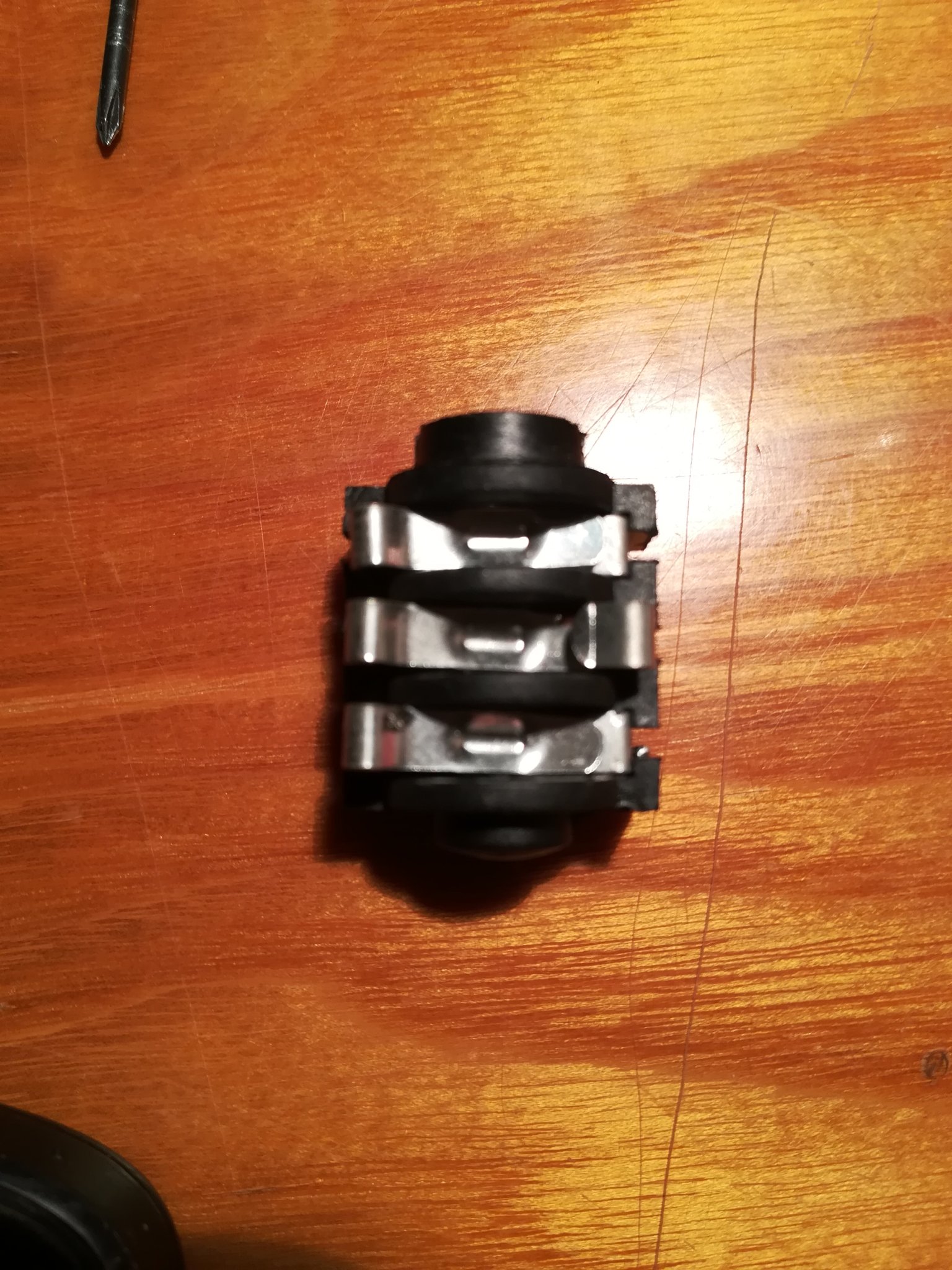

So this is how the input jack slot looks. Why is it a 3 pole jack? I don't understand that. Why not just mono? The PSU barrel plug slot is also 3 pole. Here is the photo of that too:
This is how the connections look in that input area. I don't really get what's the role of the additional +1 pole on these slots:

two of the three contacts are switch. it changes state depending on if jack is plugged in or not. this allows selecting power source (battery/psu).

Thanks, however, there is something I still don't understand. On the jack input slot you have the upper 2 legs (connected directly to ground), the middle two (that connects through the black route to the black cable of the battery), and the lower two that is the red route (signal).
But the black cable of the battery should connect to the ground rail as well. Where is that connection? Because these are all the traces I drew in that area. Based on what you wrote it is the jack plug sleeve that connects the upper and middle connection points in the jack slot right? So you plug in the jack, and that completes the flow in the black route in the circuit, so it goes like: battery black -> middle connection point in jack slot -> jack sleeve -> upper connection point in jack slot -> ground rail, right?

for any communication to take place, things need to be labeled and datasheet linked. so how about this:
see the BOTTOM of the above picture?
pin1 is crimped to the center stud.
pin2 is ring.
pin3 is normally closed contact (2-3) meant for non-rechargeable batteries. when plug is inserted, pi3 is disconnected and device is onyl powered by external power supply.
on your connector that looks like this
and usually center is positive so tour picture is probably more like this:

pin1 is crimped to the center stud. and usually center is positive.
pin2 is ring.
I think some essential info is missing: in guitar pedals the DC plug is tip negative. What you drew as red on the battery connector is actually black in reality. I know because I noted it when I desoldered the board components. So the colors go as I drew it. The black route is as you see on my image.

i said usually.... not always. i am not familiar with that product so it may as well be one where center pin is negative.
do you understand function of pin3 now?

Absolutely. May I ask that can you link or paste a photo of how you need to draw these 3 pole jack and barell plug sockets into the schematic? I want to draw these correctly but I am not familiar with how you need to draw them in this particular situation.
And how do you call these type of sockets? I guess the jack socket is simple stereo socket isn't it? With one channel used as negative source and a switch. But how do you find the barell socket that can be used like here, as a switch? Simply 3 pole DC socket?

read the datasheet. part is shown in post #4 which explicitly tells you to look at the BOTTOM of that image. there is a word SCHEMATICS and next to it is a symbol.

The 3-pole jacks are likely not accidental. Many pedals use stereo/TRS jacks for extra functions:
Input jack: The third lug is often used as a battery disconnect switch. When a plug is inserted, it disconnects the battery ground to save power. It can also be used for signal switching or grounding depending on the design.

Thanks! So when you shop for the audio socket, you simply ask for this as stereo socket? And then use one lug as the switch. Or for this purpose there are specialised sockets?
