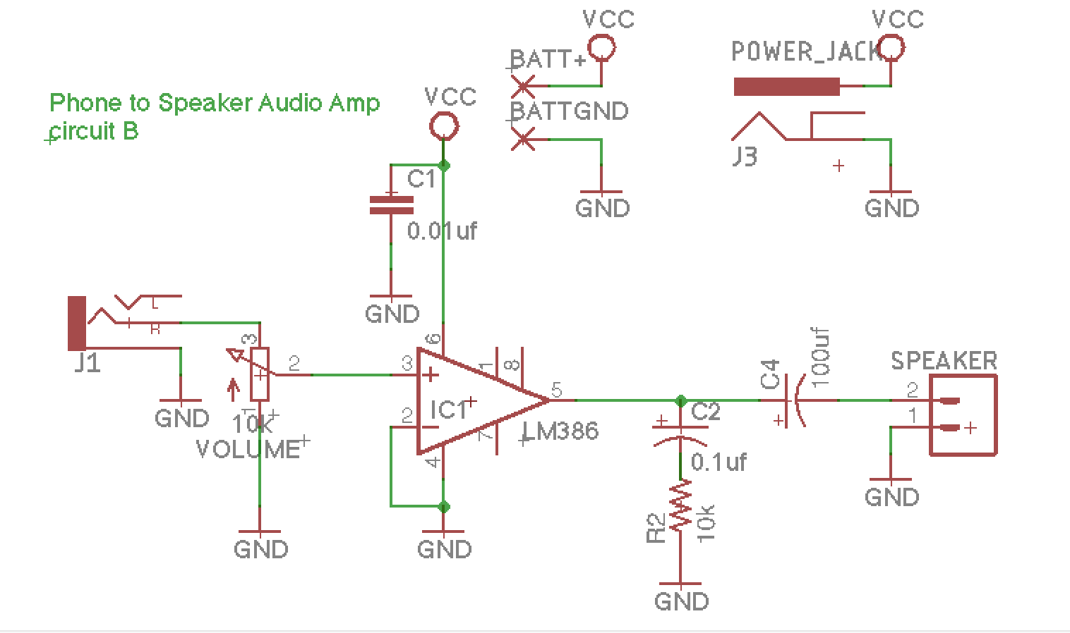

Here's my other circuit that WORKS.
From what I can tell, it is wired up basically the same, but I use different values, and I had added the VCC bypass cap without really knowing what I was doing. It's really surprising to me that this one works so differently from the first one - the values don't seem too different.
I'd appreciate any feedback on what I'm doing good / bad here - I based it off the one from Mims's book, and it seems to work ok.

An extra bypass cap of 100uF as well as the 0.01uF could be worth adding. I generally use 0.1uF caps as my standard value.

It would be good if you could post another photo, zoomed out a bit, so we could see exactly how each component is connected. The zoomed in photo makes it 'appear' that you have a wire (the black one) connected between the end of the output capacitor and ground but that may be just an illusion given by the zoomed in photo.
The schematic you have posted there is absolutely fine except for the 10K ohm resistor between pin 5 and ground. That value is way too high...it should be 10 Ohms.
Are you using the same power supply and signal source in your current layout that you used in that circuit?
I'm also assuming (as I cannot see from the photo) that you do have a volume potentiometer on the input? If not, the incoming signal from an iphone would probably be too high (as mentioned by another poster early on in this thread).
Do you mean another cap in parallel with the 0.01uf cap?
What's the reasoning behind that? When caps are parallel like that, don't they just sort of add together - wouldn't a 100uf + a 0.1uF cap be the same as a 100.1uf cap, and if so, how does that make a difference? I will try that though - thank you for the tip, just would appreciate some explanation as to why (I'm learning).
Thanks for noticing that - that is actually two wires from the speaker, one to the output cap and one to ground.
I'll try out the 10 ohm resistor instead - what kind of problems might that cause?
Yes exact same power supply and audio source.
I do NOT have an input potentiometer because I have been using the volume control on the phone - isn't that the same thing? At full blast it definitely does distort, but two clicks down seems to work just fine.

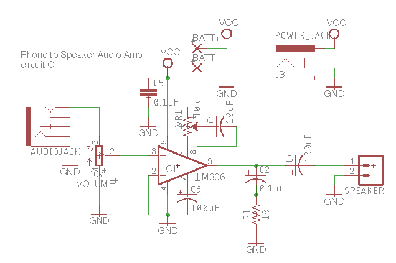

Actually, you know, your first design is almost identical to the datasheet design (apart from a wrong value on the zobel network and the value of the output capacitor) . Additionally, the datasheet assumes a clean power supply and does say "The power supply should be well regulated and the voltage must be within the specified values. It is recommended to place a capacitor to GND close to the LM386 power supply pin". Wallwarts can be noisy beasts so the power supply smoothing is important (as I say, I use a 100uf electrolytic and 0.1uf ceramic combination). This becomes less important if a battery supply is used.
As you are experimenting, it is worth trying different, higher, values of electrolytic on the output. Higher values give a less 'tinny' sound. 470uf is quite good and I quite like a 1000uf sound, on a variety of speakers I have used. It is also worth experimenting with the gain, using, as described in the datasheet, a capacitor/resistor combo between pins 1 & 8. Virtually all my designs employ a variable gain by using a potentiometer and 10uf capacitor between pins 1 & 8.

I think you are right, and that is nice to have that settled - the design from the manufacturer didn't work because I wasn't using the bypass cap.
I have added a trimpot + 10uF cap between pin 1 and 8 and it is nice having the gain - this thing gets really loud!
Now here's the good news, albeit a bit surprising considering a lot of the feedback I have received here...
I got it working VERY well - sounds good across all audible freqs and there is 0 noise anymore.
The surprising part is, the electrolytic bypass cap seems to ADD noise...if I use a 0.1uf ceramic cap, plus a 10uF cap from pin 7 to ground, things work extremely well. Once I add that electrolytic bypass cap, the noise comes back.
I have also tried different values on the output cap, and can't really hear much of a difference.
Do I have some other value off somewhere that makes that electrolytic bypass cap not work right (I've tried both 10 and 100uF)? Either way, I'm extremely happy it's working and I have learned so much just working things out piece-by-piece in this thread - I sincerely appreciate the support and insight. Here is my working circuit:
But yea...why does the electrolytic cap bring the noise back?
Thanks again all yall for your input, suggestions, and kindness to a beginner.

1) You replaced the huge inductive C2 and C4 capacitors with 0.1uF and 100uF smaller modern ones so that the inductance is less and less chance of high frequency oscillation caused by the breadboard.
2) You added a filter capacitor to pin 7 that the datasheet shows reduces a chance of high frequency oscillation picked up from the power supply. High frequencies on the power supply are common on a breadboard.
