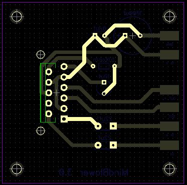

MisterBill said:
The copper ring is to locate the drill hole.
So is there something wrong in my PCB :confused:
If so I still have time to change it. I haven't talked to them since Friday and their closed over the weekend.

Had a problem in my gerber files :mad:. They said there was no drill n/c file and no top silk :eek:. I'm looking at them in the zip file I sent.
Is there a good gerber file viewer to do it outside of Diptrace ? They might not use Diptrace and their viewer could not be pulling it up correctly, I don't know :confused: I've seen gerbv, viewmate, McCad and a few others. If you had to use one or have used one let me know which one you used.
Thanks
My mistake on the top silk. In my first package I sent only the bottom silk and when I reviewed and placed the order I added it back in. I guess they got confused. It doesn't change the price so I don't see a problem.
I think it's very unlikely that they're using DipTrace to view your files, unless you're ordering PCBs through the board house that DipTrace has partnered with to allow ordering through their program. There are a few file formats that capture all the relevant data for a board (including information about parts and their orientation, pick-and-place, etc.) in a single file, but in my experience so far, Gerbers and separate drill files are still dominant. Package-specific file formats like those in Eagle, DipTrace, etc. are rarely used for manufacturing, only during the design stage.
As for viewing your files, I highly recommend previewing all of your files before sending them to anyone. So far, DipTrace hasn't done anything weird to me, but it's always a good idea to double check. It's possible to accidentally generate file sets where the drill file uses a different origin and/or scale than the board layers, so nothing lines up. Also, if you add graphics to your silkscreen layer, it may be converted to art on a Gerber layer in ways you don't expect (lumpy, low resolution, etc.) So, although you may never find a problem, I still recommend always checking with a viewer outside of whatever program you did the design work in.
As for viewer options, I switched to Viewmate (from Pentalogix) a year or so ago, and I absolutely love it! I highly recommend it. It's very powerful, and fairly intuitive and easy to work with. The free version should be all that you need, although I have been tempted a few times to upgrade to a paid version so that I could save file sets after adding markup notes, dimensions, etc. I can live without those extra features for now, but someday I may upgrade.

You asked earlier
Thanks ebeowulf and thanks for posting. Don't know how I didn't include you in my names I remembered a few posts back. I'll download viewmate this morning. I re-sent another drill file yesterday. I think my problem was I didn't hit the auto button to name and add them all. Meaning I was checking and I might have had only one that I had been clicking on and previewing selected when I hit export all. I'm not real sure what happened. I will be on this as soon as they open tomorrow. It's a5 day turn around once in queue, then two to three days to ship.
Did your board house list preferred drill formats? What kind of drill file are you sending?
From your description of the workflow, it sounds like you're describing a Gerber file with drill information on it. All the places I've seen or worked with want drill information in a separate format, either NC Drill or Excellon. The Gerber drill file is better for human viewing, but the other two drill files have all the information packaged neatly for automated manufacturing.
I'm rambling at this point, as usual. My point is just that you should double check and make sure you're sending the type of drill file they want.
I used the Diptrace Export / N/C Drill command to make the drill files. And I still think my previewing the files lead to my mistake. I went back made sure both top and bottom were highlighted and hit {auto} to label them and hit Export All generating a separate file called {Through.drl} in a DRL format and added this file to my gerber files. I hope this was right :oops:
Cool - "Export N/C Drill" should be perfect!
Did you try opening your Gerber and NC Drill files in Viewmate? That will eliminate any guesswork on whether or not you've gotten the export process right (although it certainly sounds like you've got it all sorted anyway.)

Update: My order is off hold and is being processed. Delivery date is around 5/13/2019.
So I guess I was right about what I did wrong.
I'm like a kid in a candy store, Can't wait to see what happens!
Just hope I'm not disappointed and it blows up when I hook everything up.
