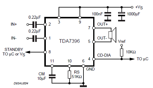

There are two areas that need protection, first, the new amplifier, and second, the source of the driving signal. One or 2 resistors can protect both.
Berzerker
Joined Jul 29, 2018
623
I'm assuming when you say "the new amplifier" That's the on I'm building and the "second" is the radio or source.
Am I correct in this?

That is exactly correct. And now that I see the circuit posted, my statement seems to have been correct about the two resistors. The big challenge would be determining the input resistance of that module. That needs to be found on the data sheet because it can be a challenge to measure.
Datasheet says 55-60kOhm input impedance.
Interestingly, it doesn't list abs max voltage or current figures for the inputs. I guess current won't be a problem with high input impedance, but it would be nice to know the voltage limits on the inputs. Maybe they think they've designed it to handle any voltage a car audio system can put out, so they're not worried about external input protection?
Not being an expert I didn't catch that on the data sheet but you gotta stop and think... It can't be able to handle amped current. If this was so you could put a 1000 watt speaker input to it. and you can kiss that 65 watt ceiling goodbye. Just think for a second and you put a radio with 100 watts a channel hooked up to it. Now your putting more in it than it's suppose to put out.
This pair (actually three) are my test speakers. If it works I can change it on the final design. I decided to build one to start with in case it didn't work then I could make changes on the other two I still have.
Right mind, wrong object blowing it
Brzrkr
I was actually reading the lack of abs. max. input ratings the other way. I think maybe they're confident that the chip already has all the input protection it needs built in.
On the other hand, since the datasheet doesn't explicitly say it has input protection, it's hard to know for sure. If I were in your shoes, I'd contact the manufacturer and ask them three questions:
1) What are the absolute maximum ratings? (may be described in terms of voltage and/or current.)
2) What protections, if any, exist on the audio input pins? (I would guess there are clamping diodes, and maybe even current limiting resistors for said diodes... If you're lucky.)
3) What external protection circuits would they recommend you add to each input pin to protect the amp, considering the possibility that it might get connected to the output of a high powered amp?
I don't think they meant for the chip to be used in this way though. Wasn't it meant to be driven from "line in" levels, not "line out"?
ebeowulf17
Joined Aug 12, 2014
3,307
I'm honestly not sure either way - I saw something in the documentation about being suitable for "boost" amps, which sounded to me like it might ok to be fed from other amps, but I'm really not sure. That's why I recommended contacting the manufacturer for clarification.

Finally got a response back from the manufacturer
thank you for contacting Arrow engineering team.
I have checked the part number: TDA7396 and it's datasheet.
as you can observe, it has short circuit dump and thermal protection as per fig.2
it has also clipping detection and for that In order to use this function, the CDDIA pin (#4) has to be resistively connected to a positive voltage reference (between 5V and Vs).
so you can use it for car radio amplifier.
for more information you can check the link
https://www.st.com/en/automotive-infotainment-and-telematics/tda7396.html
website from above said:
Key Features
  • SYNCHRONIZING PIN FOR SIMULTANEOUS TURN-ON IN MULTI-DEVICE APPLICATIONS
  • AUTOMUTE AT MINIMUM SUPPLY VOLTAGE DETECTION
  • HIGH POWER CAPABILITY:\t\t65W/2MAX\t\t60W/2EIAJ\t\t45W/2@ VS= 14.4V, f = 1KHz, d = 10%\t\t
  • MINIMUM EXTERNAL COMPONENT COUNT:\t\tNO BOOTSTRAP CAPACITORS\t\tNO BOUCHEROT CELLS\t\tINTERNALLY FIXED GAIN (26dB)\t\tNO SVR CAPACITOR\t\t
  • DIFFERENTIAL INPUTS (EITHER SINGLE ENDED OR DIFFERENTIAL INPUT SIGNALS ARE ACCEPTED)
  • AUTOMATIC MUTE DURING TURN-ON/OFF
  • NO AUDIBLE POP DURING MUTE AND STBY OPERATIONS
  • ST-BY FUNCTION (CMOS COMPATIBLE)
I did buy some step down DC converters but I did not add them in my first design. So what I get from this is placing 5v or above on pin #4 will enable the circuit protection? Is this what it's saying? I do remember once AG said you could put the 16v on it.
Brzrkr
ebeowulf17
Joined Aug 12, 2014
3,307
Brzrkr
Well, that's a disappointing response. That's some pretty vague, unclear language in my book.
We already knew it was suitable to use in car stereos - it's specifically marketed for that exact purpose! I also already knew that it has various forms of protection on the outputs - that's clearly described in the datasheet. What we needed to know was what protections, if any, it has on the inputs. As for car connections, we need to know if it can be fed from the speaker level output of another amplifier, as opposed to a line level signal.
It might be worth one more shot trying to clarify your question for them and see if you get anything more meaningful out of them. As it stands, I don't think we know anything more than we did a week ago.
