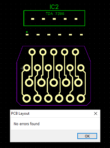

Yes I have all that. The other 11 holes are to connect wires to so I can lay the TDA7396 down flat on the heat plate. If not I would have to bend the plate down to connect it to which cost more money. It's the way I'm designing it. Trying to get by with a flat plate I guess is what I'm saying. This is a separate PCB to connect to the main PCB.
bertz said:
The TDA 7396 has 11 pins. You are showing 22 pins. What's up with those horizontal bars?
I didn't hit auto route, I done it manually. I assumed when you send your PCB to be made you didn't have the component pattern in it (?)
It's a board with holes in it right ?
ebeowulf17
Joined Aug 12, 2014
3,307
Here's better look at everything

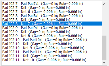

....... error list...…...
Now if I move the IC I get this
I think l see where you've gone wrong.
It looks like you designed a pattern that matches the part pins as closely as possible, then you separately put 11 holes in your PCB to match up with the pins, then you test fit by putting the pattern with pins in the same spot as the holes. Correct me if I'm wrong, of course.
What you're intended to do is design a pattern of pads/holes that represent what the part NEEDS, not what the part IS. There shouldn't be anything that looks like the rectangular pins anywhere in your files. Your pattern for TDA7396 should be the arrangement of 11 holes/pads, along with any silkscreen markings.
What you've got in the lower part of the lower image (with IC2 moved away from the 22 holes) is pretty close to what ultimately need to end up with. You've got the 22 holes you want, and you've got them connected the way you want, and you've got no errors.
The problem is that you've got IC2 floating about as its own entity, not connected to any traces. Strictly speaking, you could just delete IC2 from that layout and have the PCB file you need... but it wouldn't tie in to your schematic file in any useful way.
What you probably really need to do is:
  1. Modify your pattern for TDA7396 such that it has holes/pads instead of pins.
  2. Delete the 11 extra holes on the top half of your board layout.
  3. Connect your traces from the bottom pads to your updated TDA7396 pattern pads.

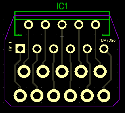

OK went back an redone it. Is this right?

Are you getting any DRC errors? If not, that's a good start.
If you drag IC1 around, do the top 11 holes move around with it? (They should!)
It looks like part of your silkscreen goes outside of your board outline. You'll either need to scoot components in, or make your outline bigger.
That's all I see for now.

No errors ebeowulf. yes if I move the IC the pattern goes with it. the DRC should tell me if there's something outside the silk screen right?
But I am still trying to tell the difference in silk screen, bottom and top layers, top and bottom masks....etc. Reading on that now.
Edit: are you talking about where it says IC1 and the end of the IC itself?

Yes, the stuff in green. I'm assuming that's on your silkscreen layer, which is the layer of stuff that will get printed on the board.
If it is silkscreen, obviously it can't go beyond (or even get too close to) the edge of the board. I don't remember if DRC checks silkscreen or not.

No that's the IC outline or what I placed in the pattern editor to identify it to me (the IC1 part). So it also will get printed on the PCB too? I'm learning but I guess I still don't have some things right. Then I will have to redo my pattern and place the green inside my board outline because I don't want the PCB to hold my IC from being bolted down. The board outline is what I need to go by to get what I want.

No way for me to tell from here. It certainly *looks* like stuff that goes on the silkscreen layer, but you've done everything yourself from scratch, and you already said earlier that you've customized the display colors, so all I can do is guess.
Is it on the silkscreen layer? Try turning your silkscreen layers on and off. Does it go away? If so, it's on your silkscreen layer. Anything on your silkscreen layer will get printed in ink onto your board, so it needs to land within your board outline.
But for all I know, you've made one of your assembly layers green, and that's what we're seeing in your screenshots. Assembly layers are for reference only, a useful way of communicating assembly notes or design intent. They don't get printed anywhere, and they don't take any physical form when the board is made, so you can put anything you want there.
