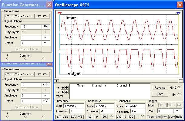

now I have changed the circuit diagram as you have suggested
according to Robert pynter in "Introductory Electronics Devices and Circuits": 4th Edition
IC U1A & U2A are non-inverting op-amp and U3A is differential Amp. [pg:712]
so I have applied different inputs on v1 and v2, so that the third IC get the different input (whereas third IC is differential amp; if same input, output will be zero)
here is function generator setting and output at oscilloscope.
one thing more that when I change Rg (resistor gain) it doesn't show any major difference in output :S
now what should I do ????
why clipping occurs in output??
if we suppose don't take the clipping still same result as input is given. why not amplification???

Follow the B input on XSC1. It has shorted/connected together R4/R5:eek: since you find a red dot at both interceptions. Also I think the B input should be grounded. The whole XSC1 setup looks strange
beenthere
Joined Apr 20, 2004
15,819
If you left the B input of the oscilloscope open, then that may be your problem. It needs to be connected to circuit ground.

Mangrio screams:
I tried your design
My output is ;
Looking at your oscilloscope, you are attempting to see a 110 mV peak signal on the 5 Volt scale. To make it confusing, you've added a negative 4 volt bias by having your offset at -0.8 (y position).
Your Oscilloscope displayed the proper output.
Had you set the scale to 50 mV/div and zero offset (y position), you would have been closer to what I displayed.
Your errors stemmed from your inexperience with using an oscilloscope or your failure to calculate the expected output for the circuit, or a combination of them both.
Screaming does not attract the attention you desired, in fact, it will be detrimental to your goals.

Ok ....
Ask yourself what am I measuring. If your measuring the input signal that is a common mode voltage of 5 V peak and the actual signal of 10 mV peak, you will not see the 10 mV signal as the 5 volt signal dominates. You will see it if the 10 mV peak was about 500 mV peak, but, your lab doesn't require that level. Your oscilloscope vertical will be at least 2 V / cm for viewing a 5 V signal. The offset is used when you want to have two different "zero reference" lines, in which case, you could view two signals each with their own vertical scales.
Attached shows the Input (Vi) which is the 10 mV 10 kHz signal riding on the 5 V 1 kHz signal. Note you do not see the 10 mV signal. The zero reference is two cm above centerline and the scale is 5V/div.
The output signal (Vo) is the 10 kHz signal. The zero reference is two cm below the centerline and the vertical scale is 100 mV/cm. If you look closely, there is a slight bias as the signal does not appear equally above and below the zero reference, however, the signal is approximately 210 - 215 mV peak to peak or 107 mV peak. That agrees somewhat with the x11 gain you (10 mv * 11 = 110 mV), but remember the LM324 doesn't perform as well at higher frequencies.
You must adjust the scales according to what you are expecting. That is why you don't see some signals (straight up and down lines) as you are overdriving the o'scope's display. I've done measurements like that, but, I was looking for "slight" deviations in the nanosecond region.
If your going to add multiple scope readings from various points in your diagram, it would be best to remove the oscilloscope from your report and just title each display independently.
