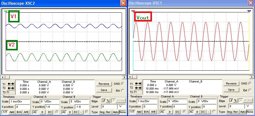

Mangrio
Joined Nov 4, 2009
20
Thankx to all of you for helping....
unfortunatily its time to submit my assingment... so i have done it with 741 and also made on veroboard to give final shape.
Thakx again all of you specially joeJester.
I HAVE MADE THIS DESIGN WITH ALL OP-AMP ON +12 VOLT D.C. WRT GND. V1 IS VARIABLE FROM 0-100 mili volt wrt to V2.
BUT I AM NOT GETTING RESULT.
PL. ADVISE.
