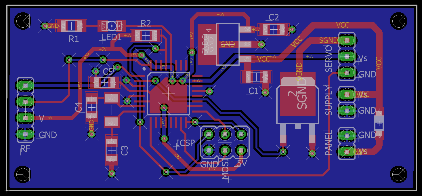

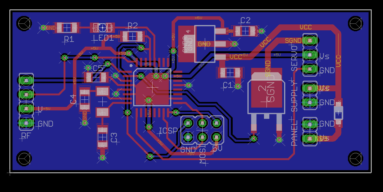

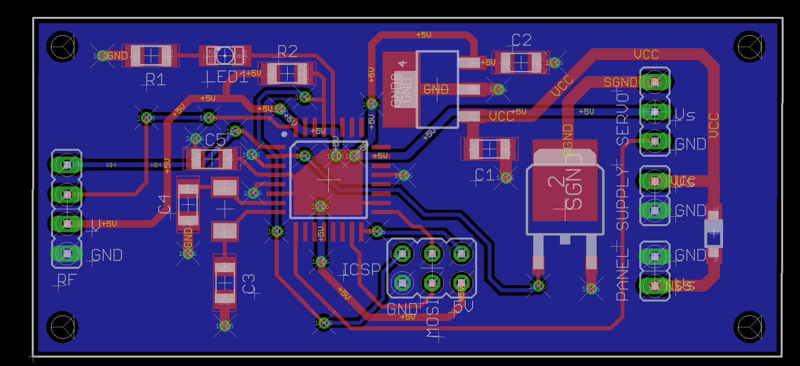

Hello,
As said, the middle pin of the LM2937 is connected to the tab and should be treated as ground connection.
This goes for all the available packages:
Bertus
SLK001
Joined Nov 29, 2011
1,549
There's another place where thermals can be set. Highlight the ground plane on the back and select PROPERTIES in the pop-up menu. Unclick THERMALS, then rerun RATSNEST.
kyleh04
Joined Jun 18, 2017
54
Yeah, i'm confused.. I did that, even grouped all and change thermals off. Nothing is any different. What is supposed to happen?
EDIT: Oh, now I see. It removed the cross from the GND via's. So what is the advantage of that?

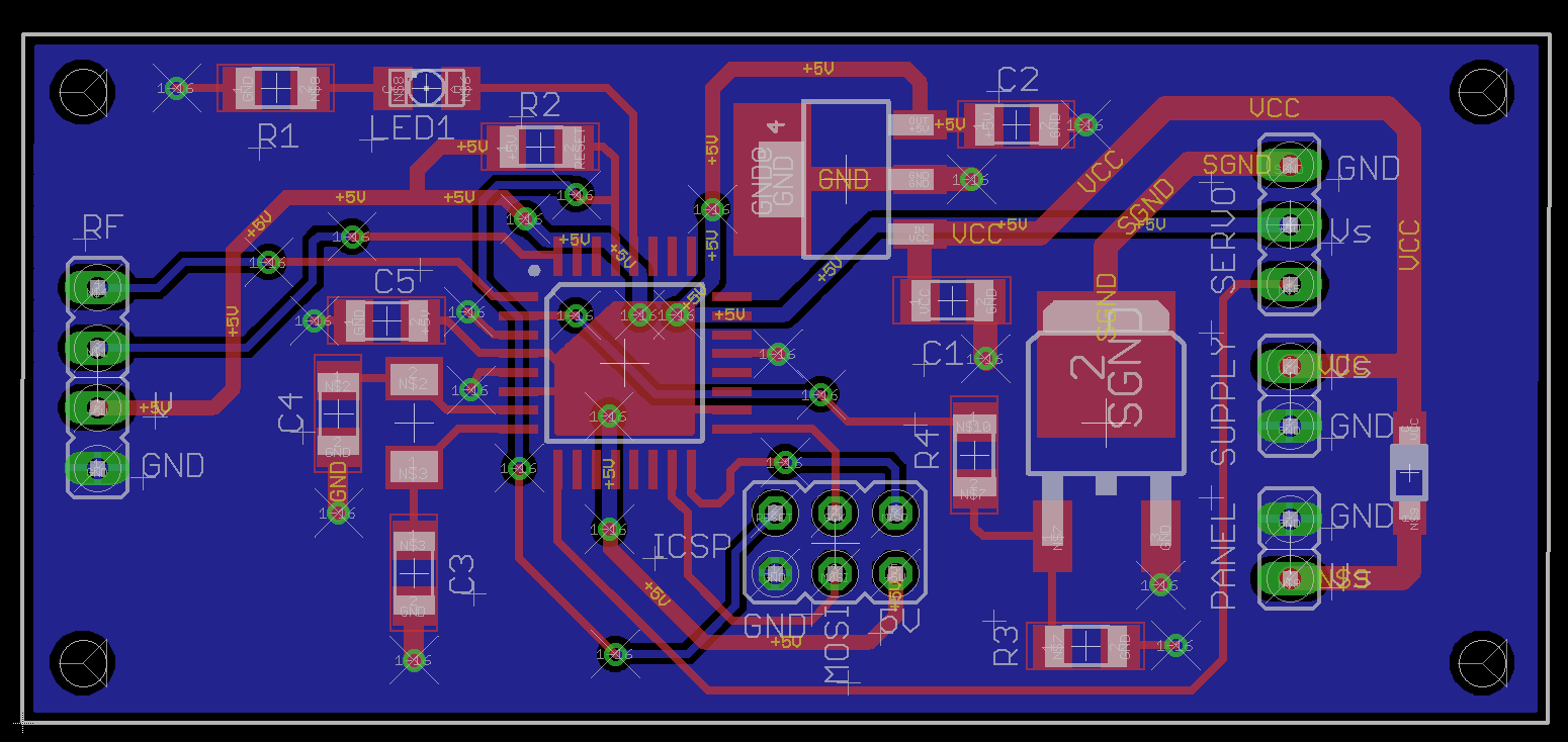

Thanks for all the help again. Made a couple changes, added a pull down and limiting resistor. Also double checked pin/pad sizes on all the datasheets. I'm going to send it off to get made if nobody else see's any issues:

Hey guys, just wanted to give a quick update. I had the boards fabricated by oshpark last week and I hand soldered the components myself. Every board works perfectly, with zero issues.
Thank you all so much for the help and guidance!
SLK001
Joined Nov 29, 2011
1,549
I'm glad that everything worked out for you. There are what I would call mistakes on your board, but being that it is so simple, they will not hurt you. One mistake that I am talking about is the lack of ground flood on both sides of the PCB. This additional ground really does help suppress circuit noise and is just too easy to add to give you that extra protection. If you are doing a board with RF aboard, then it really is a neccessity.
