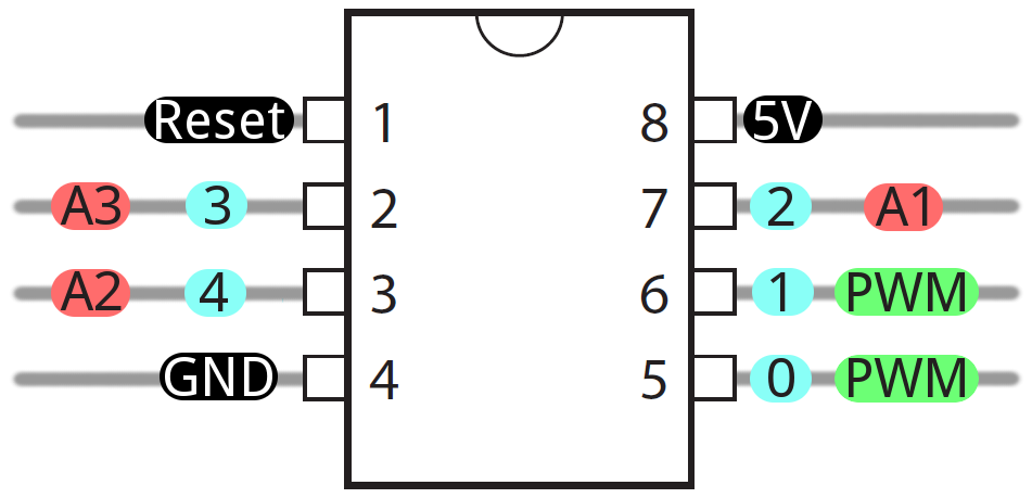

Another way of doing this with a UP but programming visually. Using
Arduino and install Ardublock. Left screen is where Arduino code
appears, basically C. Thats "normaly" how one programs Arduino.
But then right screen is a visual drag and drop functional blocks
onto canvas and config them. Then when upload button is clicked
it generate Arduino code that updates in left window, compiles,
and programs the Arduino chip/board being used.
Not too shabby. Takes a while finding appropriate block in menu until
you get used to tool. MIT Scratch, similiar tool, has lots of videos to
get a feel of how stuff is done. Ardublock has some video, but limited.
If interested I can post version of Ardublock to use and how to install.
Kids doing basic robot stuff with this. Time for the adults to catch up :)
The blocks in the rightmost window was all it took to control a PWM
duty cycle with the V user inputs to a pin, either a pot or a sensor.
Note as you work with this, and see the C code in left window, its not so petrifying
to think about tackling C for the newcomer.
Regards, Dana.
