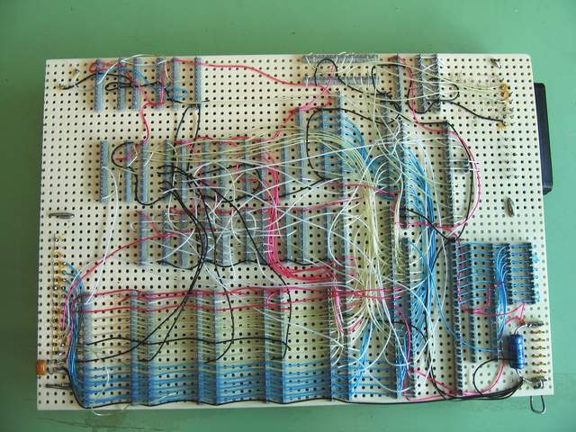

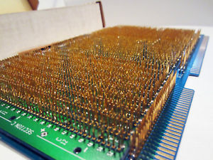

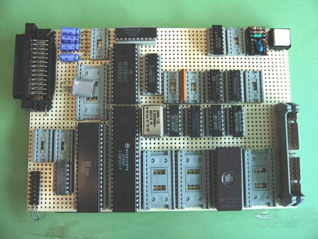

I worked on a system that had all wire wrapped magnetic core memory. I loved that system. Others used volatile memory (conventional pcb) . After a power failure I would have to reload from magnetic tape as the battery backup rarely did its job. It took 30 minutes to load the code and database. The load would often crash which required I start all over again.
With the magnetic core system all I had to do was start the code at a given address and things were up and running in minutes.
All of those systems had 2 other boards that were all wire wrapped with a couple of dozen chips. The board posted above were very similar to what I worked on with the exception they had edge connectors.

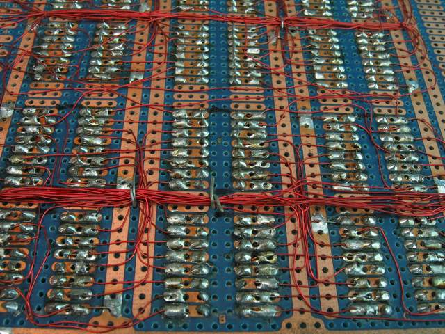

These days you have to use all the techniques together to build functional prototypes.
I end up using perf board, wire wrap, SMD Surf Boards, point-to-point, copper shielding tape, teflon tubing, bits of PCB with traces scratched in using an exacto blade ground like a laminate cutter. Here is a good example of how it all works together, combining all the techniques to quickly build functional hardware.
