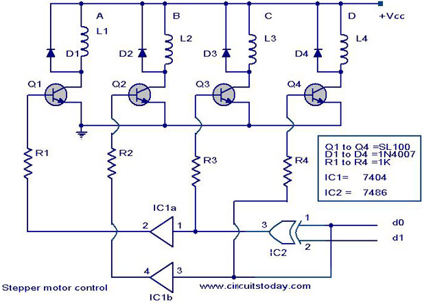

You can't change direction with the coil without reversing the poles he has to wire it up as unipolar
The way he has it shown he is just hooking all four coils to ground on one side.
Im not adding to anything the way your wiring it will not work it will only move one way.
You can wire it unipolar But you show it done wrong.
Ill draw you something up
Yes. please. I'll study whatever you draw up. Thank you.

This a quick drawing it doesn't show all the parts
but to drive with 4 fet's you have to use something like this.
This let's your coils push out and pull in without changing the battery poles
But I still say a H-bridges the way to go what's the Resistance of your coils

If the ST uses H-bridges he has 4 driving coils. If he uses what he showing in his post he has really 4 coils that can only hold the stick
There all hooked to ground on the left side as I see it.
He needs to tie them together as I show that lets you change poles from + to - by grounding one side.
Next he is using the fet's as a high side driver lot harder to do.
I would go with what I posted above.
With H-Bridges he can change the poles of all 4 coils + and - lots more power to move the shaft
plus he can move both ways the way he is going is like running a motor one way but it will move one way
Guess he want's to push it back to start after that cause it will not move back as he is trying to do.
I really don't see how anyone can't see this

The diagrams you've just posted lack proper protection for the mosfets. Especially if the load is inductive, such as yours is. Inverse parallel diodes are needed across the loads.
If you decide to go for an h-bridge, then a tvs, or back-to-back zeners must be used.

If you look at your first post your using a fet to source the 12 volts the n channel is way better at sinking your using high side.
Next it you look at my post you start from left to right
You have negative then positive then positive then negative
When you turn on first it will push to the right if your rod is positive
When you turn on the next one it pushes back left
With the right setup of your rod it will push right then be able to pull back left
With H Bridge you can just can use all 4 coils anyways you want.
There not much you can buy some on ebay for $2 each that would probably handle your new coils.
Quick clarification: those diagrams are not my project, just what popped up when I searched "High Side Driver"
