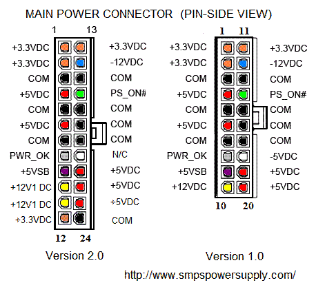

I have Chieftec GPA-400S8 400W power supply.
I tried to connect many of its wires to multimeter and turned multimeter to 20V but it always showed 0. multimeter measures batteries okay.
If i want to get 12V 6A out, what wires i should use? It has all kinds of ATX, PCI Express, SATA etc plugs. Thanks

Some PSU's does not regulate the 12V bus or stays powered ON if the 3.3V isn't loaded upto a specific value.
ErnieM
Joined Apr 24, 2011
8,415
Short pins 16 (the only green wire) to any common (black) like pin 15. This is how a PC can remotely turn these things on.

Since i connect this power supply to peltier refrig thing with two fans and it needs 12V 6A, i'm not sure do i need unusually thick wires so it can handle 12V 6A? I have things like "10253 XT60 Male w/ 12AWG Silicon Wire 10cm (5pcs/bag)" etc. Or can i just use any thin wire i have here? Thanks

You're best to join all the Yellows together, and all the Blacks together, then you can draw upto the maximum current rating on the psu.

I have soldered together PS_ON (pin 16) to COM (pin 17).
So i solder together yellow pins 10 and 11 and then all the black COMs including pin 17 which i already used? Do i solder all black wires or since there is two yellows, is two black wires enough? I have the connector on left:

I have now connected to refrig blue and all yellows.
Also since black ones are COM and blue is -12VCD, should i connect all these together??

You don't need the Blue -12V, leave it alone, just connect the Yellows together and the Blacks together, as there are only two Yellows just connect two Blacks, and use those as your fridge supply.

Thanks. So i connect just two black to refrig. But do i need to solder rest of the black ones together and leave it unconnected?

Thanks. I have now wired like that but absolutely nothing happens.
Maybe i have destroyed power supply and/or refrig. How i can test if power supply gives out 12V?
Now it shows 0.0 in multimeter when multimeter is turned to 20V DC.
