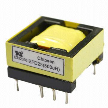

Q1=I'd like to add, how will I know what LM2576 delivers?
Q2=But how do they make them so small?, is my matchbox sized nokia charger got a transformer in it?
Q1=LM2576 will deliver 2A of current incase you draw more the voltage will drop and regulator overheat unless it has overload protection.
Q2=They have small PCB mounted transformers.
This is very small like 2x2cm.
