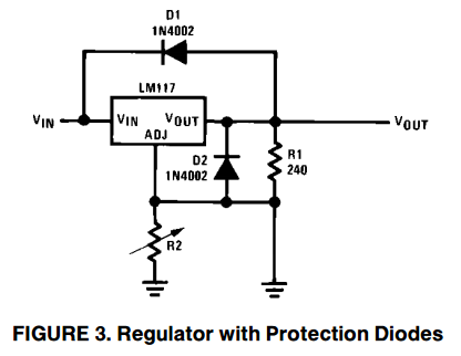

You can use trimmer pot since you are building just 5V regulator if you wanted more voltage i'd lose pot.
I thought I wanted just 5V, but now you turned me on to the *world of many voltages" :) might come in handy to change to a value closer to 10V. most LEDs at yebo are 10V, so there's atleast one reason to go for the pot solution! :)

ISB123
Joined May 21, 2014
1,236
Current usage of microcontroller is very small,its like 60 mA at 16mhz for atmega ones and its going to depend on how much stuff you have hooked up on microcontroller.
If you are controlling high power motors they need a separate supply going into the driver IC.
ISB123
Joined May 21, 2014
1,236
Pin 2 of trimmer needs to be connected to ground.You will need a 2200uf capacitor before lm350.Protection diode should be placed above the regulator.
Chillum
Joined Nov 13, 2014
546
which diode? On hand I have (but I'm anyways making a trip to yebo, so I could just buy the correct one) 1n4148,1n4007, and 5* 1n5402 (the other 2 I have 10 of each)
