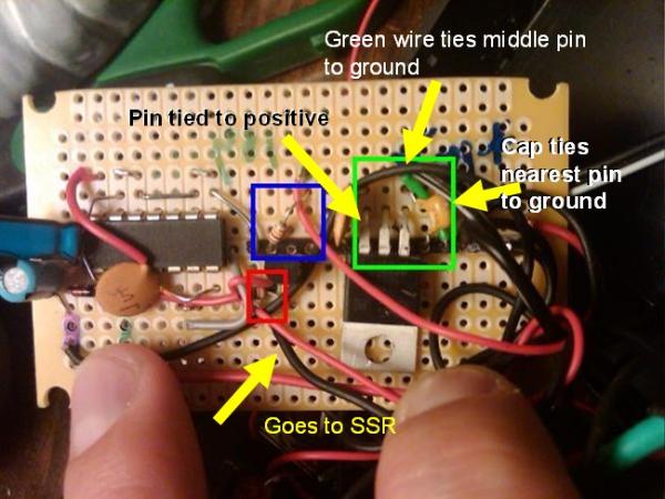

I am not sure how helpful this picture will be but here it is.
I inspected the bottom of the board to make sure there was no errant solder trails and everything looks good there. If you need a more close up pic let me know.

The questions I have for you will be inicated by the box i drew around the respective area.
In the Blue box is that R3 or R4? Also if it is R3 where is R4, or vise versa? Also if it is R3 than it should be on the same side of the switch that the Cap is on.
In the Red box it only looks like 1 wire is hooked up, is it safe to assume that is for the SSR and not the LED?
In the Green Box, I would assume the black line you drew is you negative rale, if I am right than it looks like your input is tied to ground, can't see the conection from the middle pin to ground, and you may have made the conection under the board from the output to your positive rail.
Don't know if these items I noticed will help or not but lets start there.

Ok, I'll address these by the boxes.
Blue box. I don't know what R that is. It is tying the LED to ground.
Red box. The black wire going to the SSR is marked. There is also a red wire running parallel to it in the picture that is hooked to the same pin. That wire connects to the LED. They are hooked to the left most pin of the transistor with the flat side facing away.
Green box. I think I have the green box pretty clearly marked on the picture.
Hope that clears it up. Sorry for the picture, it is a complete wiring nightmare in there.

According to your post (#57) the only LED we ended up using should be tied to positive on one end and the transistor on the other. I have it hooked to the transistor on one end and the other end is NEGATIVE! That is certainly a problem, do you think it is THE problem?
erich_7719
Joined Oct 14, 2009
92
It could be, because the led and resistor would be giving a path to ground.
Remember the LED\resistor and SSR are in parallel tied to positive and the transistor respectively.
Out of curiosity, since I don't see it, where is the resistor tying the push button cap to ground.

I also do not see the resistor going from Pin1 and the 2 diodes to ground.

Not sure how I made that error. In any event, I should have the time to correct it tomorrow. I will have to actually reverse the LED too since it does have a positive and negative side, right?
kyroguy
Joined May 12, 2010
77
What do you know? Positive and negative are apparently not interchangeable anymore. I switched the resistor and LED and it works like a charm. :D

I don't know where you are coming from, the identity of LED's were not in question here. The issue was the SSR was hooked to the transistor with the transistor as a switch and the LED/resistor was hooked to the transistor as a voltage follower, which was causing a closed circuit to the SSR when the transistor was off due to the resistor going to ground.
