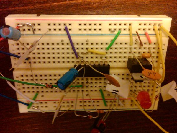

It's hard to see under the tags on the resistors. I could be wrong but it look like the ground (row 26) and the unregulated + input (row 28) are both on your ground line.
Are you getting 12V out of the regulator?
