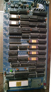

Nice board.

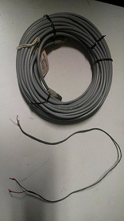

Which one looks more like your circuits transmission line.
A 100ft roll of 50 ohm coax or a 2ft wire pair?

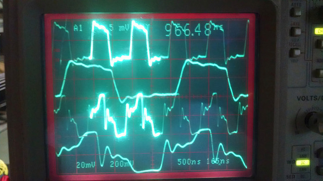

calibrator specs
0.4 V ±1% into a 1-Mohm load,
0.2 V ±1.5% into a 50 ohm load,
or 8 mA ±1.5% into a short circuit.
1 MHz signal

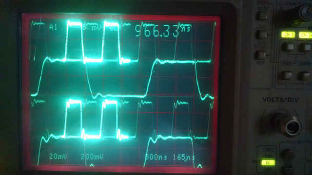

Unterminated 100ft Coax waveforms using Tek2465 probe calibrator signal. Input signal on bottom, output signal on top.
Ugly reflections back to the source due to a open circuit impedance mismatch but the far signal still looks ok.
Unterminated 2ft wire pair. Ringing (very high frequency reflections) that can be cleaned up with standard logic signal terminations if needed.

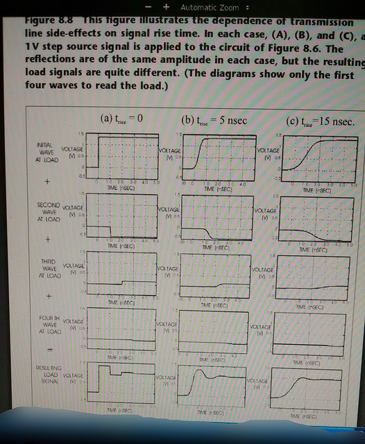

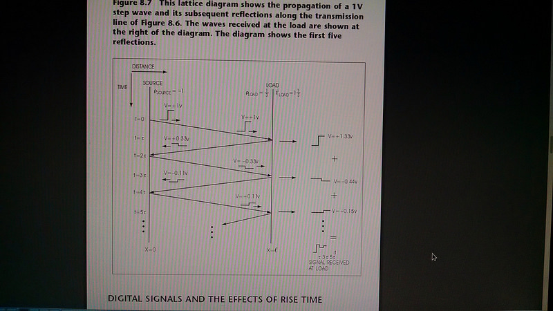

There are two equivalent ways to look at transmission lines.
1. As a distributed circuit of infinitesimal inductances and capacitances with parameters L and C
2. As a waveguide for signals with parameters v and Zo.
To the OP, keep your focus on the waveguide model (the models are interchangeable but some problems are easier with one model or the other) when you think about digital transmission line effects and reflections. One of the easiest ways to eliminate ringing/reflections is to reduce the slew rate of the output signal if you don't need the rise/fall time because of a slow(er) speed digital signal requirements like a 5MHz clock speed.
http://www.interfacebus.com/IC_Output_Slew_Rate.html

Those are some amazing and very clear and useful diagrams. Thank you very much for sharing them my friend. I will have a look at this course.
Thank you for the experiments as well.

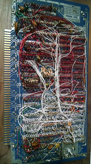

The reason I am concerned was because as you can see on my profile photo, that was a computer I built from breadboards and jumpers, and the reflections on that were a monstrosity as I didn't terminate anything. This time I will be careful but then again the wires are much smaller on the wirewrap boards.
If I were to decrease the rise times of my signals, what would be the best to do? Could I put one capacitor in each line I need to decrease the rise/fall times of? Or is there a better way? I'll look at the attached document.

Series resistors at the output of the drivers makes a defacto low-pass filter with wire to ground capacitance of the bus connections. This has the effect of decreasing the rise times of signals has it slows the rate circuit capacitance can be charged/discharged by the output drivers. As a few have said here wirewrap is old-school. Most of us have a few designs under the belt or have worked with it in the past. It's actually very forgiving at lower speed.
A wirewrap keepsake.
With TTL bypassing chips and good power decoupling is usually more important than reflections at clocked logic speeds below 10MHz with a proper vector type board.

My wirewrap board is a little different. The V and G pins are below each IC, and it's impossible to put them below the IC's like a standard board.
I therefore decided to not put one bypass below each IC because of this. Is this a problem?
There's a solution by using IC sockets to lift the IC's and so there's space, but I destroyed one board trying to solder the caps directly and it melted V into G somehow and destroyed the board.
